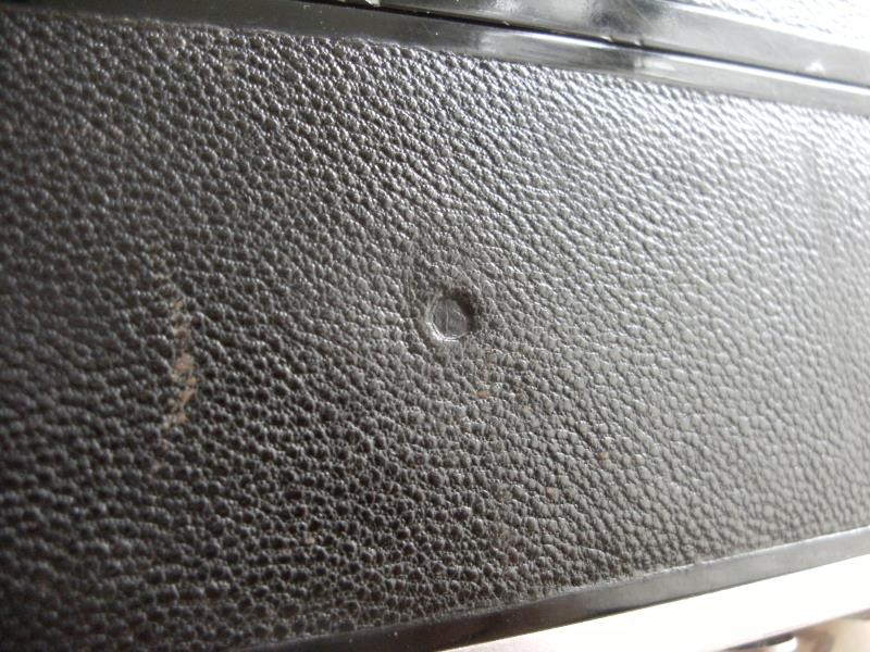

And there is a hole on the back, like on the early Feds, perhaps to regulate correctly that new range.

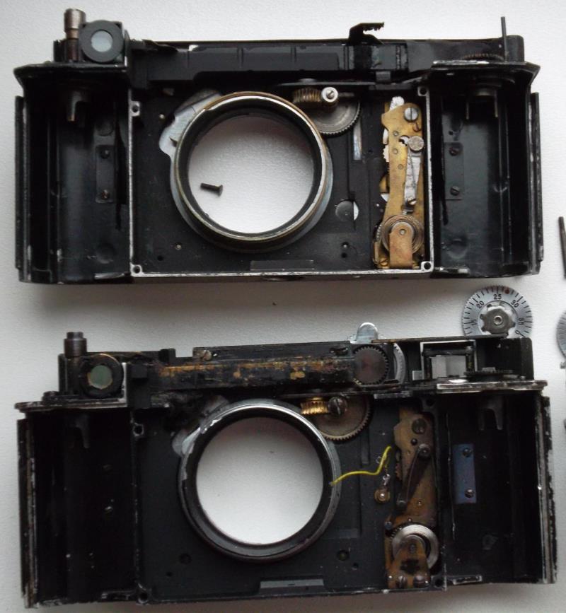

Some other interesting détails.
http://www.ussrphoto.com/resize/resize_image.aspx?ImgWd=800&IptFl=/UserContent/3042015_DSCF1873.JPG
http://www.ussrphoto.com/UserContent/3042015_DSCF1873.JPG
http://www.ussrphoto.com/resize/resize_image.aspx?ImgWd=800&IptFl=/UserContent/3042015_DSCF1913.JPG
http://www.ussrphoto.com/UserContent/3042015_DSCF1913.JPG
http://www.ussrphoto.com/resize/resize_image.aspx?ImgWd=800&IptFl=/UserContent/3042015_DSCF1958.JPG
http://www.ussrphoto.com/UserContent/3042015_DSCF1958.JPG
http://www.ussrphoto.com/resize/resize_image.aspx?ImgWd=800&IptFl=/UserContent/3042015_DSCF1951.JPG
http://www.ussrphoto.com/UserContent/3042015_DSCF1951.JPG
It seems that all is the same, and all is a bit different between this Contax and the regular ones.
Unhappily, I could not dismount completely this camera. The main screws are too tight, which let me think that this camera was probably never dismounted.
In this camera, some parts come from Dresden, some others will be made in Jena for the Contax and Kiev Jenas. And some others are unknown and were never seen before...
We think that this camera is a prototype, certainly between the last Dresden Contaxes (O series) and the first Jena Contaxes, all that leading towards our Kievs.
The possible story: after the demand of the Red Army, Jena tries to build prototypes with the minimum of blue prints. This camera could be one of these. Some blue prints are found again after, so that the regular Jena Contaxes are more similar to the Contax II than this camera.
We wait for your comments...
Of course, I have plenty of other photos if needed!

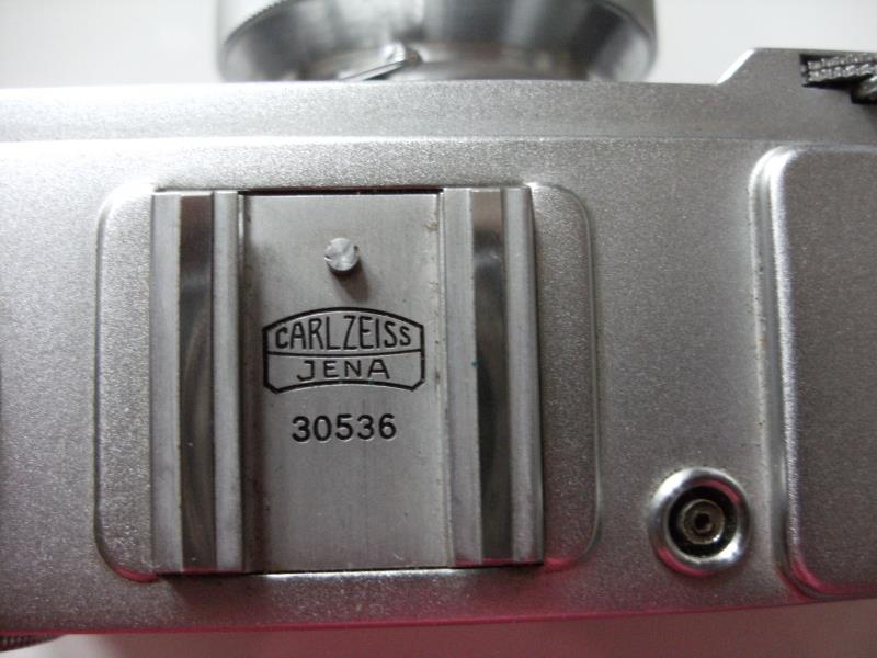

The Jena Contax s/n 30536
http://www.ussrphoto.com/resize/resize_image.aspx?ImgWd=800&IptFl=/UserContent/252015_DSCF2011.JPG
http://www.ussrphoto.com/UserContent/252015_DSCF2011.JPG
So, there is a point only on this camera, the other ones have a coma between the 1 and the 3.

That would explain too the hole in the back:
http://www.ussrphoto.com/resize/resize_image.aspx?ImgWd=800&IptFl=/UserContent/752015_DSCF1895.JPG
http://www.ussrphoto.com/UserContent/752015_DSCF1895.JPG
Amitiés. Jacques
Correction: No. The hole in the back is not in the axle of the lens...

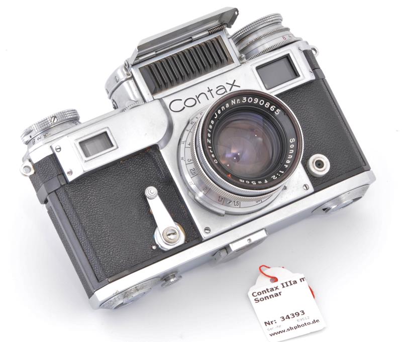

seeing carefully pictures of those contaxes I feel none of them have original flash contacts
Replied on: 20150509190131
as well as the last one of course isn't a IIIa
Replied on: 20150510053424
Probably the first official factory made, on a late Jena Contax.
http://www.ussrphoto.com/resize/resize_image.aspx?ImgWd=800&IptFl=/UserContent/1052015_Photo 143.jpg
http://www.ussrphoto.com/UserContent/1052015_Photo 143.jpg
BTW, during the partial demontage, I found a tiny black cable of c.2cm length, in the rangefinder. No doubt it was for the flash. I took it out easily: it was free (not attached to anything). That makes think of a work made by a repairman.

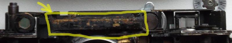

Jacques was very kind to give me the opportunity to inspect the curious Contax. The inspection is not finished yet but I would like to share some observations and findings. I use for reference Jacques Kiev 1948 and my no-number Kiev that is almost Dresden Contax.
In general the curious Contax, which i tend to call "Ur-Contax Jena", is very well made camera assembled from well manufactured details and good materials. It is definitely the creation of camera production factory. Some details were modified after the production manually for better fit of details. In general it has very high similarity with the standard Contax cameras. However some mechanisms of the shutter were redesigned or improved.
The inspection of bolts that hold the shutter assembly showed that this camera was repaired someday. I tend to believe that it was the repairman who installed the flash synchronization mechanism. Some other details also support this conclusion. The synchronization mechanism is very smart and it seems that it was designed to work with bulb flashes only.
The most striking feature of Ur-Contax is the completely different concept of rangefinder focusing from the standard one. It is of Leica type (no sliding wedges anymore!) with original coupling to the bayonet.
Here is the picture of two partly dismantled bodies of Kiev 1948 (top) and Ur-Contax (bottom).
http://www.ussrphoto.com/resize/resize_image.aspx?ImgWd=800&IptFl=/UserContent/18102015_p5.jpg
http://www.ussrphoto.com/UserContent/18102015_p5.jpg
The closer look into rangefinder mechanism. The brass tube (idicated by yellow) is hollow and was placed there in order to make the flare effects smaller. I am not sure if it was originally installed. Probably it is later modification together with synchronization
http://www.ussrphoto.com/resize/resize_image.aspx?ImgWd=800&IptFl=/UserContent/18102015_p6a.jpg
http://www.ussrphoto.com/UserContent/18102015_p6a.jpg

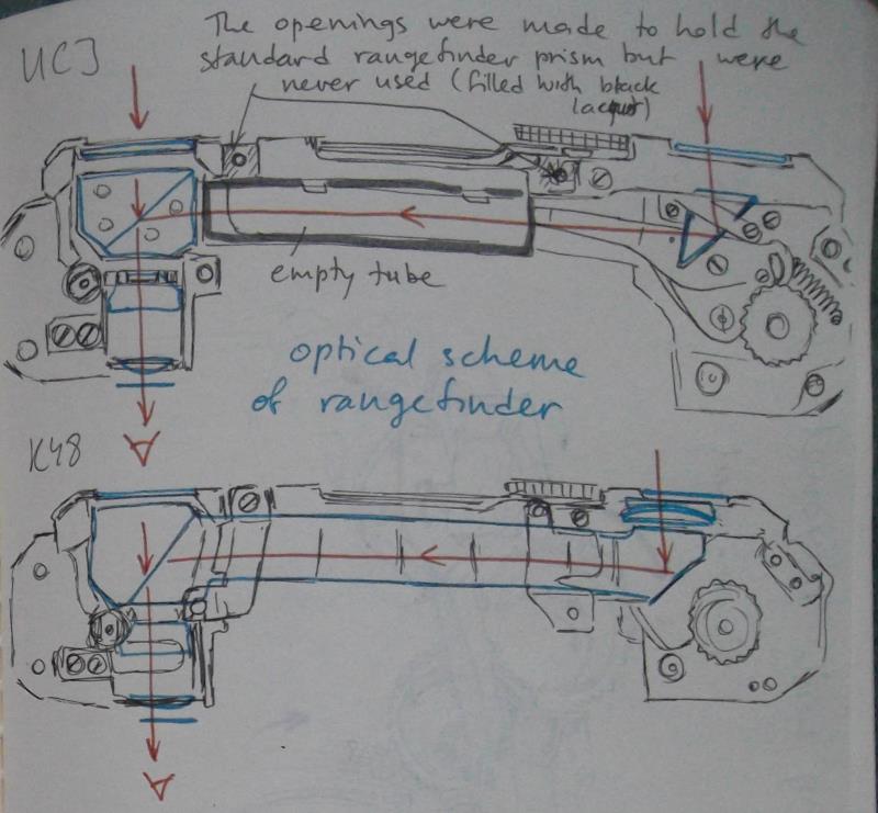

The drawing of rangefinder scheme from above for Ur-Contax (top) and Kiev 1948 (bottom)

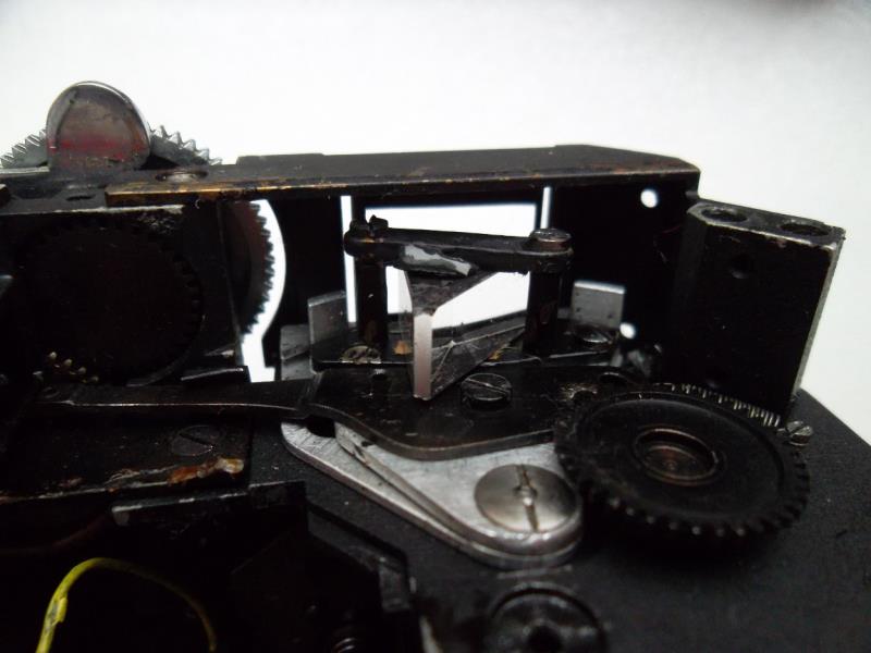

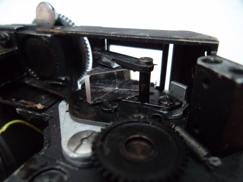

The close-up of rotating mirror
http://www.ussrphoto.com/resize/resize_image.aspx?ImgWd=800&IptFl=/UserContent/18102015_p3.jpg
http://www.ussrphoto.com/UserContent/18102015_p3.jpg
http://www.ussrphoto.com/resize/resize_image.aspx?ImgWd=800&IptFl=/UserContent/18102015_p4.jpg
http://www.ussrphoto.com/UserContent/18102015_p4.jpg

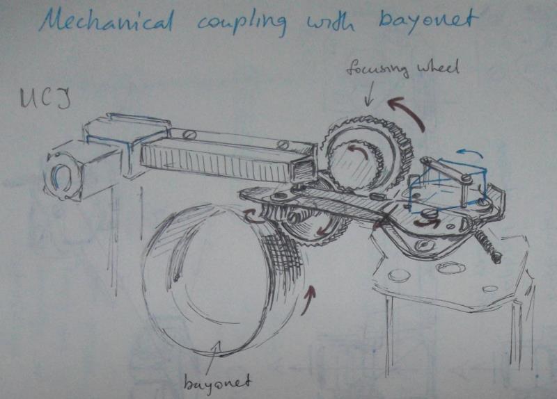

The mechanical coupling to the bayonet is similar in many respects with the standard one. The mirror rotating mechanism and its coupling to the focusing wheel differs however in many respects from the mechanism of sliding wedges.
http://www.ussrphoto.com/resize/resize_image.aspx?ImgWd=800&IptFl=/UserContent/18102015_p2.JPG
http://www.ussrphoto.com/UserContent/18102015_p2.JPG
This rangefinder was cheaper to manufacture than the standard one, however it gives poorer visibility and is less precise. I think that after trying this system on a prototype camera it was decided to equip after-war Contaxes and Kievs with the sliding wedge rangefinders.
altix
Replied on: 20151019040717
Fantastic job, Altix!
So, this camera is certainly a prototype based on the trial of a new rangefinder. I imagine the German workers, urged by the Red Army to build a new Contax range, trying different solutions to lower costs and spare time. All that before they could restore the drawings...
Certainly we will have other surprises with the mechanism and the bayonet.
Thanks, Altix, for your fine and perfectly clear drawings...

Here are some shots of shutter winding mechanism.
http://www.ussrphoto.com/resize/resize_image.aspx?ImgWd=800&IptFl=/UserContent/26102015_Shutters.jpg
http://www.ussrphoto.com/UserContent/26102015_Shutters.jpg
I also have found that the rangefinder prism was connected with the hollow tube on the factory. I just wonder why this tube is too short.
http://www.ussrphoto.com/resize/resize_image.aspx?ImgWd=800&IptFl=/UserContent/26102015_SAM_0971.JPG
http://www.ussrphoto.com/UserContent/26102015_SAM_0971.JPG
The comparison of some details of Kiev no-number, Contax and Kiev 1948
http://www.ussrphoto.com/resize/resize_image.aspx?ImgWd=800&IptFl=/UserContent/26102015_details.jpg
http://www.ussrphoto.com/UserContent/26102015_details.jpg
I would say that this Contax has 90% differences in comparison to standard model and is most probably the early prototype camera of Contax Jena. The main feature of this Contax is the Leica-type rangefinder with corresponding slight modifications of focusing system and bayonet. Other modifications are rather cosmetic ones.
