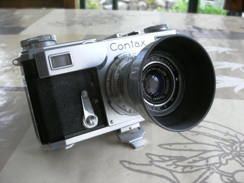

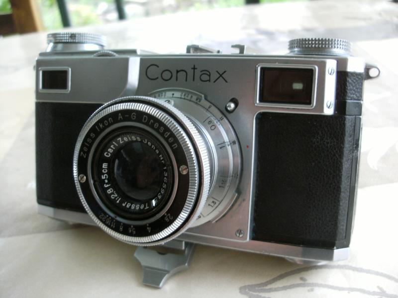

I have received lately a very curious Contax II.
It had looked strange to me by the photos of the seller. No stopper for the selftimer and square shaped accessory shoe: two unusual details. The chrome was unusually shining. No visible serial number. As for the lens: a 2,8/5cm black Tessar of 1931. So, after some mails with Altix, I bought it.
I expected to receive a camera made with mixed Dresden and Jena parts.
But in fact, it is a completely original one, with different weights. For this camera: 505g for the body only (478g for the Contax II "O series"), 144g for the back (112g only for the "O") and 175g for my Jena Contax s/n 30xxx. But the back of the Jena Conatx is made of brass.
And if I try to inverse the backs, it's impossible...

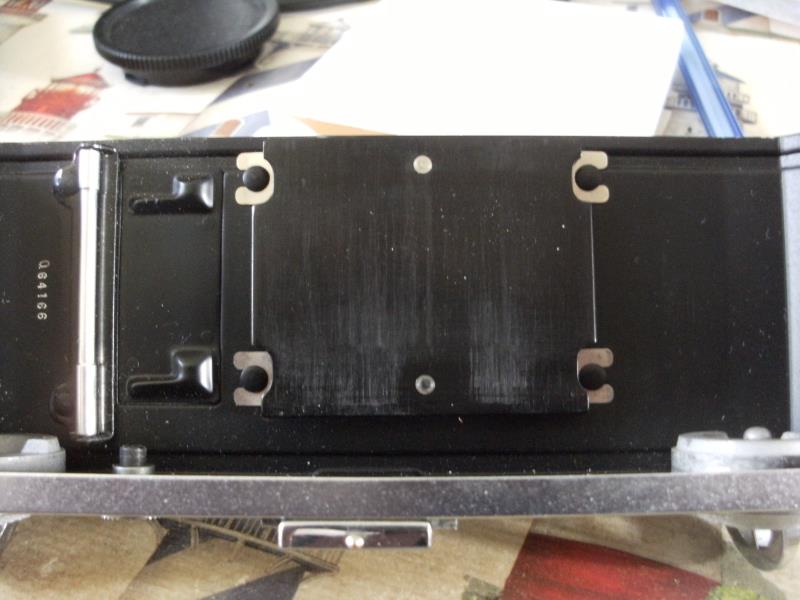

Concerning the back, the different of weight is sensible. The camera is "solid" in the hands, without these creakings which are common on Contaxes and Kievs. But the Inside too is different: the reinforcements, the position of the film plate, the absence of rivets...
This no s/n camera first:
Then, the Contax II "O series"

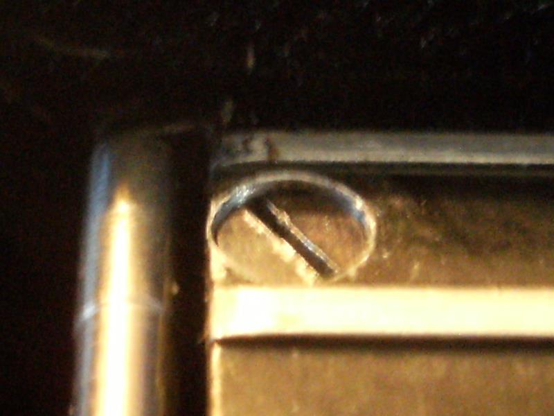

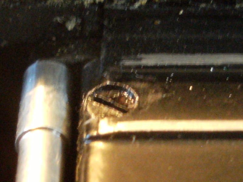

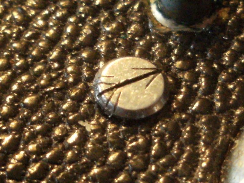

Inside, the screws are different in size (generally bigger on this camera), and sometimes in position.
The camera without s/n is always the first.

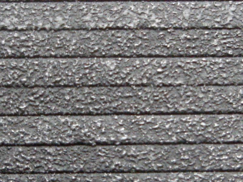

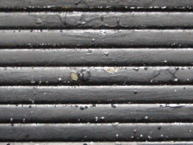

The shutter appearance is different too. It seems more light and "rubberized", compared to the one of a Contax II:

Unhappily, I could not dismount completely this camera. The main screws are too tight, which let me think that this camera was probably never dismounted.

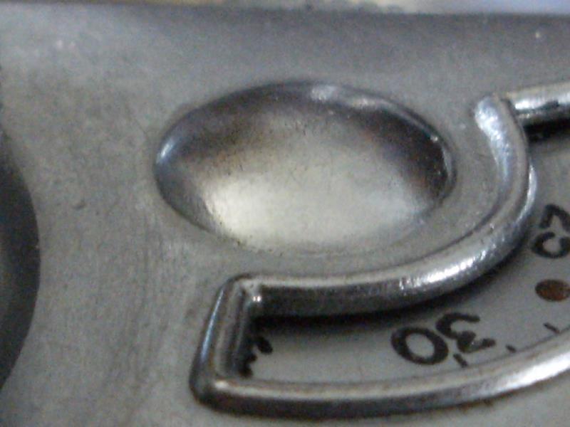

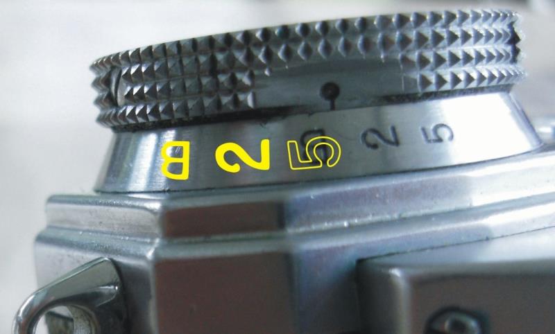

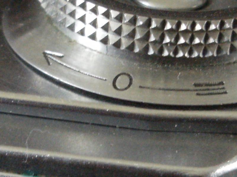

I think it is important to mention that the position of engravings "B" "2" "5" on the shutter speed selector is different from the standard one so that the cocking the shutter for these speeds became easier. It seems that the shutter cocking mechanism was redesigned.
There is also no possibility to adjust the vertical alignment of rangefinder as on the standard models.
The self-timer construction seems to be different. At least it has lacks two stoppers of the self-timer lever and its housing is larger as the standard one.
The camera has no numbering of main camera blocks like on the mass-production models. There is no number on bayonet at all. This means that the bayonet was assembled for this camera only.

There is something else, about the lens, that time.
It is a black Tessar made in 1931 which is coated (first and last glasses at least: I have not looked inside).
The coating was not deposit before 1936 or 37 by Zeiss (I don't remember exactly when) and so, it must have been made after on this lens. Not impossible, of course. But unusual.
It would have been much easier to put a contemporary coated lens. So, why?
Correction: the T coating was patented in 1935, but was kept secret for five years, by Kuc.

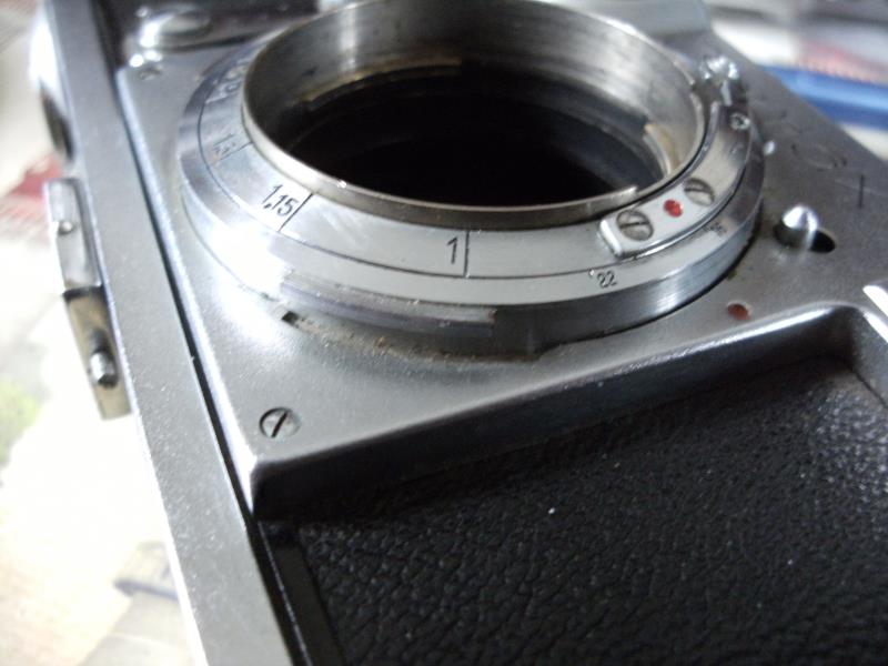

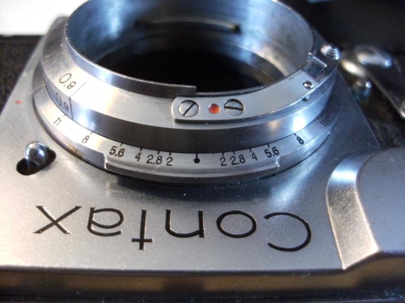

I take some more photos about the bayonet mount and the engravings.
So, about the focus range.
It's not a question of limiting screw, but really a difference between the two helicoïds.
Please have a look at these two photos.
First, the Contax prototype
Then the Contax O series
The helicoïd is at infinity for the two cameras. But on the prototype, the 0,9m has approximatively the same position as the 1m on the Contax II O series (and the Jena Contaxes, and the Kievs..)
On the whole range the positions of the same distances are different.
So, I think that the helicoïd is different too. And perhaps even the regulation of the rangefinder ??

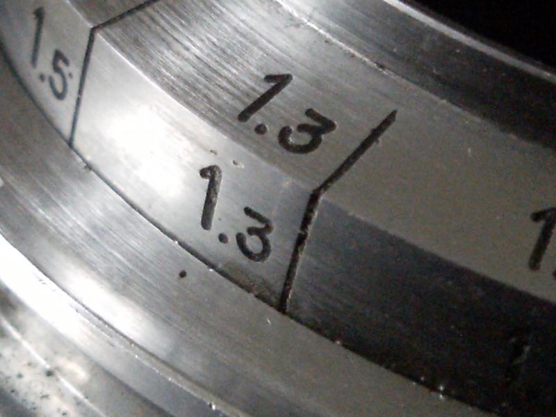

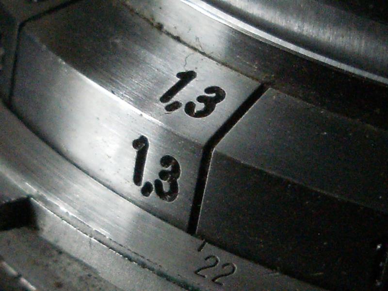

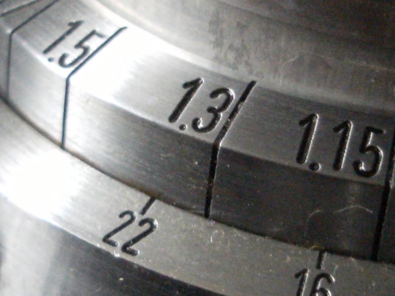

As I was taking photos, I have shot the "1,3" distance. Interesting!
The prototype
The Contax II O series
The TSVVS
The Jena Contax s/n 30536
So, there is a point only on this camera, the other ones have a coma between the 1 and the 3.
Concerning the "3", the head is flat on the Dresden O series and on the prototype. The other ones are rounded.
As for the engraving, the finest is on the prototype, no doubt.

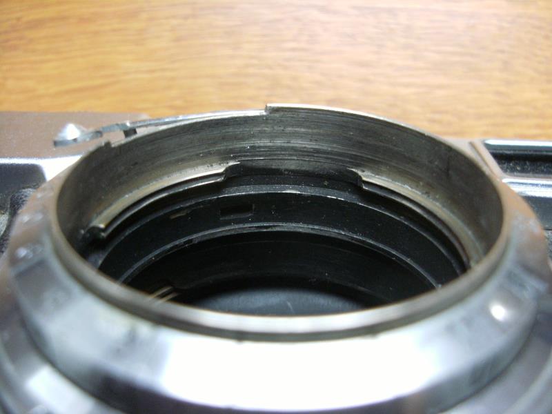

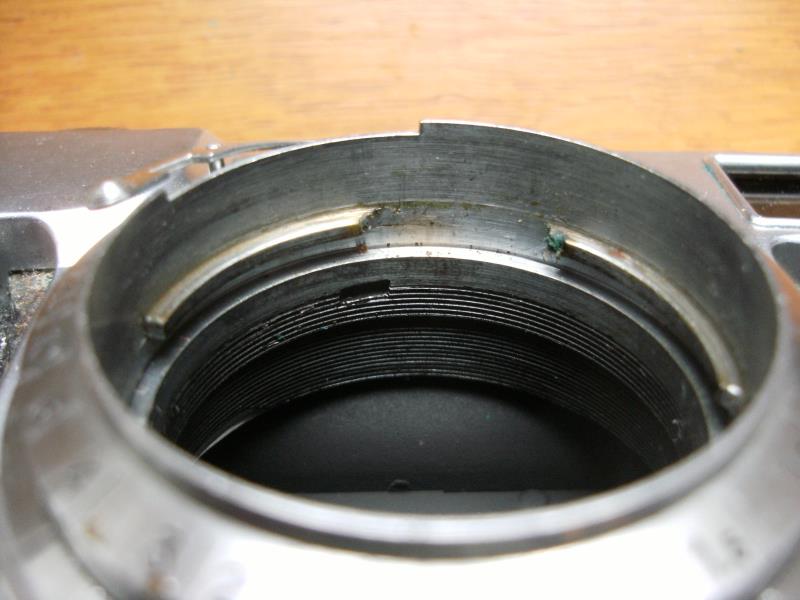

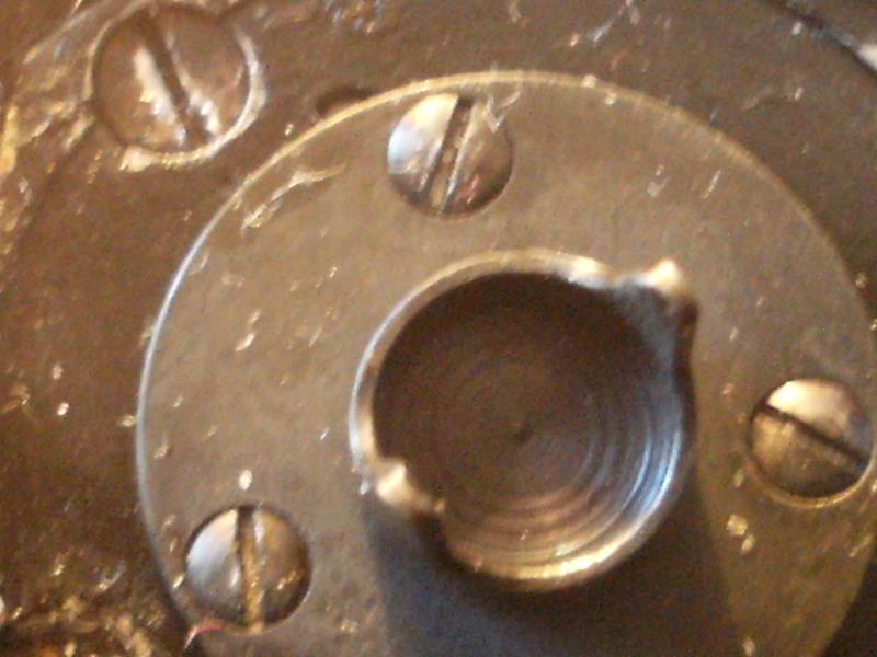

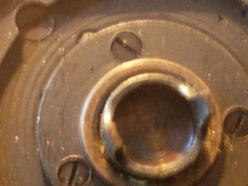

Two last photos about the mount.
Always some differences...
The prototype:
The Contax II O series:
We really think, Altix and me, that this helicoïd/mount was specially made for this camera. The problem is that there is absolutely no inscription anywhere (at least on the parts I could dismount).

Here is an illustration that the shutter setting mechanism on this camera is different. The position of the engravings are not on the usual places (yellow color shows standard positions).

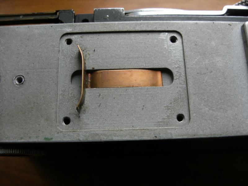

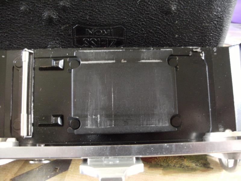

And here is the bottom of the camera with back door removed.

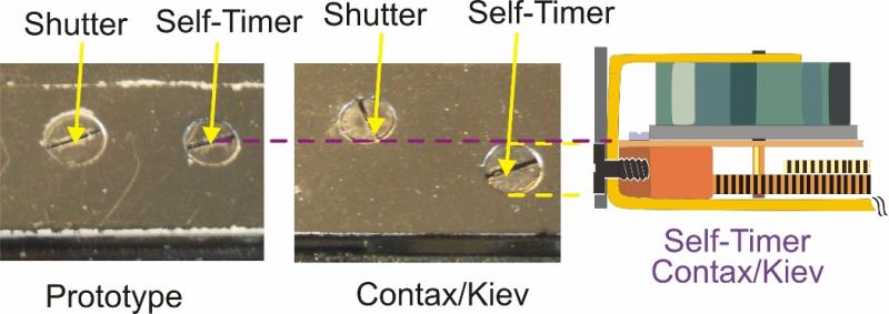

Two bolts are shown that hold the shutter and the self-timer. One sees that the bolt that holds self-timer on its place is displaced from its standard position. On the right is a simple sketch of lower part of the self-timer mechanism. One sees the corresponding bolt (black). In the prototype the position of this bolt is displaced. The self-timer housing or even its mechanism should be different in order to allow the bolt hold the self-timer housing.
It seems that people who made this Contax had only part of all measurements of original Contax. It is hand made with many parts that were produced only for this camera.
