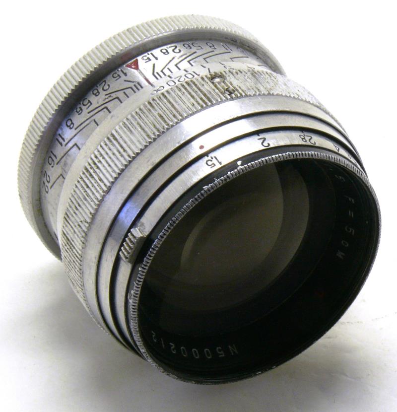

It is funny enough but here is another lens with close scratched number. The number was replaced with another. Probably the optical block was adjusted to another barrel initially and the person who marked made a mistake. But you see that the person who made both engravings was the same man or woman.
http://www.ussrphoto.com/resize/resize_image.aspx?ImgWd=800&IptFl=/UserContent/452015_zk2.jpg
http://www.ussrphoto.com/UserContent/452015_zk2.jpg
http://www.ussrphoto.com/resize/resize_image.aspx?ImgWd=800&IptFl=/UserContent/452015_zk1.JPG
http://www.ussrphoto.com/UserContent/452015_zk1.JPG

Replied on: 20150504133751
Wow ! Obviously you are right, the same guy (or girl) held both objectives in his hands some 67 years ago, amazing !
There is the same kind of scrached numbers on the J-3's optical block. So maybe it's also genuine ?!

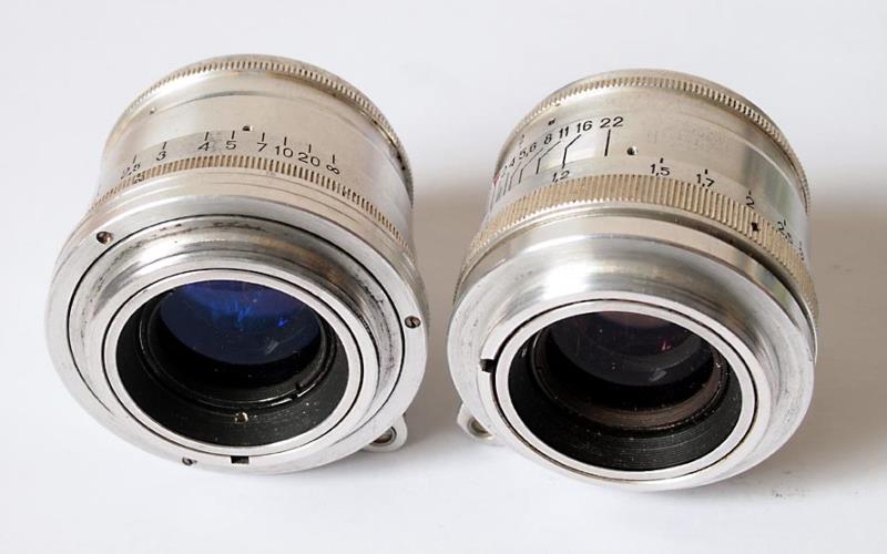

Concerning J3 I tend to call it fake. I do not see any details that can convince me that this is Zorki lens with suitable number. It looks like the original but the devil is always in details. The most disgusting in this model are these Zeiss "ears". It seems that it is the knurled ring from late J3 with cuted away edges to bring the form of ears. The original ears in this serial number span were chrome plated and really well made. Engravings on this ring look like original, but "4" is of different form. There are also other details like shape of some numbers, size of bolts, etc.
I would also expect pressed Zeiss number on the lens block. Of course 1950 was a turbulent year for KMZ lenses. There could be many variations of design. But still I do not believe that it is original lens. It was very stupid for KMZ to make a knurled ring and then to cut it in order to produce ears. Very illogical and costly experiment with the design.
From all lenses you showed us I would buy only ZK 135. It is the only jewel there that is put to sell the rest of this folklore stuff.

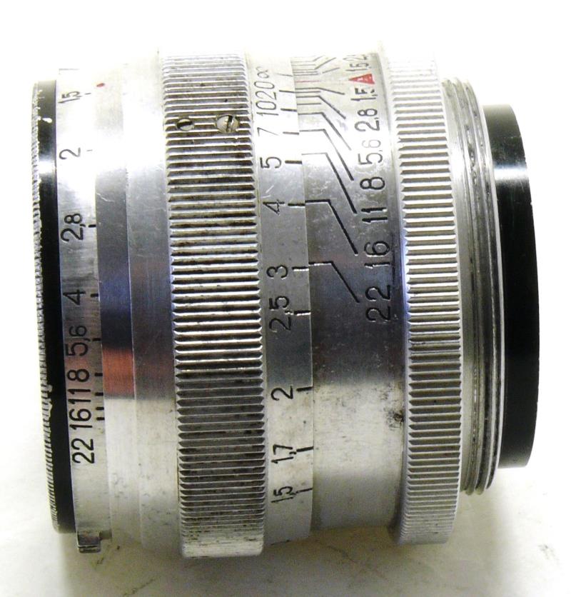

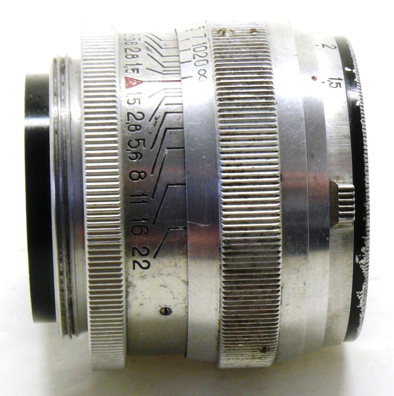

I am not sure that the J3 is a fake. I own a J3 from 1951 that has ears like the one shown here and an internal stamped in number but it is named Jupiter 3. So who would fake such a lens? And when I compare the ears to a ring on a normal J3 I don't belive that it is cut out (even if it looks so). The ears are much thicker than the ring.
See here:
http://ritzelkiste.de/ussrphoto/j35101.jpg
http://ritzelkiste.de/ussrphoto/j35102.jpg
http://ritzelkiste.de/ussrphoto/j35103.jpg

everything could be. As I wrote that 1950 was a turbulent year for KMZ and one can spot dozens of design variations. I used as a reference a lens that is only few numbers from the lens what was shown.
http://www.ussrphoto.com/resize/resize_image.aspx?ImgWd=800&IptFl=/UserContent/752015_1.JPG
http://www.ussrphoto.com/UserContent/752015_1.JPG
http://www.ussrphoto.com/resize/resize_image.aspx?ImgWd=800&IptFl=/UserContent/752015_2.JPG
http://www.ussrphoto.com/UserContent/752015_2.JPG
http://www.ussrphoto.com/resize/resize_image.aspx?ImgWd=800&IptFl=/UserContent/752015_3.JPG
http://www.ussrphoto.com/UserContent/752015_3.JPG
The ears are of different form and are chrome plated. There are differences in engravings and the stopper bolt is on other position.
Now I see that your Jupiter 3 looks the same as ZK from 1950. Still the absence of Zeiss number on ZK is confusing. But it is possible to have ZK without Zeiss number and Jupiter with Zeiss glass. So there is still uncertainty about the lens but now I am not so sure that it is fake. Thank you.

Replied on: 20150507160513
Probably when the original Zeiss ears were all used, KMZ used other available knurled rings brought from Zeiss factory. KMZ workers modified the rings to make Zeiss-look design. It is not a very elegant method but is ok when you have tons of spare parts that you can use in this way.
Replied on: 20150507164321
Yes, that could be possible. Or maybe later in the years parts were used by KMZ that were not used by Zeiss before because they do not fit the Zeiss standards and that were not thrown away in the war confusion. We will never know it... ;-)
Replied on: 20150508053035
I think too that we must be cautious: we don't know in which order KMZ used all the parts which came from Germany...

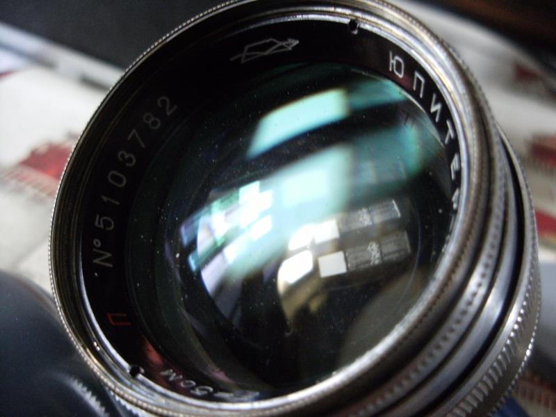

Another lens for which I would like your opinion.
It's a 1951 jup 3, internal barrel made of brass, a very beautiful green coating on the first glass (impossible to shoot correctly). The usual lilac/blue tints are inside, with yellow. An astonishing rainbow!
I had seen only one other lens like this one, but it was in M42 mount, if I remember.
No ears and no possibility to unscrew to check if there is a Zeiss number.
I cannot "decide" if it is a Zeiss or KMZ lens...[:o)]
http://www.ussrphoto.com/resize/resize_image.aspx?ImgWd=800&IptFl=/UserContent/852015_DSCF2153.JPG
http://www.ussrphoto.com/UserContent/852015_DSCF2153.JPG

Replied on: 20150508073136
Oh, congratulations Jacques! It seems that you have multicoated lens from 1951 [:)] Original German patent 1934 says in indirect way about possible multicoating of lenses. Who knows it could be that your Jupiter was some trial of Zeiss in multicoating procedure. But it could be that somebody coated the lenses recently. Who knows...
Replied on: 20150508081937
I have owned this lens since years.
But I have never seen such a green coating on another lens (except the Jup in another mount). It looks exactly like the green of fujifilms!
I will try this lens on a body. I have to, now....[:)]

Reply author: Trazin
Replied on: 20150617034621
Hello Everyone !
Jacques, Did you try your lens? Does it perform well?
I think I have something pretty similar with a kind of multicoating. Perhaps they made a whole series of multicoated jupiter during the 50's?!
http://s15.postimg.org/jdme1eiyz/IMAG0793.jpg
http://s15.postimg.org/gi9aujeyz/IMAG0794.jpg
I bought it mostly because of the serial number :).
Cyril.
Replied on: 20150618033342
Hi Cyril!
No, I have not yet tried my "green" Jup 3: too much material, and I have no numerics to try the lenses. Perhaps it will be my next purchase.
As for your Jup 11, I Wonder if you don't have an ungluing of a glass Inside. The irisation on the last photo remembers me one of my postwar Sonnars. Hope I am wrong and it is only the reflexion of the trees!
Replied on: 20150618045515
Yes,unfortunately one of the glass is a bit unglued in the corner. Do you think it was made using post war Zeiss lens ? It would be really strange. Maybe it was an experimental part ?
To make such a fake would be a nonsense as it was not so expensive ... (Twice the price of a jupititer 11 in average condition).
Amitiés, Cyril
Replied on: 20150619054707
Hi Cyril,
It's rather the Zeiss Oberkochen lenses (Western production) which are known to have problems of separation. I own one of these lenses s/n 1979274, a 1,5/5cm LTM Sonnar, which has a strong separation inside: a question of glue.
Yours is a Jup, so on the Jena eastern side. These lenses are generally free from this kind of problem. And in 1952, the Jup 11 was surely completely made by KMZ. So, it's certainly an individual problem.
Replied on: 20150619070547
Hello Jacques,
So it might mean that somewhere around 1952 KMZ experimented some multicoated lenses and issued some of them... It's interesting! And maybe a multicoated version of other jupiter also exists :)
Amiti&#233;, Cyril.
Replied on: 20151230075501
Hello everone!
I just bought a BK from 1948 year with a really early number but without zeiss serial on the barrel... [:(]
Is it possible? It looks genuine, only the coating is maybe alittle too blue comparing to other zk...
http://i.imgsafe.org/e493140.jpg
http://i.imgsafe.org/ee5d917.jpg
http://i.imgsafe.org/0989ae2.jpg
http://i.imgsafe.org/eee70c7.jpg
http://i.imgsafe.org/072019c.jpg
http://i.imgsafe.org/f8801fa.jpg
http://i.imgsafe.org/0c87174.jpg
http://i.imgsafe.org/0d2f639.jpg
http://i.imgsafe.org/e619ee1.jpg
http://i.imgsafe.org/e9780ae.jpg
http://i.imgsafe.org/ede085e.jpg
What do you think about it? Could it be fake?
Thanks for answers!
Replied on: 20151230081026
Bye the way. the rear cap is pretty unusual...
http://i.imgsafe.org/6d53890.jpg
http://i.imgsafe.org/6e01dee.jpg
Cyril
Replied on: 20151230114454
Hello Cyril!
At first sight, the body of your BK seems correct, with its two screws. As for the glasses, of course, I cannot tell. A 1948 BK should have a Zeiss number, I think.
Note that I own three early Jup 12. Two have Zeiss numbers, and the bodies are different on the three ones...
Amitiés.
And all my wishes to everybody for 2016!
Reply author: AlexanderK
Replied on: 20151230140828
Hi Cyril,
your Jup-12 seems to be the late one. My opinion, it is not a genuine BK-lens. The rear cap seems to be not genuine as well, sorry.
P.S. I bought 2009 two BK lenses from one seller from Moscow, both are fakes (unfortunately I have checked them about 1/2 year later).
May be we have the same seller [:)]. You can write me on my Email.
Replied on: 20151231014021
Hello everyone!
All jy wishes for 2016! Hope you will a lot of interesting cameras during the it's ing new year !
This is really disappointing. The fake is really well made it nerfs just a Zeiss number... And its not most difficult to fake ...
Best wishes,
Cyril
Reply author: Kievuser
Replied on: 20160312063612
I have a very uncommon Jupiter-8,a 1954 one found on a Zorki-3. The usual J-8s have 3 screws on the back.
Cheers
Zhang
http://www.ussrphoto.com/resize/resize_image.aspx?ImgWd=800&IptFl=/UserContent/1232016_P3126272.JPG
http://www.ussrphoto.com/UserContent/1232016_P3126272.JPG
Reply author: jed
Replied on: 20160313004534
Hi Zhang,
My 1954 s/n 5447526 j8 is also without the 3 screws. Lens came with a Zorki 3.
Best,
Jed
Replied on: 20160313090308
<blockquote id="quote"><font size="1" face="MS Trebuchet, Arial, Helvetica" id="quote">quote:<hr height="1" noshade id="quote"><i>Originally posted by jed</i>
<br />Hi Zhang,
Best,
Jed
Hi Jed,
Thanks for the input. I guess I did not pay much attention to these details before. I had a look at all the J-8s on that auction site last night and it seems that this type of J-8s are very common. In fact, all the J-8s made before 1954 including the ZKs are without the 3 screws. J-8s made between 1955 and sometime in 1959 has the focusing lever,and 3 screws , and J-8s made later are without the lever.[:I]
Zhang
