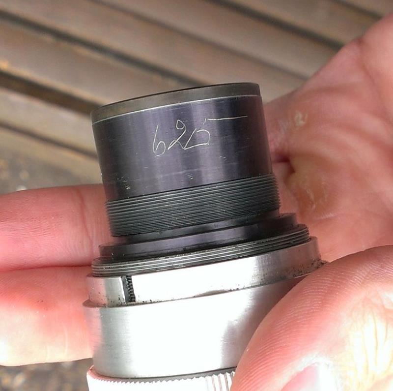

Unfortunatly I didn't took picture from the rear...
That's all:
On the the ZK-50 optical block there are the same kind of inscription as those you can see on the ZK-135's block.
hébergement gratuit d'images
Dear Trazin. Take ZK 135 and run away Smile. No doubt it is genuine.

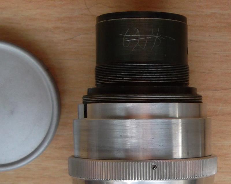

It is funny enough but here is another lens with close scratched number. The number was replaced with another. Probably the optical block was adjusted to another barrel initially and the person who marked made a mistake. But you see that the person who made both engravings was the same man or woman.
Wow ! Obviously you are right, the same guy (or girl) held both objectives in his hands some 67 years ago, amazing !
There is the same kind of scrached numbers on the J-3's optical block. So maybe it's also genuine ?!
