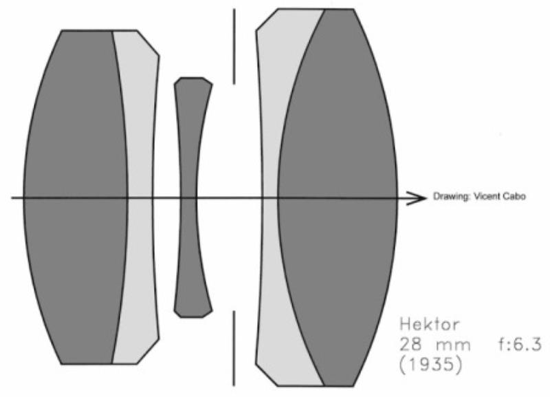

Another Britisch design was used for the Fed 28mm f4.5 known as the 'Ross Wide Angle'
https://lh3.googleusercontent.com/-iBxG2N3-uVI/Vv6sV_NDeMI/AAAAAAAACmk/-g42DlIpEbQzFbsHdkRyGp7g7LCYHLPJQCCo/s512-Ic42/IMG_0135.JPG

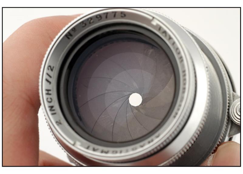

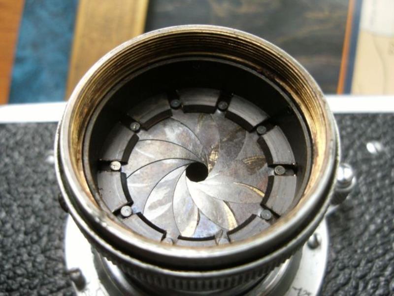

There is another difference between the Fed and the Summar: the diaphragm. Round hole for Fed, beautiful hexagonal one for the Summar which is said to have a slight different rendering (swirling bokeh) for that reason in some conditions. For me, the difference is very tiny...
About the exact part of Fed factory, the GOI calculated all the lenses, and checked them. The JLP is affirmative on this point. But where were these lenses produced? By whom? In Kharkov? I should be glad to know more...

The Summar even has a dome shaped aperture, made to move between the sferical forms. That's why it only goes up to f12.5

Just to complete this interesting thread, a short comparison of the diaphragms.
The Summar first (not mine, screw too tight):
http://www.ussrphoto.com/resize/resize_image.aspx?ImgWd=800&IptFl=/UserContent/642016_leica-summar-5cm-1937-l39-blades.jpg
http://www.ussrphoto.com/UserContent/642016_leica-summar-5cm-1937-l39-blades.jpg

And the Taylor-Hobson's:
http://www.ussrphoto.com/resize/resize_image.aspx?ImgWd=800&IptFl=/UserContent/642016_taylor hobson f2.jpg
http://www.ussrphoto.com/UserContent/642016_taylor hobson f2.jpg
10 blades on the Fed, 12 on the Taylor-Hobson. The Summar is out of race!
All that makes me think that Fed lenses are not copies as servile as we could think...

Just an addition about the Fed 4,5/28mm. This beautiful lens was probably very difficult to mount, with these six very tiny glasses in four groups... And what about the air/glass surfaces, with all these possible internal reflections...
The two main contemporaneous wide angle lenses were the Hektor 6,3/28mm (Leica) and the Tessar 8/2,8cm (mainly for Contax). The difference of aperture compared to the Fed is very impressive... We have diagrams of a Tessar and of the Fed above. The Hektor's is there:
http://www.ussrphoto.com/resize/resize_image.aspx?ImgWd=800&IptFl=/UserContent/742016_hektor_28_63.jpg
http://www.ussrphoto.com/UserContent/742016_hektor_28_63.jpg
