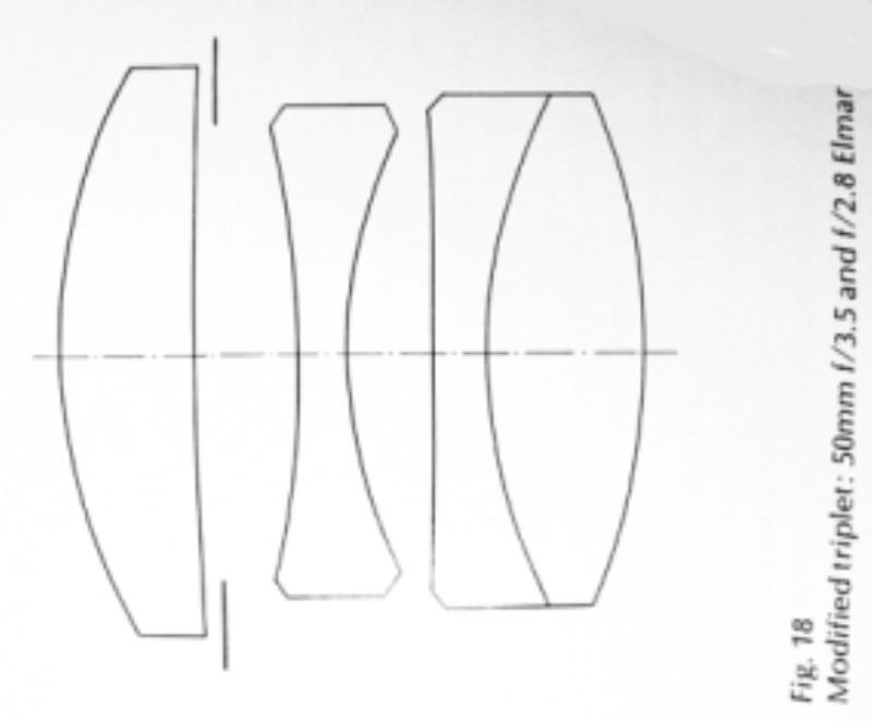

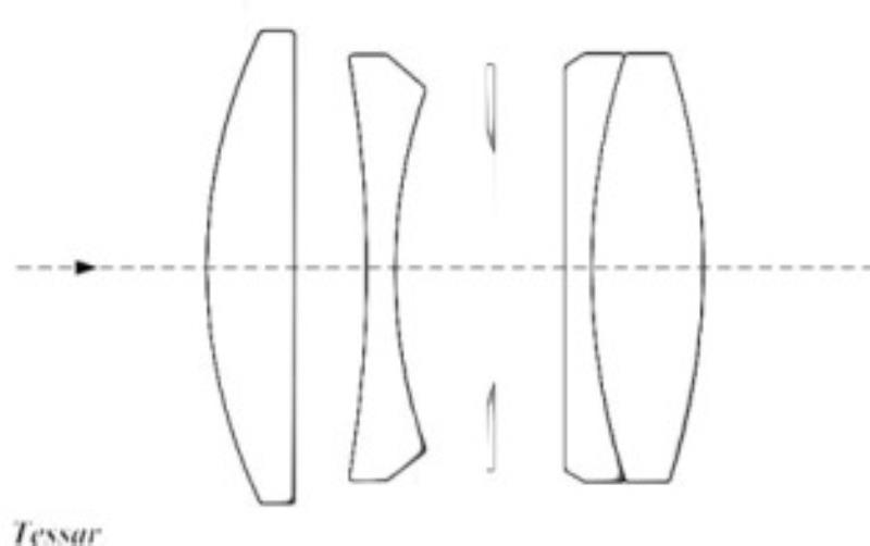

Concerning the formula, the Industar 10 is a Tessar one, with the diaphragm between the two groups of glasses.
The Elmar has a diaphragm just behind the first glass, at least for al the prewar ones. It allows to identify the fake ones!

I also know about the Industar-10 and the Elmar. Even the elements have a different shape and dimension.
Originally posted by Lenny
That's interesting too. So what kind of type was Industar-10?
Exactly, it is how Jacques has written. All Elmars have diaphragm behind first element of the lens while all Industar 10 have diaphragm behind second one. Reason is because first element in Elmar refracts light more than first element in Industar 10. This is because russians could not produce such type of the glass which was used in first element of Elmar.

Great explanation about the Elmar on Wikipedia.
It is sometimes thought that The Leitz Elmar 50/3.5 was a Tessar copy or clone. This is not the case. Although the lenses appear similar in layout, there is a lot more to the design and performance of a lens than simply the layout of the glass elements. The position of the stop, the optical characteristics of the glasses used for each element, the curvature of each lens surface, and the negative format which the lens is designed to cover, are all vital to the performance of the lens, and in the Leica lens these were all different from the Tessar. When the Leica was being developed Oskar Barnack tried a 50mm Tessar, but because it had been designed to cover only the 18x24mm field of a cine frame he found the coverage of the Leica 24x36mm format to be inadequate. The lens designed by Max Berek for the Leica rangefinder camera was a modified Cooke Triplet with five elements in three groups, the third group being three cemented elements, with the aperture stop in the first air space. This lens, called the Elmax, gave good coverage of the 24x36mm format and was used until improved optical glass allowed the third group to be simplified to a cemented pair and then lens was renamed the Elmar. It was not until Zeiss Ikon were developing the Contax camera to compete with the Leica that the Tessar was redesigned to cover a 24x36mm negative.
https://en.wikipedia.org/wiki/Tessar
The Fed 50/3.5 has nothing to do with the first Elmar developed from a Cooke Triplet because that Elmar was earlier in time. The Contax came out in 1932. Fed copied the Elmar Tessar.
