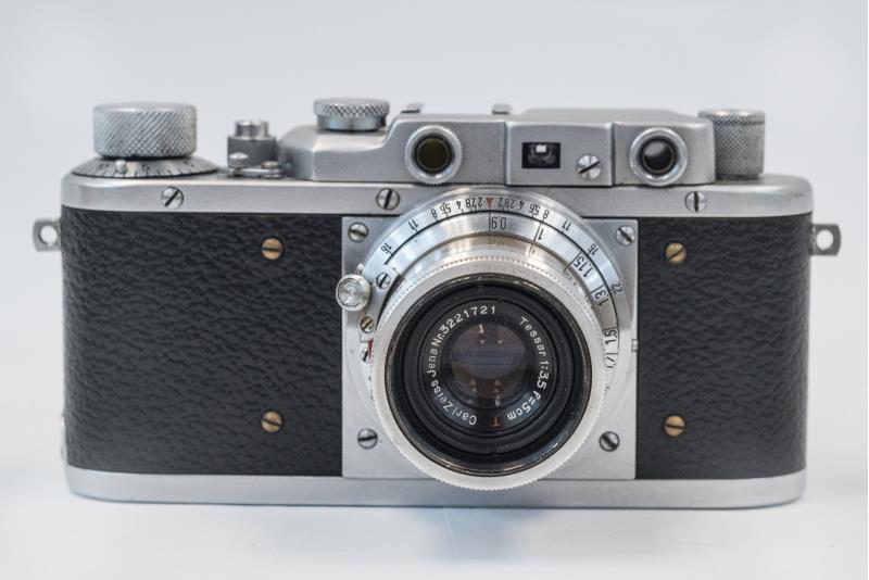

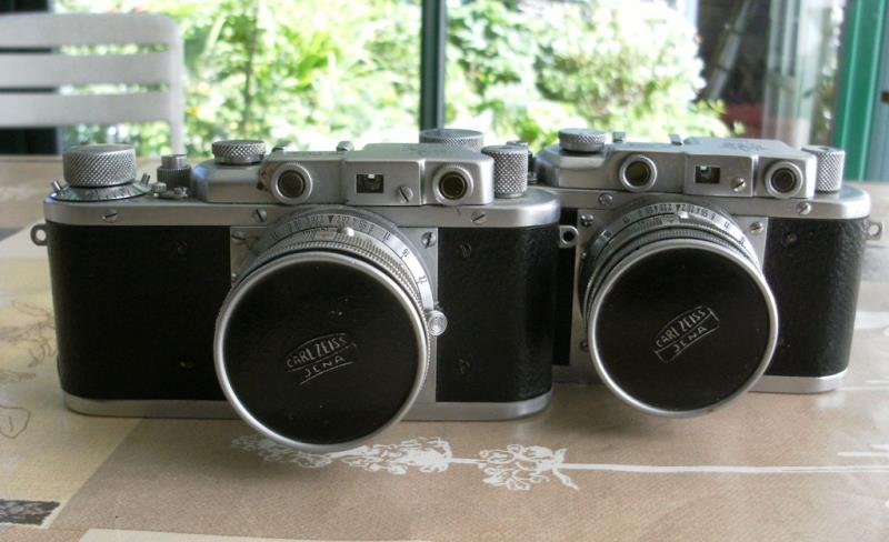

Reply author: Mosasaurus2
Replied on: 20161212161403
Here are some pictures of the both oldies ...
The metal version:
http://www.ussrphoto.com/resize/resize_image.aspx?ImgWd=800&IptFl=/UserContent/12122016_PC110411.JPG
http://www.ussrphoto.com/UserContent/12122016_PC110411.JPG
Replied on: 20161212161642
The chromed version:
http://www.ussrphoto.com/resize/resize_image.aspx?ImgWd=800&IptFl=/UserContent/12122016_PC110414.JPG
http://www.ussrphoto.com/UserContent/12122016_PC110414.JPG

Replied on: 20161212171210
Thank you Ad!

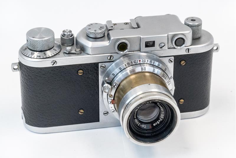

At first glance these do look like legit TSVVS (or VTS-VS) cameras with smaller rangefinder and viewfinder windows than FEDs. This is quite interesting as you have found them together in Germany, as one of the running theories here by Alexey Nikitin (levonsa) is that they were made in East-German factory by special Soviet order. I would like to get some other's opinions as well, but these seem like genuine articles to me (considering all TSVVS are gunuine) - another theory that the whole series is an elaborate line of fakes made by very skilled technicians in Poland..
I personally more inclined towards Alexey's story.

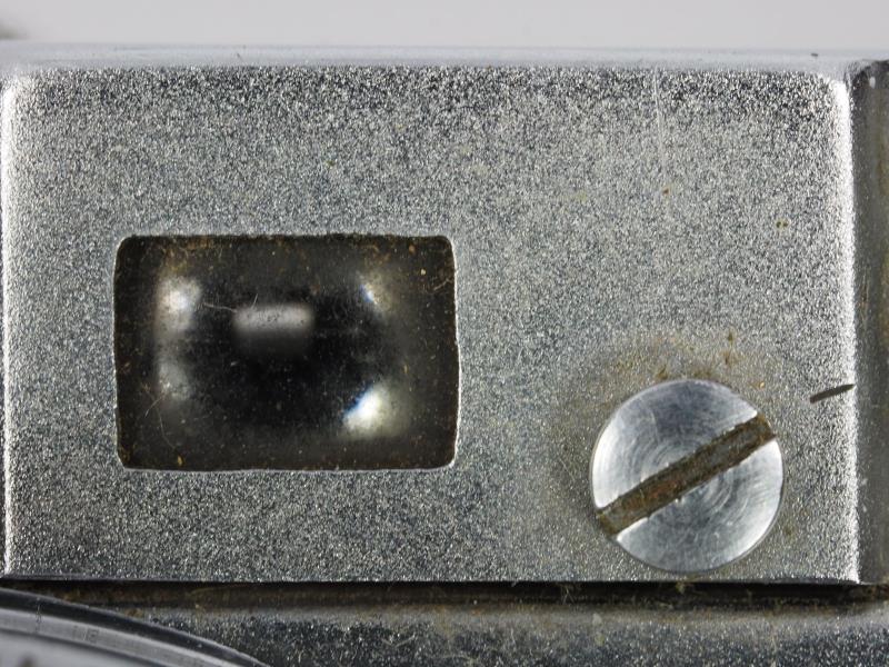

Replied on: 20161213054117
Welcome here, Ad.

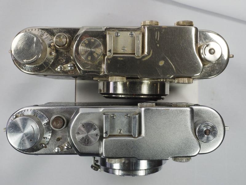

I had seen your question on RFF. And frankly, it's not easy to answer. Probably we could share the discussion and examine your two cameras separately...
There are many special features on TSVVS-s. I only take four of them.
- the weight. The body and the bottom are made of brass, so they are heavier than Feds. To compare: 572g for body + bottom, 52g for bottom only. For a Fed: 366g and 43g in the same conditions.
- the internal number, stamped on the bottom (internal face), bottom of the shutter box, and internal face of the belt, under the press film.
- the finder. The front window is smaller than Feds', and it is in the middle of the front rectangle.
- the dimensions, lightly bigger than Feds, so that a Fed shoe cannot be mounted on a TSVVS.
There are curious features on your cameras, and I wonder if they were not made from TSVVS parts, completed with other ones... Anyway, you should buy a 1d to compare closely, Ad...

1. Thanks for your answer. Too bad for me: the weight of both camera's is only 532 g each (excl. lens, incl. bottom). The weight of the bottoms is 49/48 g each. Material is brass, as you can see on the pictures ...?
2. The internal number is difficult to find. Should I use a screwdriver?
3. The finder looks very small
4. The length is 13,4 cm, depth is 3,1 cm.
(5). There also is the question about the leather: smooth indeed.

Replied on: 20161214040131
Hi Ad,

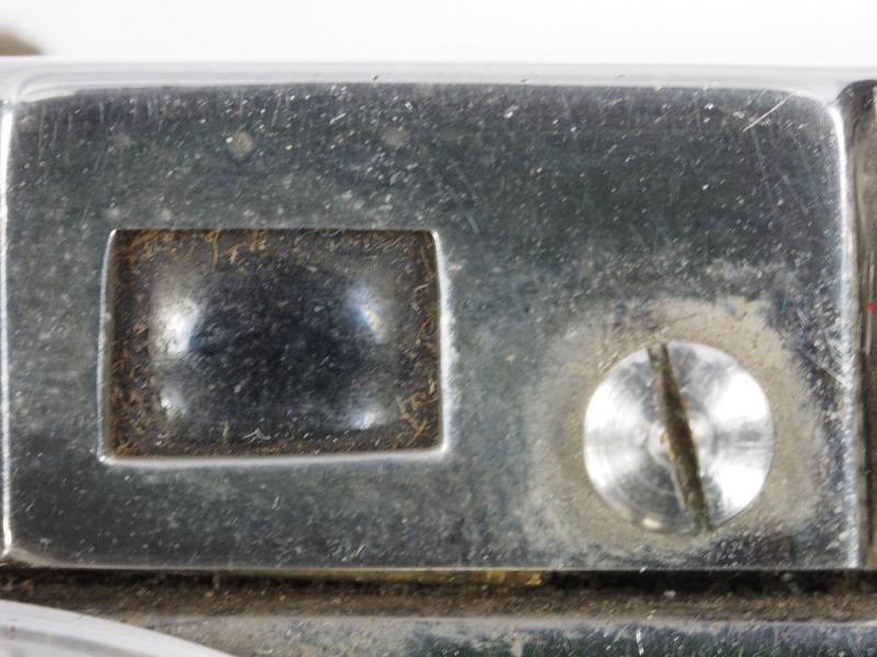

Sorry, the TSVVS is a bit smaller, not bigger. I should have re read my post... The dimensions you give are Fed's ones, TSVVS's ones are about 13,3cm/3cm if I take them at the shoe. And as said before, a TSVVS bottom cannnot be mounted on a Fed.
Concerning the finder, is seems that the window is too low (not exactly centered) on one of your cameras. Impossible to say for the other which is not entirely visible.

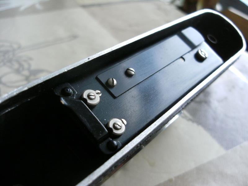

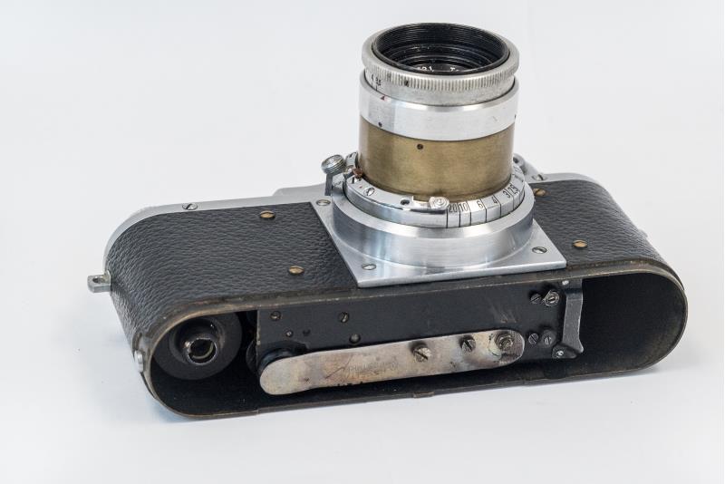

Replied on: 20161214054616
Something else.

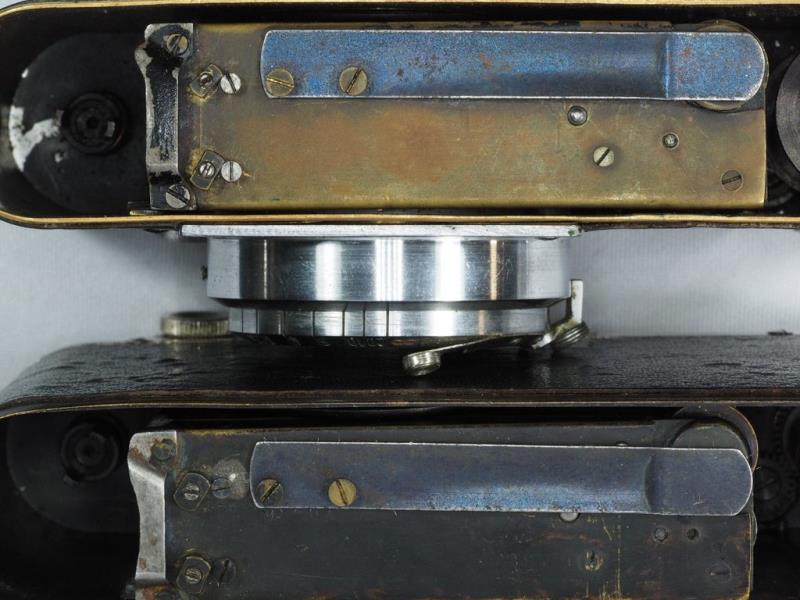

The bottom plate is bolted on the body through a piece which is screwed on your camera (your 4:17:57 PM post), like on Leicas.
On TSVVS-s and most Feds, this piece is riveted.
See here the difference:
http://www.ussrphoto.com/resize/resize_image.aspx?ImgWd=800&IptFl=/UserContent/14122016_DSCF2584.JPG
http://www.ussrphoto.com/UserContent/14122016_DSCF2584.JPG
Screws on left (Leica type), rivets on right (TSVVS type).
It would be interesting too to have a photo of the release spring. Fed's and TSVVS's are different.
PS: I had let the spool when weighing the TSVVS. Without anything, I have 559g.
Replied on: 20161214081538
So, original TSVVS or not? Impossible to be absolutely sure.
No doubt that some features are original: the buttons, the accessory shoe, the ears for straps, the leatherette. And the general look too: I agree with Vlad.
For me, they could be pre series cameras, before the official production, with some Fed/Leica parts. Or post series ones, with original parts completed with others. The fact that these cameras are not engraved goes in that direction: they could have been made in Germany, as said previously, but not sent in USSR, because non official ones.
Of course, we cannot completely exclude that they are fakes. A regular TSVVS worths 3000€ or so. At that price, it's easy to convince a faker. But I don't think it is the case: too many details are original. And seeing the price you paid for them...[:D]
You really have very interesting cameras, Ad. Just the ones I love: those who put questions!

Hello Jacques,
Here are 2 pictures of the of the bottom-plate (and here appear some more differences: (above) riveted (chromed version) and bolted (normal metal version)).
http://www.ussrphoto.com/resize/resize_image.aspx?ImgWd=800&IptFl=/UserContent/14122016_PC140458.JPG
http://www.ussrphoto.com/UserContent/14122016_PC140458.JPG
http://www.ussrphoto.com/resize/resize_image.aspx?ImgWd=800&IptFl=/UserContent/14122016_PC140460.JPG
http://www.ussrphoto.com/UserContent/14122016_PC140460.JPG

Replied on: 20161214085030
This may be going towards more discussion again about TSVVS origins, but a friend in Russia sent me an old article from Soviet Photo magazine (I have to find it, but it's in Russian), by a Polish technician who was describing installing a Contax mount on a FED camera. There was then a whole group of Russian collectors that started inclining towards a theory that the whole series were produced by this very talented group of Polish technicians as a "fantasy" series. Same people who made the FED Sport and Zorki 75. One of their arguments was that no one knew about this camera until it showed up in 1990s on the collector's market and there is no record of it anywhere before 1980s or so...
I hate to start another fire, but I think this forum is the place where to air such theories. [:)]
Replied on: 20161214092942
Ad,
You have a part of the release spring on your 4:17:57 post. It's the blue/black blade which is in connection with the release button: the spring moves when you press the button.
Replied on: 20161214101947
Hello Jacques,
Here is a picture of blades you meant. They look the same to me. The second looks a bit out of alignment.... (Metal version above.)
http://www.ussrphoto.com/resize/resize_image.aspx?ImgWd=800&IptFl=/UserContent/14122016_PC140465.JPG
http://www.ussrphoto.com/UserContent/14122016_PC140465.JPG
Replied on: 20161214102748
Hello Vlad, Jacques,
Why fire and firebrigade? Those are severe words :). It lookes like I've missed a dispute ...?
Ad
Replied on: 20161214103000
OK. The springs are TSVVS ones.
Fed's are flat:
http://www.ussrphoto.com/resize/resize_image.aspx?ImgWd=800&IptFl=/UserContent/14122016_DSCF2284.JPG
http://www.ussrphoto.com/UserContent/14122016_DSCF2284.JPG

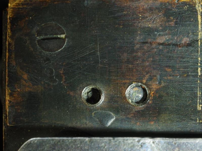

Replied on: 20161214105452
Ad,

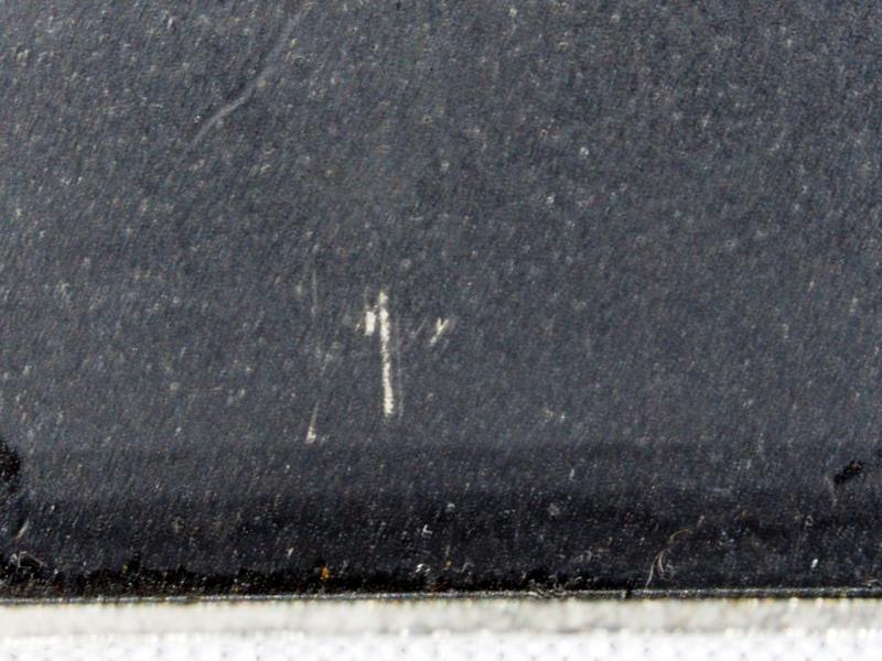

It seems I see a "17" on the right of your second camera. Can you confirm?
No cipher inside the corresponding bottom plate?

"17" you saw , on the right ...? ( Picture of 10:19:47, below?) Where exactly? Can you give me the coordinates :) ? (I feel like David Hemmings in Antonioni's Blow up... :) )
And what is the location "inside the bottom plate"? I'll have to remove something, the blade?
Salut,
Ad
Replied on: 20161214150720
Picture 10:19:47, camera with rivets. The "17" is on the right, between the right extremity of the spring and the screw...
Replied on: 20161214162010
Hello Jacques,
A "2"????? (Chromed version.)
http://www.ussrphoto.com/resize/resize_image.aspx?ImgWd=800&IptFl=/UserContent/14122016_PC140479.JPG
http://www.ussrphoto.com/UserContent/14122016_PC140479.JPG
Replied on: 20161215035714
OK, I have dreamt.
It would have been interesting: it's at this right place that there is a stamped number (at least on my "264").
I have nothing more to add now. You can see that there are vey light differences between these two backs of shutter box. More generally speaking, I always think that your cameras are pre or post run TSVVS.

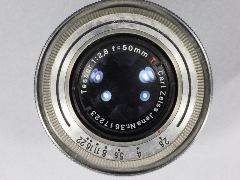

The lens is most interesting too. It belongs to a series of 10 (only !!) Tessars delivered the 14/06/1951, by Thiele. It's the last series of this lens produced by CZJ. And the only one to be written "50mm", not "5cm". The date is interesting in itself: it could lead to a post series for the cameras.

On the picture of the bottom plate (12 december (4:18:51) I can see a number: "1", I suppose. This is confusing... (Should be "2".) Below a detail/close up.
Ad
http://www.ussrphoto.com/resize/resize_image.aspx?ImgWd=800&IptFl=/UserContent/15122016_PC150485.JPG
http://www.ussrphoto.com/UserContent/15122016_PC150485.JPG
Replied on: 20161215155140
About a repair/cleaning, you will do what you want, Ad.
But frankly, I would keep the two cameras in their actual condition, so that they can be studied a bit more closely, by an expert, for example...
If you decide to have them cleaned, a Leica screw mount specialist will be perfect. No doubt you have some in Netherlands. If not, I can provide you two adresses in France.
Replied on: 20161215160651
I don't know if your "1" can be considered as an original cipher: impossible to say, only by a photo. It depends on the depth of engraving and the dimension of the cipher... And it would be necessary to compare the position of the numbers on all the TSVVS we know: are these numbers always put in the same place?
TSVVS are rare cameras (probably 1000 samples), so they are not completely known. Already for the running production! As for your couple...

Replied on: 20161217095759
Hello Jacques,
I've a question about your remark of Dec 15 2016 :  03:57:14 AM.
(It's a pity that I don't own the CZJ inventory book of Thiele.) You noticed that on 14/6/1951 a series of 10 were made.
Do you mean 1 serie of 10 lenses or 10 series of ... lenses? And only 1 lens with the inscription of 50mm? That's peculiar and rare...
Regards, amitiés,
Ad
http://www.ussrphoto.com/resize/resize_image.aspx?ImgWd=800&IptFl=/UserContent/17122016_PC170490.JPG
http://www.ussrphoto.com/UserContent/17122016_PC170490.JPG
Replied on: 20161217104239
It was in 1951 that Zeiss modified the distance scale on their lenses (cm -> mm).
So, your lens belongs to a serie of 10 lenses in a Contax mount. This serie was the last for the f2,8-5cm/50mm (in Contax mount)and the only one to be marked in mm. All the precedent were marked in cm. There were no other 2,8/50mm in Contax mount later.
Of course, it's a rare lens, as only 10 exist!
Replied on: 20161219071138
Hello Juhani,
At your request: 2 pictures of the camera's. Above the chromed version. It's difficult to make a picture of the chromed version: strange reflections all over.
http://www.ussrphoto.com/resize/resize_image.aspx?ImgWd=800&IptFl=/UserContent/19122016_PC190496.JPG
http://www.ussrphoto.com/UserContent/19122016_PC190496.JPG
http://www.ussrphoto.com/resize/resize_image.aspx?ImgWd=800&IptFl=/UserContent/19122016_PC190500.JPG
http://www.ussrphoto.com/UserContent/19122016_PC190500.JPG
Replied on: 20161219074228
Hi Ad,
no doubts for me that they are both real TSVVS cameras. Congratulations to that find. The chromed one could be chromed later, but to say that one must have it in the hands.
If you are interested I can inspect and clean them. I have disassembled my TSVVS some times ago and I think I can say if yours are real.

Replied on: 20161219090824
Thanks for the new photos, Ad.
Looking at them, it seems that:
On the above version, the strap lugs are lower than on ordinary TSVVS-s,
On the other one (below), it's the middle screw which is not on its common place. And the rectangular finder ir not exactly centered.
This last remark is important, as most fakes have a wrong rectangular window, too large, because of a cover borrowed to Fed 1 (I have not said that your camera is a fake!).
Now, concerning the classification adopted by sovietcams, I don't see why these non engraved TSVVS should necessarily be pre serie cameras. But the shape of the cover, they should rather be intermediate prototypes or post series. I ask Aidas about it. Certainly he will answer!
Alexander: I cannot see if you have screws or rivets to fix the lock of the bottom on your camera? It seems there are inside numbers stamped?

Replied on: 20161219103954
No, Ad, it's a question of position: the rectangle does not seem well centered: probably too low.
To compare with the windows on my two TSVVS which seem correctly centered:
http://www.ussrphoto.com/resize/resize_image.aspx?ImgWd=800&IptFl=/UserContent/19122016_TSVVS 005.jpg
http://www.ussrphoto.com/UserContent/19122016_TSVVS 005.jpg
That said, I may be wrong: it's perhaps the photo...
Replied on: 20161219160500
Hello Jacques,
No, you are not wrong. The rectangle viewfinder is vertical not well centered. Something lower. And that makes the difference! (On the internet I can't see any TSVVS which has a "lower" viewfinder. So this is OR interesting (and need research) OR a clue that they are fakes...?
Anyway, they look somewhat clumsy...
Ads

The viewfinders. The chromed first.
http://www.ussrphoto.com/resize/resize_image.aspx?ImgWd=800&IptFl=/UserContent/19122016_PC190501.JPG
http://www.ussrphoto.com/UserContent/19122016_PC190501.JPG
http://www.ussrphoto.com/resize/resize_image.aspx?ImgWd=800&IptFl=/UserContent/19122016_PC190502.JPG
http://www.ussrphoto.com/UserContent/19122016_PC190502.JPG
Reply author: ilyast
Replied on: 20161219182719
http://www.ussrphoto.com/resize/resize_image.aspx?ImgWd=800&IptFl=/UserContent/19122016__DSC8022.jpg
http://www.ussrphoto.com/UserContent/19122016__DSC8022.jpg
http://www.ussrphoto.com/resize/resize_image.aspx?ImgWd=800&IptFl=/UserContent/19122016__DSC8028.jpg
http://www.ussrphoto.com/UserContent/19122016__DSC8028.jpg
Replied on: 20161219225441
Fake would be easy to make perfect with better tools than back then. And in a fake something this visible would not be left this raw.
Replied on: 20161220043731
I think too, Juhani.
What a strange mount for your Tessar, Ilya! Where does it come from? Could you tell the s/n of the lens? The release spring seems a bit special, with its three screws. Well, so, a "no name" more! Finally, they are not so rare![:D] Always no internal number?
Thanks! Jacques.
Replied on: 20161220092158
http://www.ussrphoto.com/resize/resize_image.aspx?ImgWd=800&IptFl=/UserContent/20122016__DSC8024.jpg
http://www.ussrphoto.com/UserContent/20122016__DSC8024.jpg
Replied on: 20161220120111
Thanks, Ilya.
By its number, this Tessar belongs to a series with Exakta mount, delivered the 13/07/48, by the Thiele. OK for the date. But not really understandable for the mount...
And it seems that the regular engravings on the upper plate don't exist on Ilya's camera: no arrow towards the counter frame (just a point), idem for the arrow and the "B" under the rewind lever... just like one of Ad's cameras.
Our enquiry is not finished...
PS: Aidas cannot help us.
