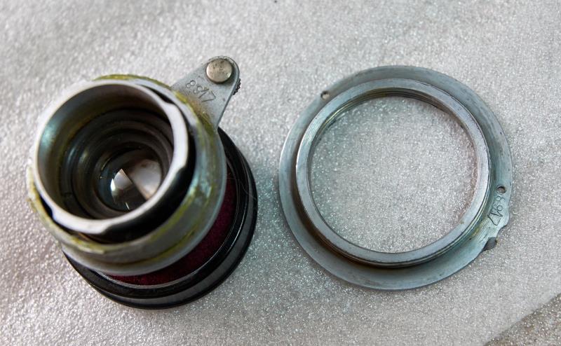

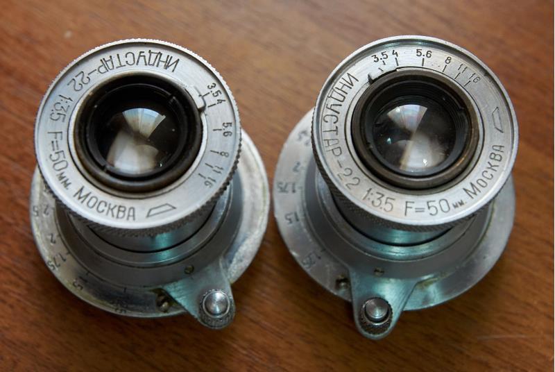

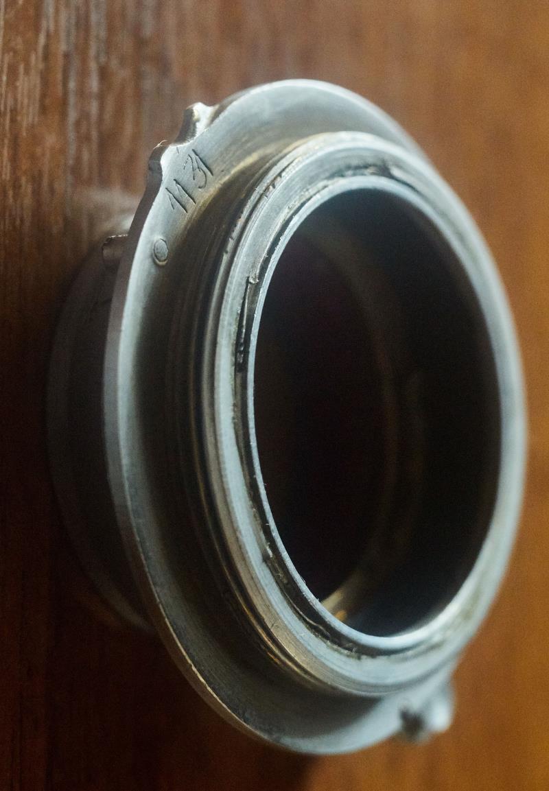

Lenses "industar-22 Moscow", serial numbers 1131 and 8917. Lenses are uncoated, both have strong front focus.

Reply author: Alfa2
Replied on: 20190804052200
Probably they were disassambled and not properly assembled than. In my opinion black tube should not poke from a ring where are engravings.
But this is only my guess.
Reply author: sargass
Replied on: 20190807091709
<br />Probably they were disassambled and not properly assembled than. In my opinion black tube should not poke from a ring where are engravings.
With all respect.
First, there is information about the third such lens with the same problem. Secondly, to collect "industar-22" is wrong, it is quite difficult :) Thirdly, one of the lenses in the photo I did not disassemble.
Reply author: seany65
Replied on: 20190902171627
Sergey, is it possible that someone else disassembled the lens that you haven't, and reassembled it slightly incorrectly?
I wonder if this "front focus" was a problem with a batch of these lenses? I can't see it being a problem with all of them and most of them have been "rescued" by owners/technicians over the years.
