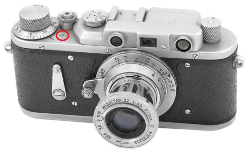

Hi Antonio,
Difficult to be affirmative about your camera. But it can be a Zorki 1 modified into a Zorki 2... Not very difficult to put a Zorki 1 cover on a Zorki 2 body...
About the selftimer button, it should be a Fed 3 or 4 one. Anyway, by comparison, the mechanism looks like a Zorki one (position of the release button). As for the Inside, no doubt it is a Zorki 2's one.

Replied on: 20180322095424
The camera is definitively a Zorki 2 (According to date of production and rewind system around the shutter release).
The camera received a Zorki 1 top and a lever of new style.
-Easy my Dear Watson!

A couple more modifications...
Zorki2's have a two-piece speed dial, ala Zorki-C & 2-c
Bottom plate is from a FED or early Z-1
Scalloped shutter release spring on bottom is from Zorki 2-c
Cheers, Geoff

Hello Geoffox
see PM1470 - Zorki-2 #552288.
at http://www.sovietcams.com/index.php?-302300902
Up to the pin!
http://www.ussrphoto.com/resize/resize_image.aspx?ImgWd=800&IptFl=/UserContent/2232018_zorki Pin.png
http://www.ussrphoto.com/UserContent/2232018_zorki Pin.png
Replied on: 20180325043950
Of course, Luiz, up to the pin, but not up to some other details...[:D]
This camera is not an original Zorki 2 and Antonio's question is valid.
I specially wonder about the speed dial: it's a "normal" Zorki one. Does it mean something about the internal selector mechanism? I should have a look inside my own Zorki 2-s ...

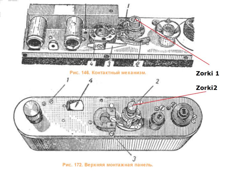

Dear Friends
According to Maizenberg book
the single difference is the internal screw and the speed crown dial
see pictures: So, it is easy to modify one to another threds are the same!
http://www.ussrphoto.com/resize/resize_image.aspx?ImgWd=800&IptFl=/UserContent/2532018_Zorki FED.png
http://www.ussrphoto.com/UserContent/2532018_Zorki FED.png
Replied on: 20180325112130
Thanks, Luiz.
But I am a bit surprised. On Leica type cameras, it is necessary to cock before changing the speed. No importance on Zorki 2 ones (I have just checked). Strange if there is no other modification...
