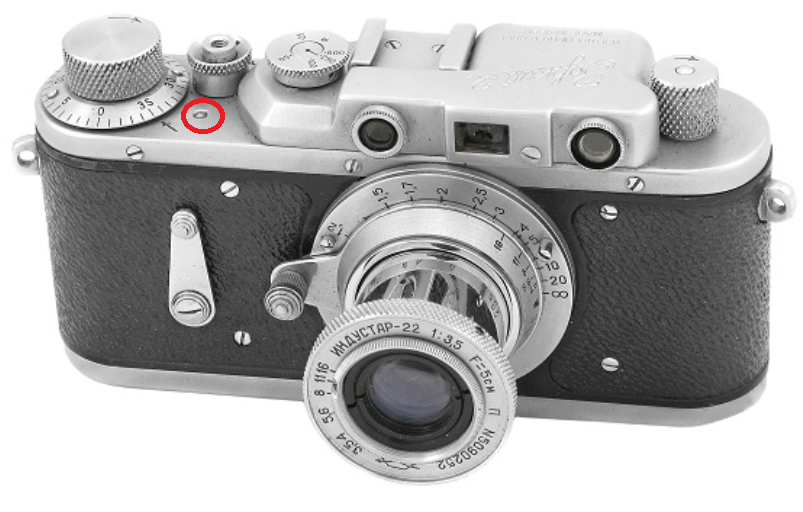

Hi Antonio,
Difficult to be affirmative about your camera. But it can be a Zorki 1 modified into a Zorki 2... Not very difficult to put a Zorki 1 cover on a Zorki 2 body...
About the selftimer button, it should be a Fed 3 or 4 one. Anyway, by comparison, the mechanism looks like a Zorki one (position of the release button). As for the Inside, no doubt it is a Zorki 2's one.

The camera is definitively a Zorki 2 (According to date of production and rewind system around the shutter release).
The camera received a Zorki 1 top and a lever of new style.

A couple more modifications...

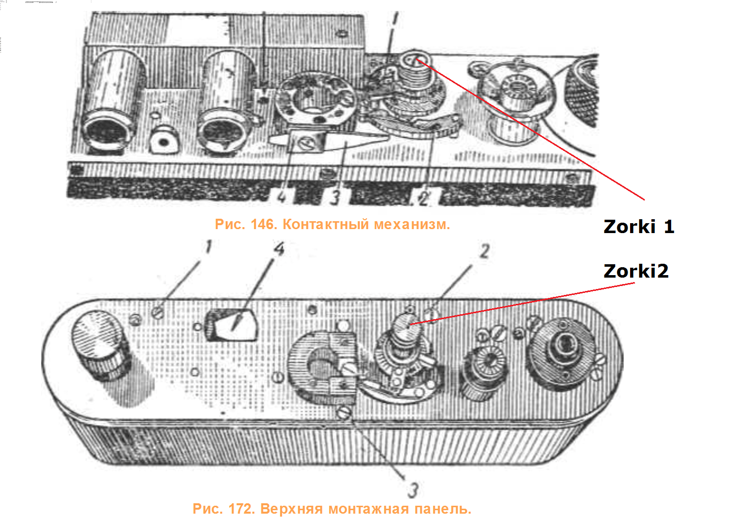

Zorki2's have a two-piece speed dial, ala Zorki-C & 2-c
Bottom plate is from a FED or early Z-1
Scalloped shutter release spring on bottom is from Zorki 2-c
Cheers, Geoff
Of course, Luiz, up to the pin, but not up to some other details...Big smile
This camera is not an original Zorki 2 and Antonio's question is valid.
I specially wonder about the speed dial: it's a "normal" Zorki one. Does it mean something about the internal selector mechanism? I should have a look inside my own Zorki 2-s ...

But I am a bit surprised. On Leica type cameras, it is necessary to cock before changing the speed. No importance on Zorki 2 ones (I have just checked). Strange if there is no other modification...
