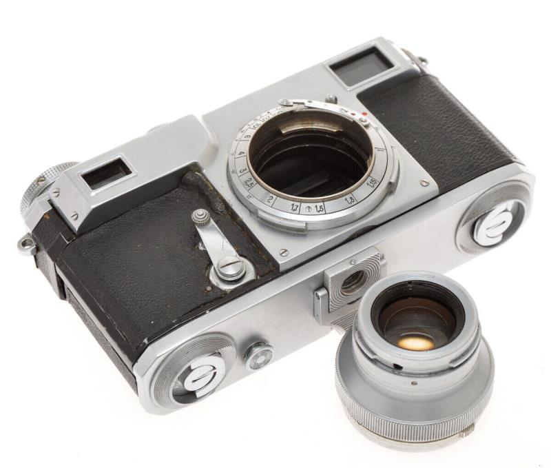

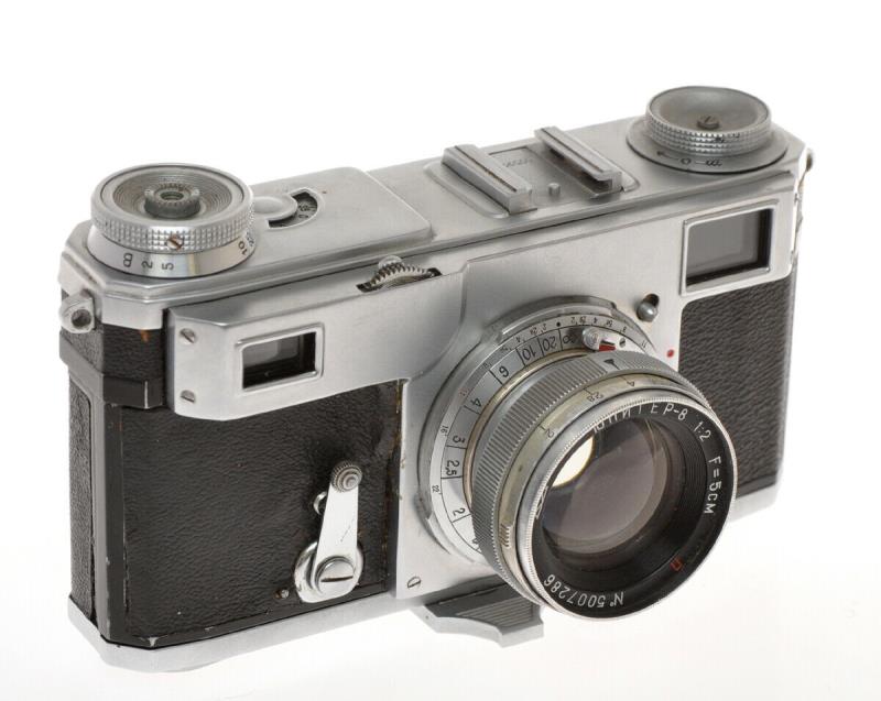

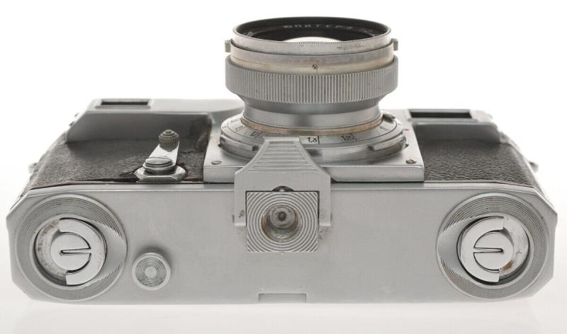

It would have been a big news!
/UserContent2/4112019_505990 1.jpg
http://www.ussrphoto.com/UserContent2/4112019_505990 1.jpg
/UserContent2/4112019_505990 5.jpg
http://www.ussrphoto.com/UserContent2/4112019_505990 5.jpg
On the seller's photos, there were different details which showed that this camera had Contax parts, which is always interesting. And about the "no name" front plate, the cut for the tripos socket was clearly visible:

Thank you Jacques! yes most definitely the front plate is from the no-name 4a as the cut indicates. I believe I've seen this one for sale [:)]. Decided to pass on it just for this reason.

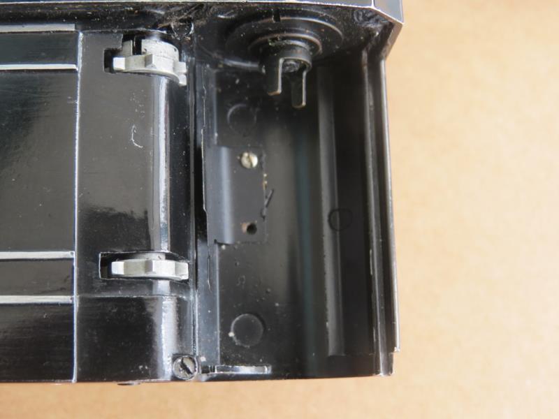

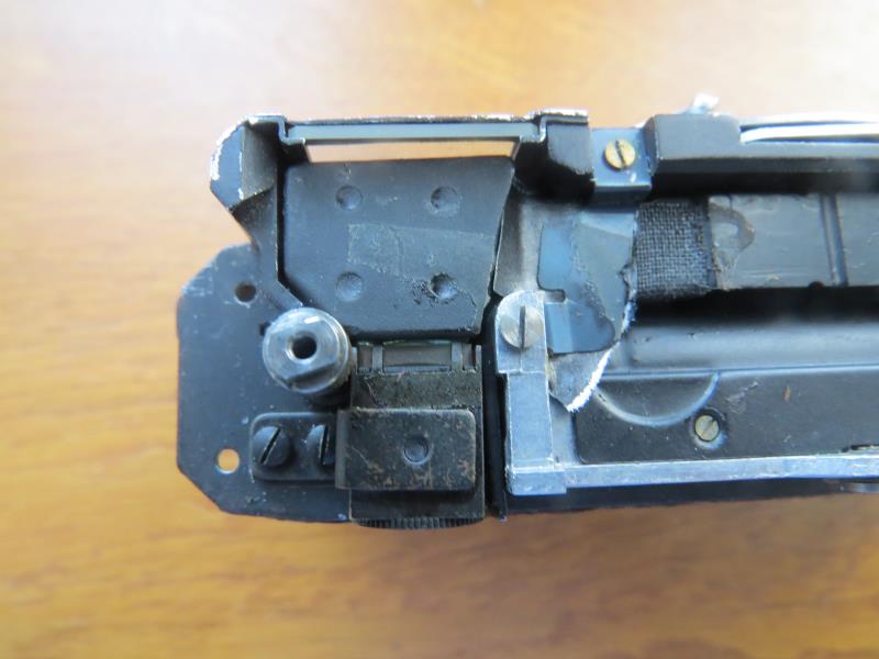

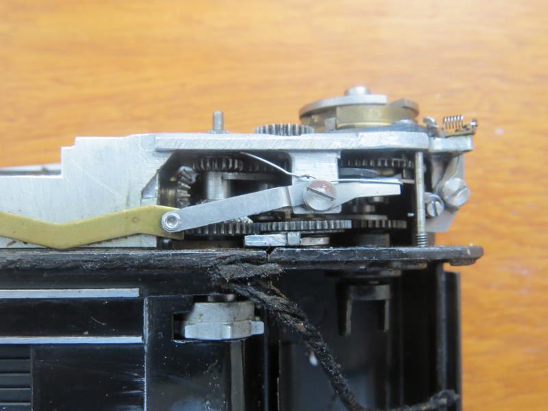

So, I bought it, mainly because I had spare parts of my 1950 Kiev, including a correct front plate.
The partial taking to pieces was easy, and showed that the camera was mainly made of Contax parts: mechanism, curtains, viewfinder/rangefinder ...

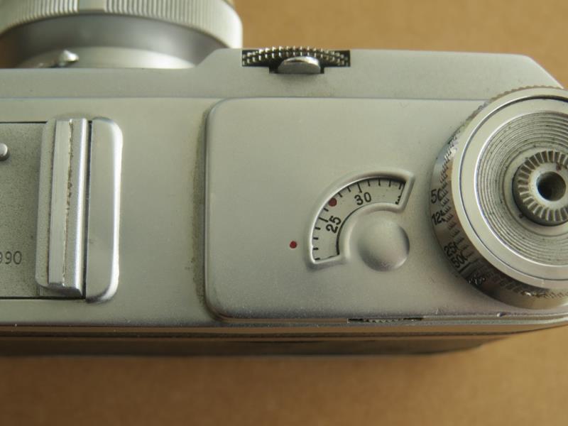

... the casting and some external details.

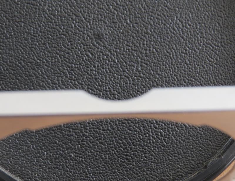

Specially for Vlad [:)]: the cut on the front plate (a bit blurred)

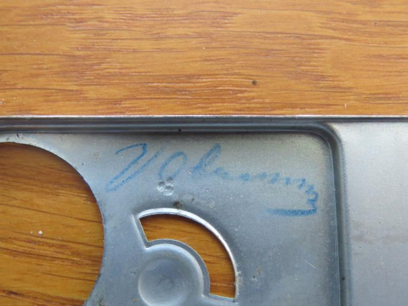

And a blue name behind the upper plate: probably a signature?

By whom and when was it mounted? Impossible to say. There is no marking inside; specially the Kiev number engraved near the finder is absent. No Contax engraving, either. This camera is blind, if I except the blue signature.

Thank you Jacques! very interesting! It is indeed probably technician's signature on the inside! No name plate it's either to fool a buyer or as a repair but it had to be outside of USSR since these plates were exported. It was noticeable right away that the front cover was taken off because the leather was peeling off on the "bump" in the corner. Number 1 sign of tampering with Kievs [:)].

just a hint: the blue inscription, to me it's german and says "Verbesserung" which is improvement in english. whatever this means...

The second letter could be an "E" or an "O" and the next one a "B" but the "R" is missing. The last letter may be a "G" but for me it looks more like a "Z". Just my 2 cents.

it seems to be this handwriting quite common before and just after WWII in germany, a mixture between latin and german (Sütterlin) letters. yes, it could also be an "o", but it seems to me, that someone writing an "e" got stuck in the 3 lttle grooves and so lost the "r" in the grooves. he started with the "b" again. the end could be as well a "g" as a "z", you are right...

Thanks, Reinhard and Guido for your efforts. The idea of "Verbesserung" is interesting... A pity we cannot be sure of the translation.

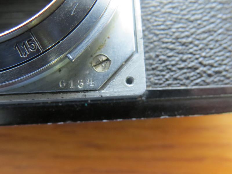

I had forgotten the bayonet mount:
/UserContent2/4112019_IMG_2297.JPG
http://www.ussrphoto.com/UserContent2/4112019_IMG_2297.JPG
Number on the right lower corner + flat top on "3" on the distance scale = Dresden Contax style, once more, by Sasaki's book. Not completely exceptional for a 1950 Kiev II, but at least interesting.

wow it looks like something in Russian to me that I could not read, didn't even think it was German! [:)]. Ulrich, i also heard of a common practice in USSR of technicians to take parts home and then assemble a working camera for themselves... this may be this case..
