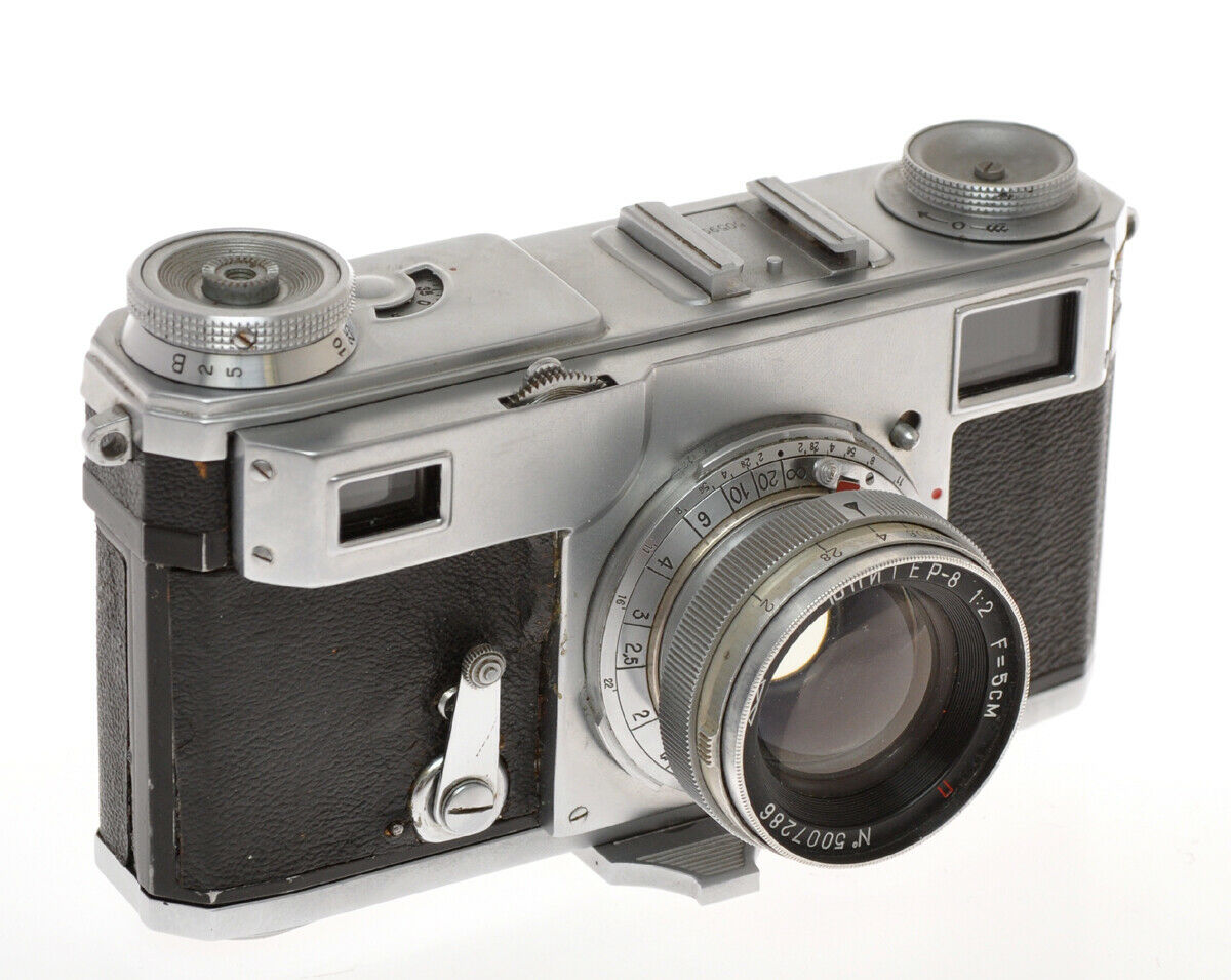

On the seller's photos, there were different details which showed that this camera had Contax parts, which is always interesting. And about the "no name" front plate, the cut for the tripos socket was clearly visible:
Thank you Jacques! yes most definitely the front plate is from the no-name 4a as the cut indicates. I believe I've seen this one for sale Smile. Decided to pass on it just for this reason.
So, I bought it, mainly because I had spare parts of my 1950 Kiev, including a correct front plate.

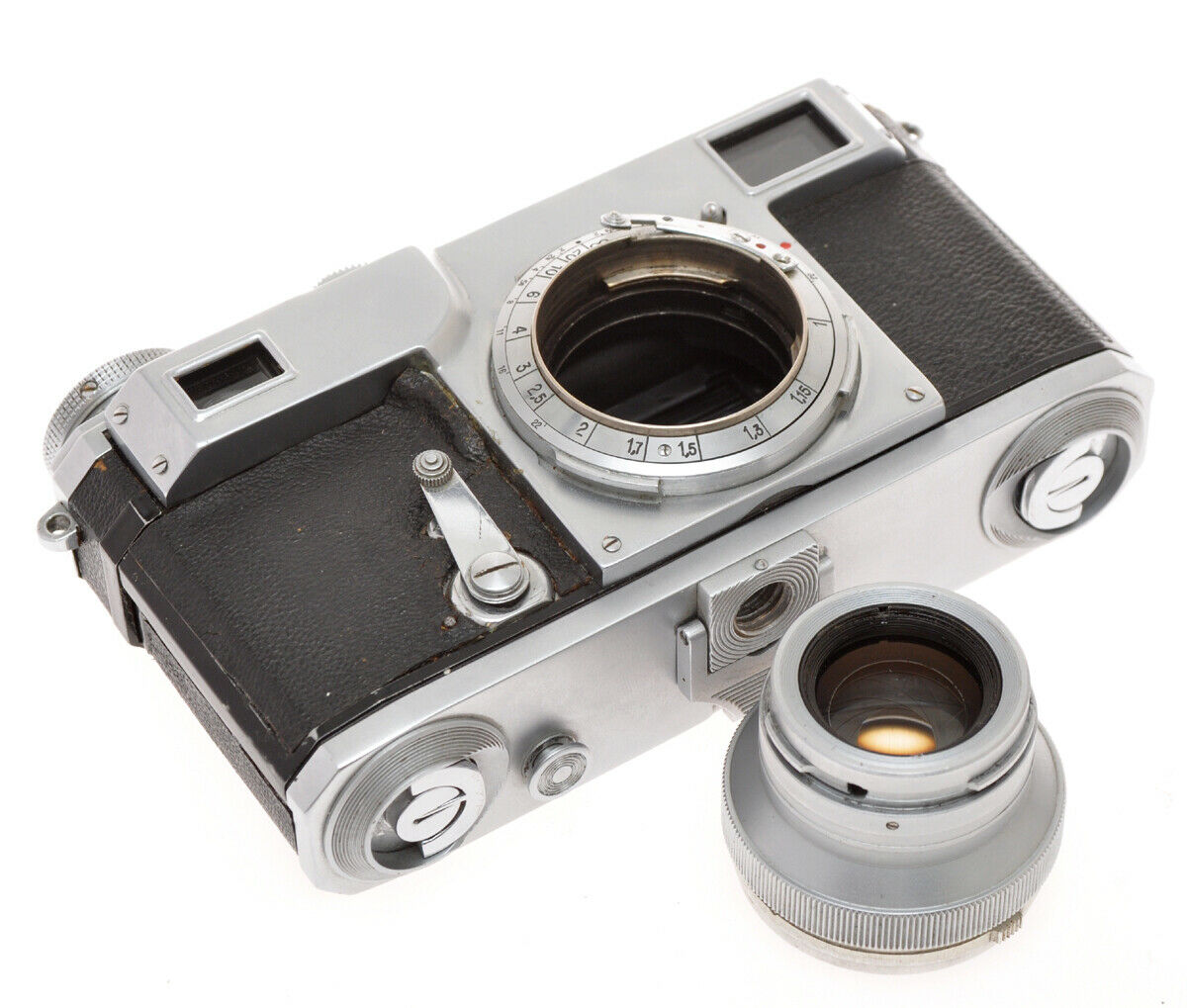

The partial taking to pieces was easy, and showed that the camera was mainly made of Contax parts: mechanism, curtains, viewfinder/rangefinder ...
... the casting and some external details.

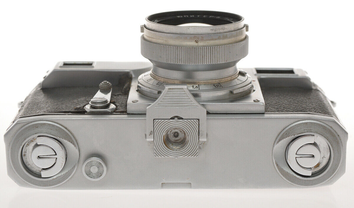

Specially for Vlad Smile: the cut on the front plate (a bit blurred)

Thank you Jacques! very interesting! It is indeed probably technician's signature on the inside! No name plate it's either to fool a buyer or as a repair but it had to be outside of USSR since these plates were exported. It was noticeable right away that the front cover was taken off because the leather was peeling off on the "bump" in the corner. Number 1 sign of tampering with Kievs Smile.
