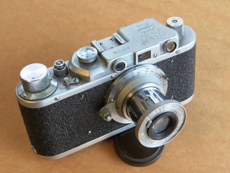

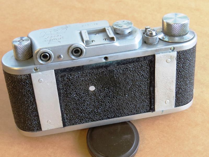

I have bought lately a Fed-Zorki (one more!) mainly because of its back (and secondly because I had a 1948 1,5/5cm ZK to put on).
Here it is:
/UserContent2/16122019_IMG_2445.JPG
http://www.ussrphoto.com/UserContent2/16122019_IMG_2445.JPG
First surprise: my ZK lens does not have the right position on it (infinity at 3 o'clock rather than 12). The mount seems in correct position. So, rather than turning the lensplate, I have put an Industar Moskva "tomb" which was waiting for a body too...
Replied on: 20191216095632

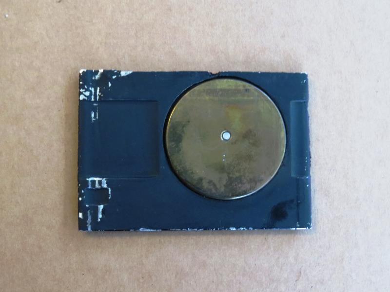

Here is the back:
/UserContent2/16122019_IMG_2447.JPG
http://www.ussrphoto.com/UserContent2/16122019_IMG_2447.JPG
It looks like a home made work, probably for a special work.
The back was partially cut, then replaced with foam to avoid any entry of light. The hole in the center is right in the middle of the film plate. Certainly a possibility to regulate the register. But for which type of work?

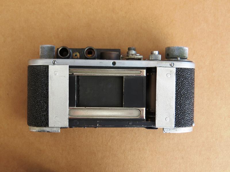

So, I have taken to pieces this strange early Fed-Zorki.
As it can be foreseen, the back is removable. I did not want to force, and it is tightly mounted.
/UserContent2/912020_IMG_0023.JPG
http://www.ussrphoto.com/UserContent2/912020_IMG_0023.JPG
Replied on: 20200109090119
The press film is directly rivetted to the back. So, no spring behind, and I have measured a register strictly at 28,8mm (there are important variations on pre-war Feds).
/UserContent2/912020_IMG_0011.JPG
http://www.ussrphoto.com/UserContent2/912020_IMG_0011.JPG
A important correction is made on the lens plate which is thicker than usual.

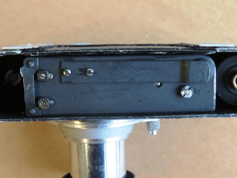

Replied on: 20200109090754
The two aluminium plates which guide the removable back are rivetted on the body.
/UserContent2/912020_IMG_0014.JPG
http://www.ussrphoto.com/UserContent2/912020_IMG_0014.JPG
Light tightness is fastened through velvet bands glued to the removable part.

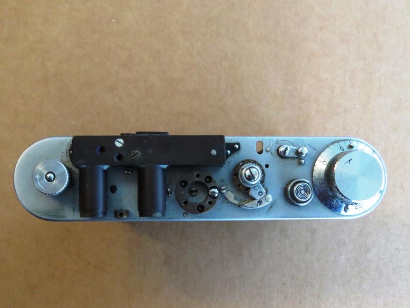

All the rest of the camera is ordinary, with a hole on the upper plate for a connexion towards the low speed spring, like on many pre war Feds. This plate could come from Fed parts, unless the early Zorkis have this same hole (I have not checked)...
/UserContent2/912020_IMG_0009.JPG
http://www.ussrphoto.com/UserContent2/912020_IMG_0009.JPG

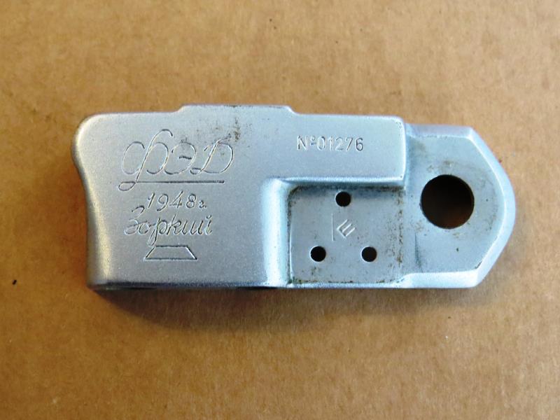

And a photo of the cover, just for the alphabetical mark.
/UserContent2/912020_IMG_0018.JPG
http://www.ussrphoto.com/UserContent2/912020_IMG_0018.JPG

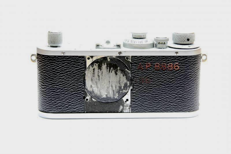

So, why this removable back? Which special use? Army?
I own a Reid which has a round opening on the back. This Reid was prepared to use on submarine periscopes.
/UserContent2/912020_Reid 2208 2.jpg
http://www.ussrphoto.com/UserContent2/912020_Reid 2208 2.jpg

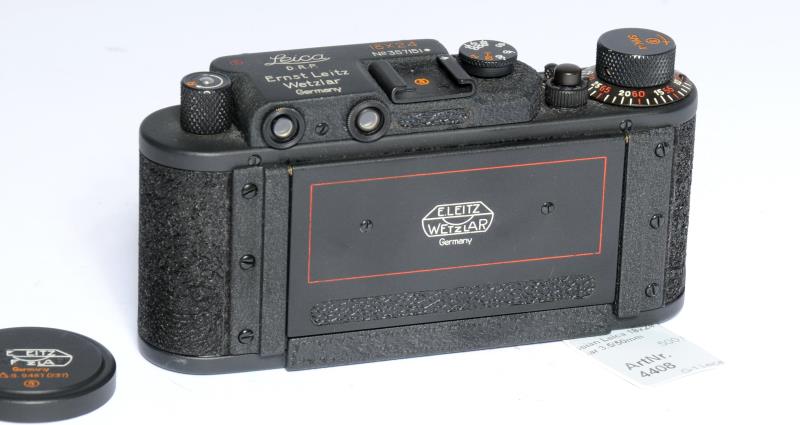

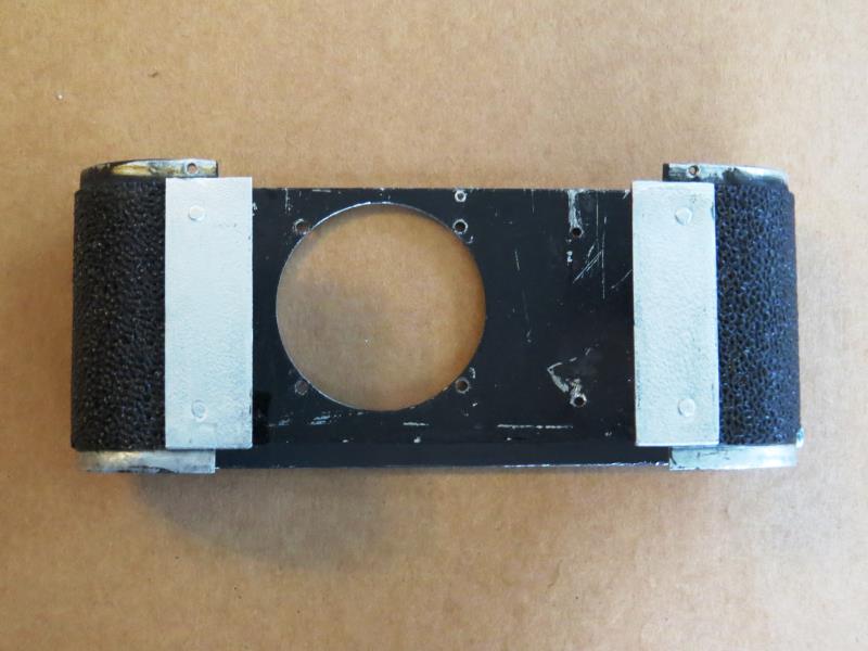

Replied on: 20200124102454

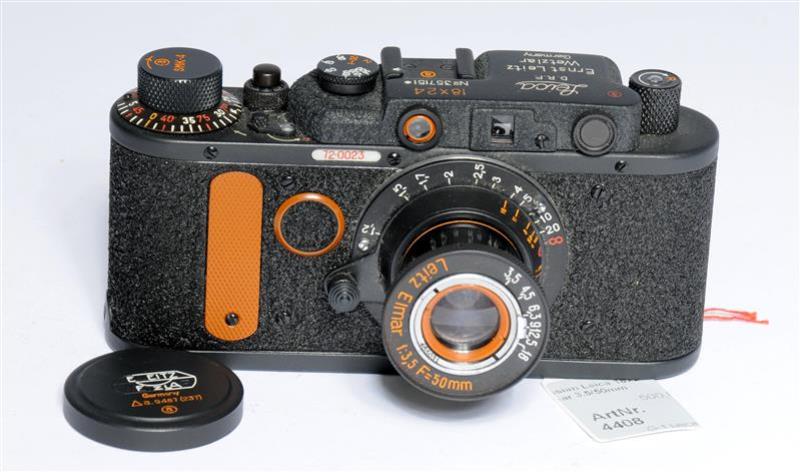

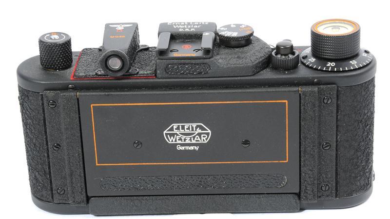

I have just found again photos of a Leica fake with a flapping door. And it is a half format. What a work! (photos Cameraquest)
/UserContent2/2412020_leica 72 fake 1.jpg
http://www.ussrphoto.com/UserContent2/2412020_leica 72 fake 1.jpg
/UserContent2/2412020_Leica 72 fake 5.jpg
http://www.ussrphoto.com/UserContent2/2412020_Leica 72 fake 5.jpg
Replied on: 20200124104954
whoa that's an interesting fake! The top cover was completely custom manufactured!
Reply author: Guido

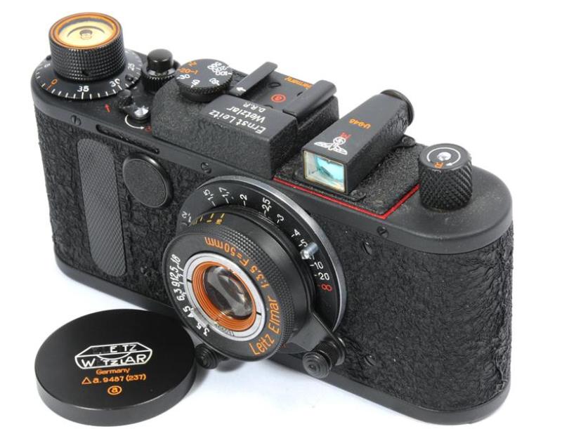

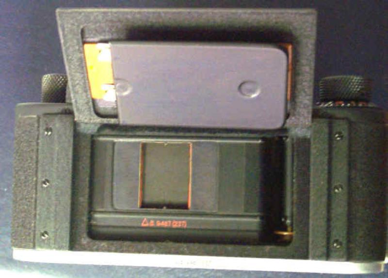

Replied on: 20200125031332

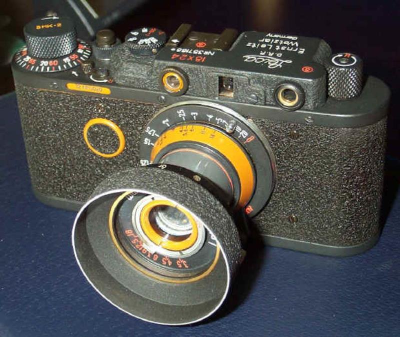

Hello friends of fakes
From the same workshop this two other fakes:
Another Leica 72 fake with a different serial number seen in 2016:
/UserContent2/2512020_Leica 72 357151, front.jpg
http://www.ussrphoto.com/UserContent2/2512020_Leica 72 357151, front.jpg
/UserContent2/2512020_Leica 72 357151, back.jpg
http://www.ussrphoto.com/UserContent2/2512020_Leica 72 357151, back.jpg
And this not so colorful Leica I seen in 2014:
/UserContent2/2512020_Leica Standard 0017, front-top.jpg
http://www.ussrphoto.com/UserContent2/2512020_Leica Standard 0017, front-top.jpg
/UserContent2/2512020_Leica Standard 0017, back.jpg
http://www.ussrphoto.com/UserContent2/2512020_Leica Standard 0017, back.jpg
The Leica 72 with the serial number 357166 that Jacques has shown was sold in 2010 as far as I know. The workshop was located in Moscow and once an article about the maker was publicated in a collectors magazine.
