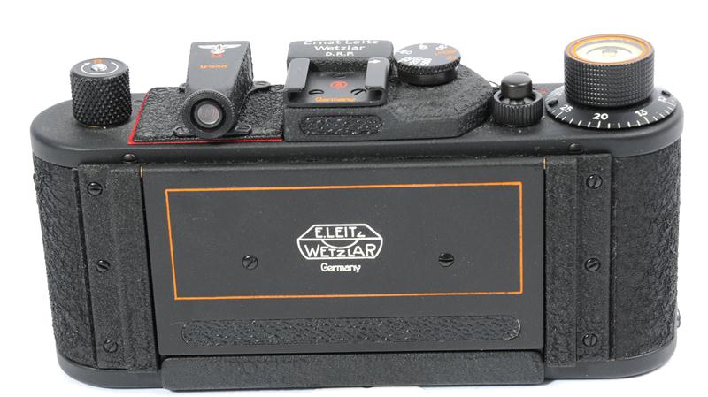

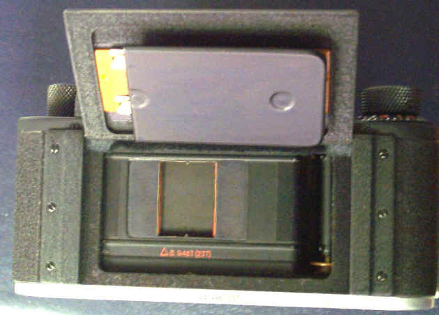

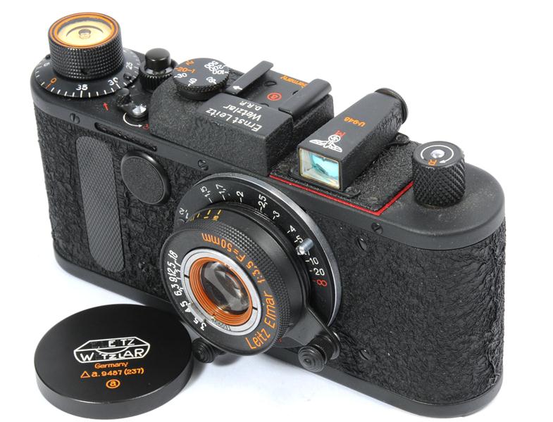

I have just found again photos of a Leica fake with a flapping door. And it is a half format. What a work! (photos Cameraquest)
whoa that's an interesting fake! The top cover was completely custom manufactured!

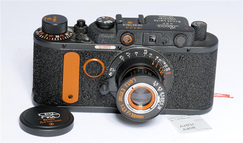

Hello friends of fakes

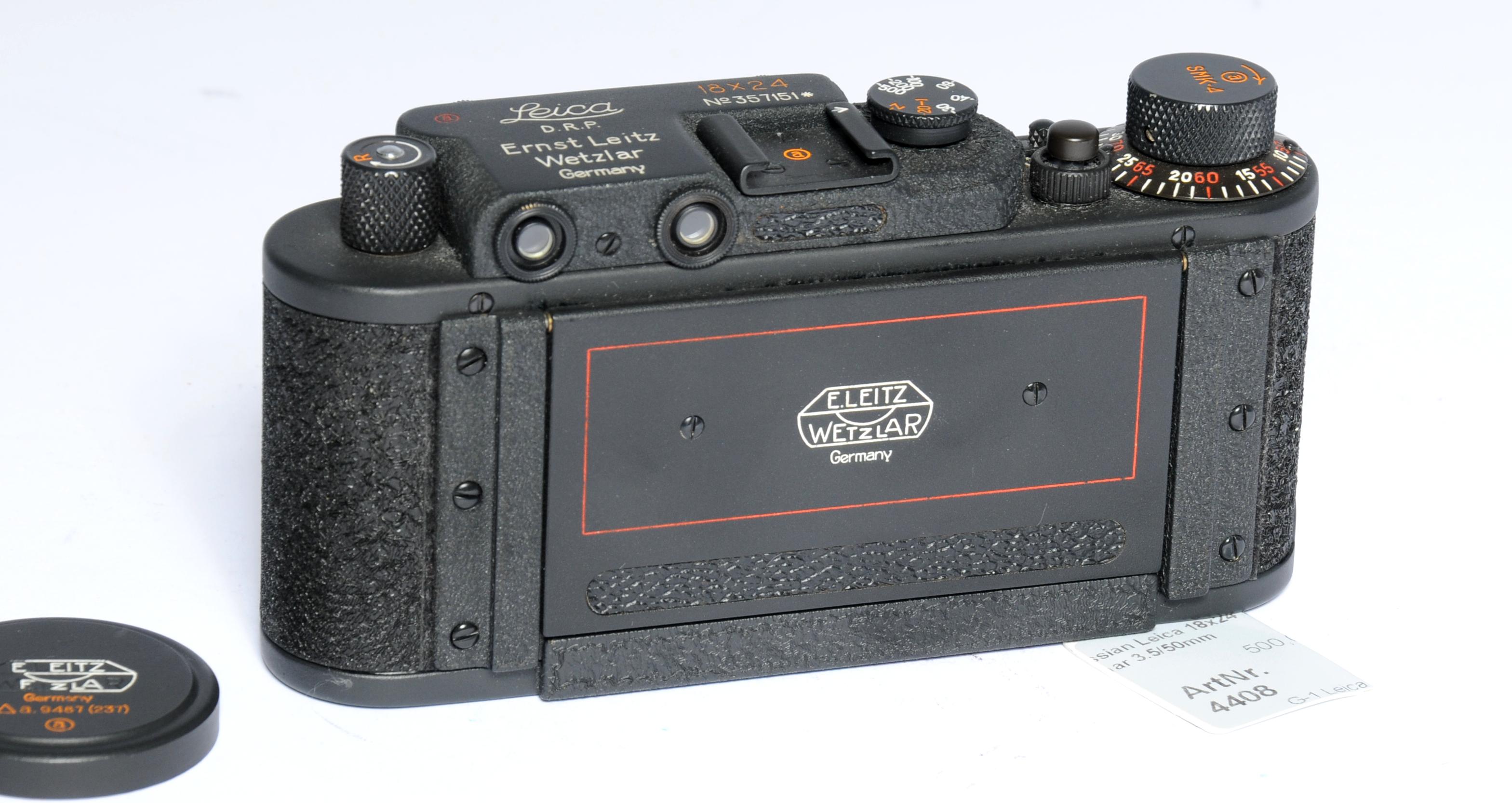

From the same workshop this two other fakes:

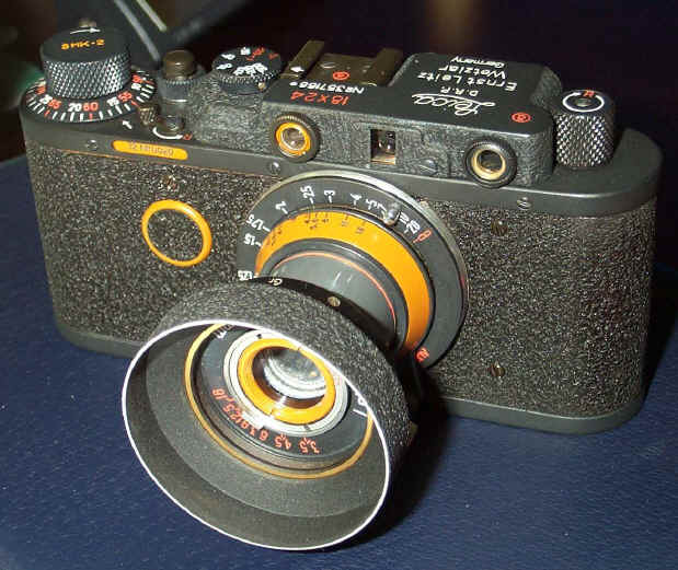

Another Leica 72 fake with a different serial number seen in 2016:

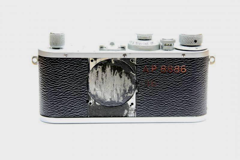

And this not so colorful Leica I seen in 2014:
The Leica 72 with the serial number 357166 that Jacques has shown was sold in 2010 as far as I know. The workshop was located in Moscow and once an article about the maker was publicated in a collectors magazine.
