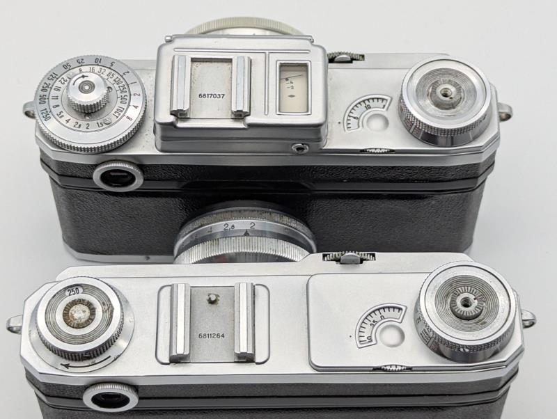

I have also such Kiev-4 s/n 6817037. Regarding the case with "50 years..." I have a doubt, that it has something to do with this camera. I would expect some plate on the camera, such as "70 years..." on Kiev-19. It was absolutely common thing in the Soviet Union to put some soviet badges on the leather cases of different devices.
May be I am wrong, but I have never seen any other information except this case (it was rather long time on ebay).
If anyone has any it is very appriciated [:)].

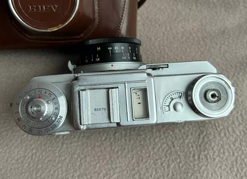

So, I have found three of these cameras without logo on the clip:
- a Kiev 4a # 6806307 (sold),
- two Kiev 4 # 6816322 and 6816711 (both mine). I will post photos when they are here.
Alexander, your # 6817037 has such a clip too?
Thanks to you and Juhani. We hope for other information and serial numbers!

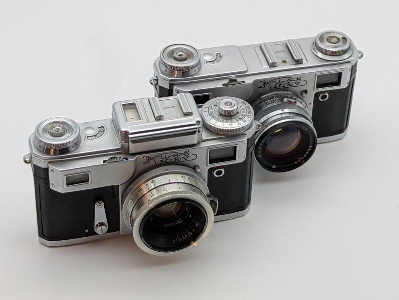

Well, I have got today the second camera from 1968. It is Kiev-4a and also without any logo or "made in..." on the clip.
Here are my cameras:
/UserContent2/432025_Kiev-1968-1.jpeg
/UserContent2/432025_Kiev-1968-2.jpeg
Replied on: 20250304152617
Very interesting. Thanks, Alexander.
I have not yet received my own ones.
So, we have now at least five 1968 Kievs without engraving on the clip (except the serial number).
Of course, it would be interesting to know if there are such other cameras. And I look for 1968 Kievs with "normal" clips: that can be useful too.

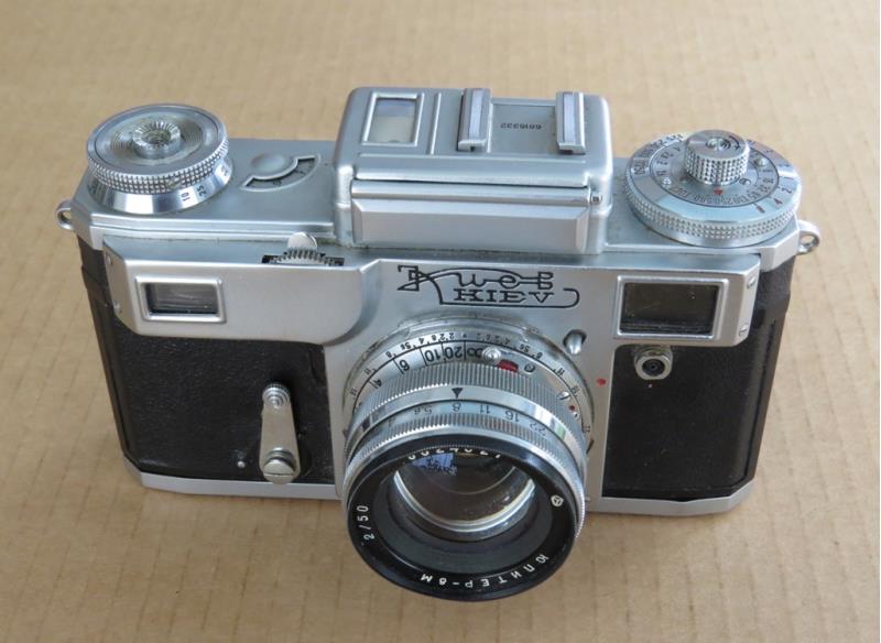

The Kiev 4 s/n 6816332, without logo too, is here.
/UserContent2/2632025_IMG_1871.JPG
http://www.ussrphoto.com/UserContent2/2632025_IMG_1871.JPG
I am going to put that in the wiki. Thanks for your remarks!
