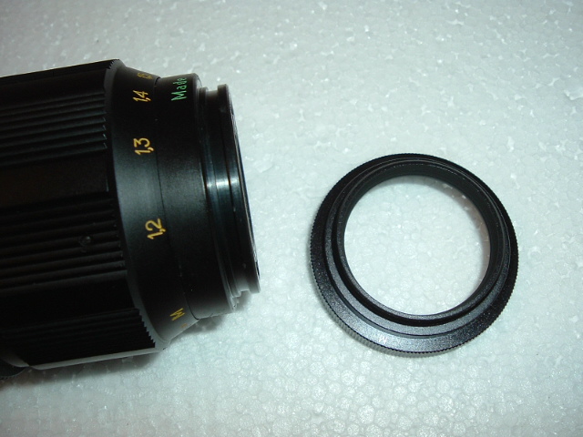

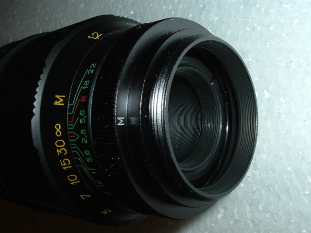

I'm little bit confused about this. Let me post pictures:
http://www.ussrphoto.com/UserContent/DSCF6258.JPG
See Juhani this is M on the thing. And thred, but not M42
Then I take out 3 screws and took off this M adapter:
http://www.ussrphoto.com/UserContent/DSCF6259.JPG
Now I supouse I can put real M42 adapter(have to find one:) on it place.
Please Juhani tell what is called T2? Is it adapter what I took off? If it does not go to any camera then why the heak KMZ put it on??? And box say lens for camera Zenit:
http://www.ussrphoto.com/Wiki/default.asp?WikiCatID=28&ParentID=2&ContentID=780&Item=Tair+11A
Of cause box may be not original. Who know what they selling on eBay this days? [:0]

My opinion is that you need T2 or T4-adapter, and "M42" for usual Zenits with M42. 11A should be delivered with at least one adapter but who knows it it has gotten lost?
But what about focus, did you try it? That would make it certain. Put lens on infinity, then look through finder. If you must hold the lens approx 5mm away from camera to have sharp infinity then the case is solved: you need the T2-/T4-adapter. Think of it as a 5mm extension ring, but lens-thread has another pitch.

I did this experiments. Without adapter as you Juhani predict I need about 5mm to focus to infinity. So I'll need T2/T4 adapter for this lens. That is right!
But what should I do with existing adapter? I mean what camera can it go to? Could it be that KMZ put defective adapter on the lens? Hard to believe in this [:)]
Replied on: 20080213233039
It goes to nothing, but it must be there for the T2-/T4-adapter. Actually you do NOT have any adapter at all now!

Excuse but all of you are competely in a mistake!
The lens does not accept any T2 T4 or any other adapter!
the lens says "A" so it receives an "A" adapter. a Russian Standard!
Those "A" adapters were and are made in "M39" Old Zenits, "M42"New Zenits, "K" called "Patriot K" slighly different but comptible with Pentax K and "N" Nikon mount for Kiev 17 on, and are regularly sold by Rugift, Poisk and other companies.
As it was shown by the pictures this fall apart "A" adapter is an "M42" one. If you cant fit in your camera anything goes wrong, possible a damaged thread. This is very easy to solve.
There is sold in automobile repair shop stuff an special grease with thin carborundum emeril particles. This is used for rectifying motor valves seats in order to repair possible pressure leaks. A small quantity of this grease and a to-and-fro in the threads (camera nad lens) will put your lens in perfect shape! Danger put this grease on the lens surface! serious scratches can be done. So clean area wit a drap of tissue, immediatly after the thread is fitting well.
