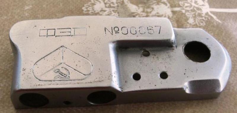

That said, I wonder (just a little!)... On my s/n 00067, some parts don't come from Fed's: the view counter (pins between 10/15 and 30/35) and the speed dial, with a different engraving. And the 00004 (on Abramov's and Luiz's sites) has exactly the same replacing parts, as if they had missed when mounting the camera and the factory (or the forger?) had to re-make them...
Here is a photo of the seller (The camera is not yet here)
http://www.ussrphoto.com/resize/resize_image.aspx?ImgWd=800&IptFl=/UserContent/3062015_Fed Arsenal 1.jpg
http://www.ussrphoto.com/UserContent/3062015_Fed Arsenal 1.jpg
Any ideas? Do we know other Fed Arsenal cameras now?

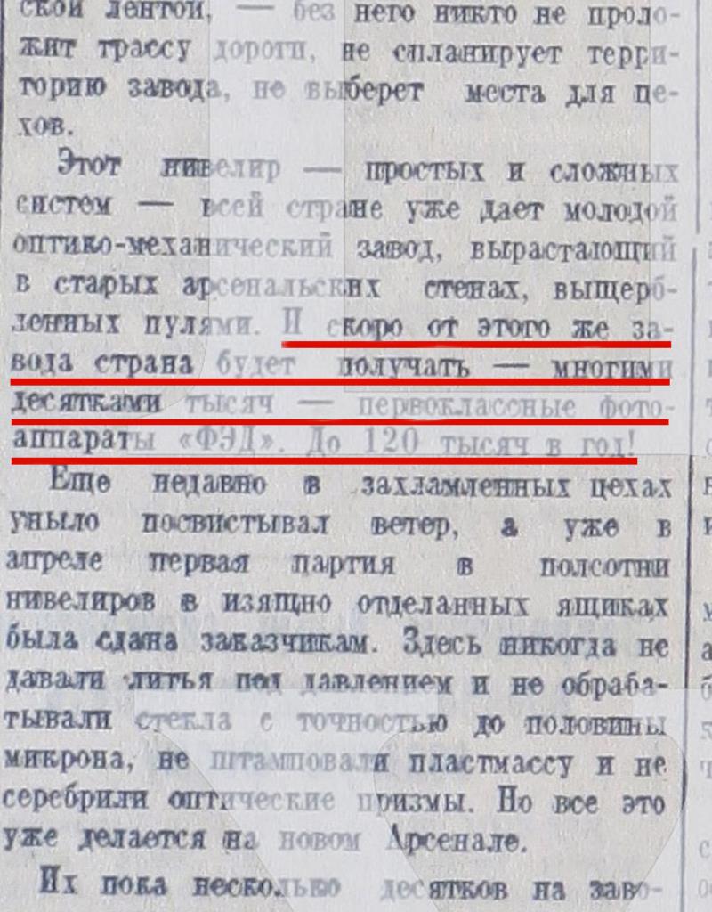

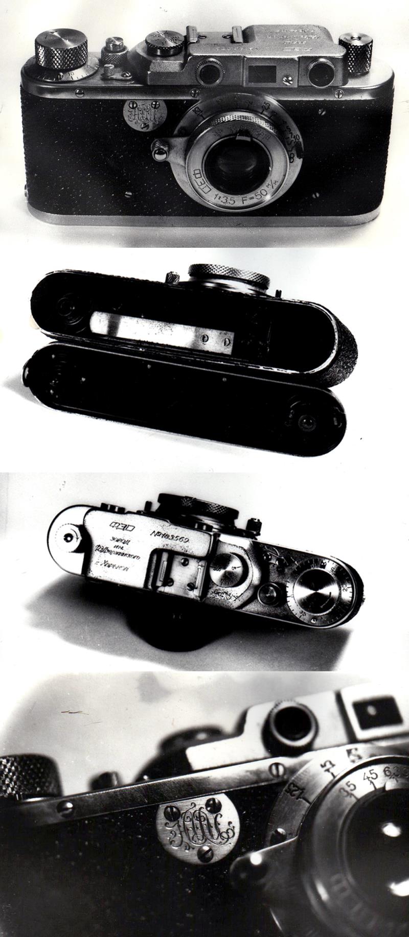

here's what I know about it:
Georgiy Abramov writes the following: "Based on some unsubstantiated claims, right after the war a small batch of the FED-1's was made on Arsenal and had a KMZ optics". See link below and there's a picture of another one there:
http://www.photohistory.ru/1211830320838208.html
The image is this one:
http://www.photohistory.ru/Pictures/FED-arsenal.jpg

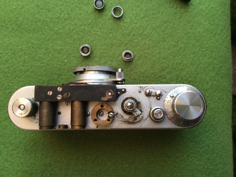

I have just received the camera. I can confirm it was originally a 1940/41 Fed:
- there is no hole in the press film (after c. s/n 150000)
- the release button is of the 1d/1e type,
- the two plates are made of iron. It was not the case before the s/n # 150000, it will not be the case for the postwar Fed, including my Red Flag (checked with a magnet).
So, I think this camera could be a genuine Fed-Arsenal, if these cameras ever existed...[:)]

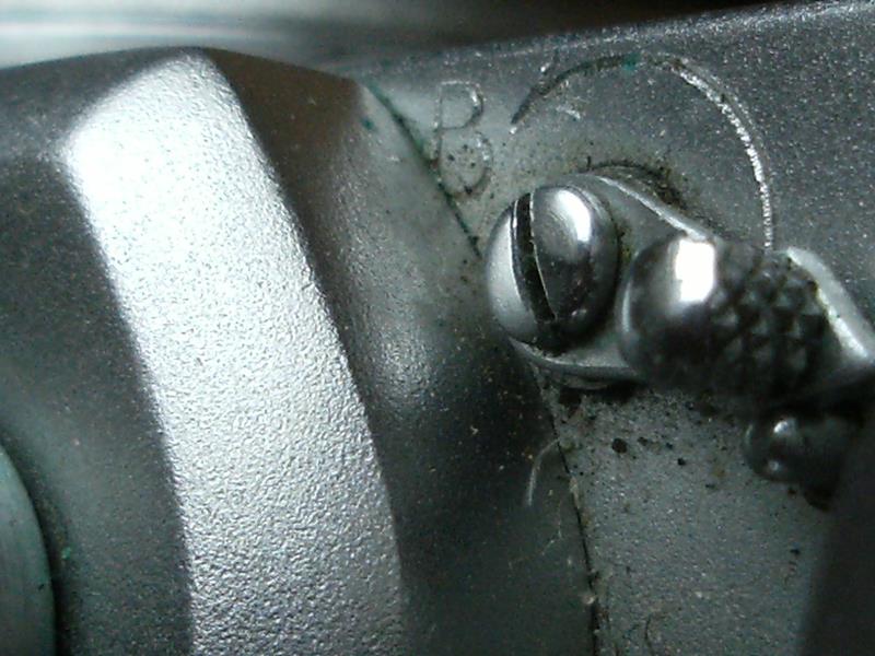

The speed dial has engravings never seen on Feds.

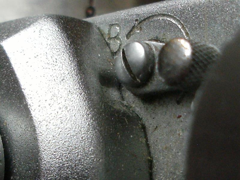

Replied on: 20150704155651

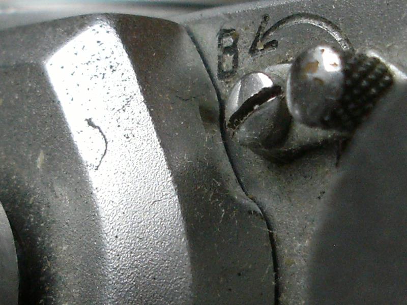

The winding button has an unusual arrow and the frame counter has original engravings and a special position of the pins: between 10/15 and 30/35 rather 15/20 and 0/35:
http://www.ussrphoto.com/resize/resize_image.aspx?ImgWd=800&IptFl=/UserContent/472015_DSCF2168.JPG
http://www.ussrphoto.com/UserContent/472015_DSCF2168.JPG
http://www.ussrphoto.com/resize/resize_image.aspx?ImgWd=800&IptFl=/UserContent/472015_DSCF2167.JPG
http://www.ussrphoto.com/UserContent/472015_DSCF2167.JPG

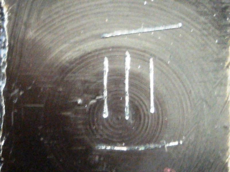

An inscription under the pressure plate:
http://www.ussrphoto.com/resize/resize_image.aspx?ImgWd=800&IptFl=/UserContent/572015_DSCF2178.JPG
http://www.ussrphoto.com/UserContent/572015_DSCF2178.JPG

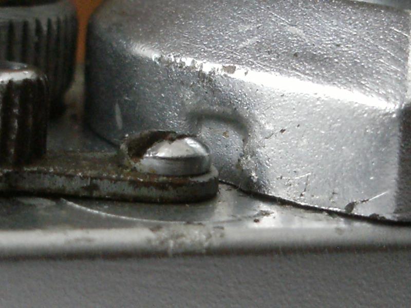

And rust on the upper plate:
http://www.ussrphoto.com/resize/resize_image.aspx?ImgWd=800&IptFl=/UserContent/572015_DSCF2170.JPG
http://www.ussrphoto.com/UserContent/572015_DSCF2170.JPG
A former owner tried to hide rust with metallic paint...

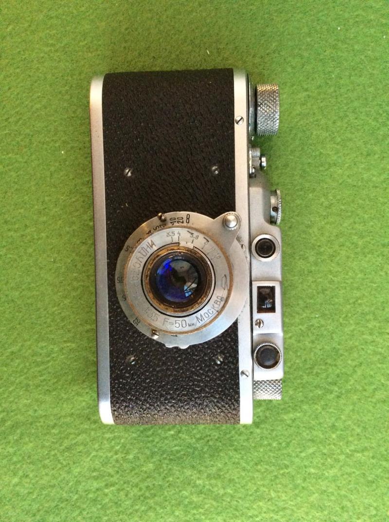

Two last photos: the camera is re-mounted.
I have put an early Industar Moscow "tomb" which is not in the good position. After checking, the lens plate is not of Fed origin: it does not have the marking at 9 o'clock. I don't know for which lens this lens plate was made.
http://www.ussrphoto.com/resize/resize_image.aspx?ImgWd=800&IptFl=/UserContent/572015_DSCF2187.JPG
http://www.ussrphoto.com/UserContent/572015_DSCF2187.JPG
http://www.ussrphoto.com/resize/resize_image.aspx?ImgWd=800&IptFl=/UserContent/572015_DSCF2190.JPG
http://www.ussrphoto.com/UserContent/572015_DSCF2190.JPG
Replied on: 20150705114738
In fact, it's a Fed 2/50mm lens which fits.
It will stay with that lens: it looks well.
http://www.ussrphoto.com/resize/resize_image.aspx?ImgWd=800&IptFl=/UserContent/572015_DSCF2191.JPG
http://www.ussrphoto.com/UserContent/572015_DSCF2191.JPG

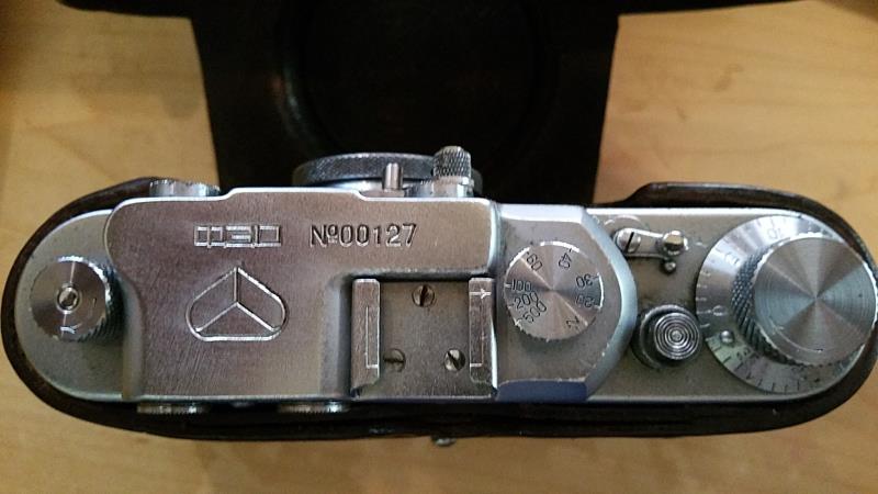

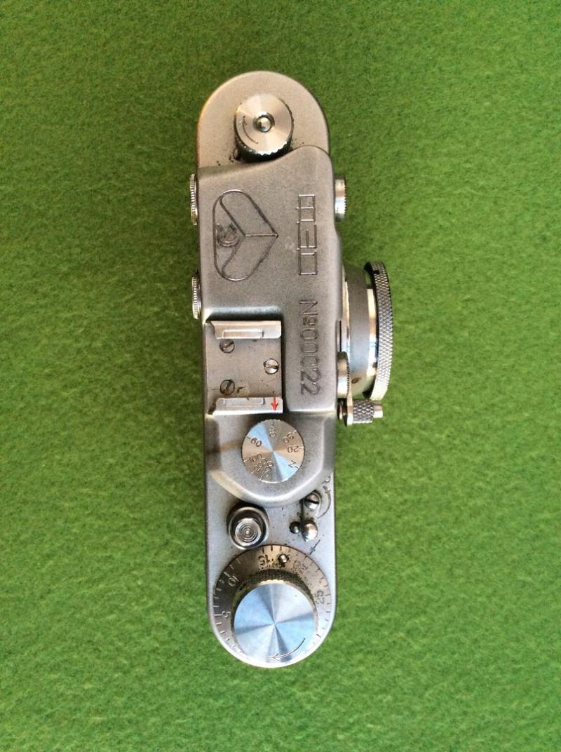

I know that this sounds silly and you may not trust me since I cannot provide any documentation. Remember that Arsenal is strictly secret object even today and its archive is closed for any research. Almost everything that I could find about the early post-war period of Arsenal comes from the Zeiss Jena archives.
I told Jacques about the existence of this camera for a long time ago and I think he still does not believe in its originality[;)] despite he managed to buy one.

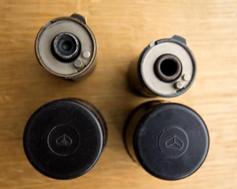

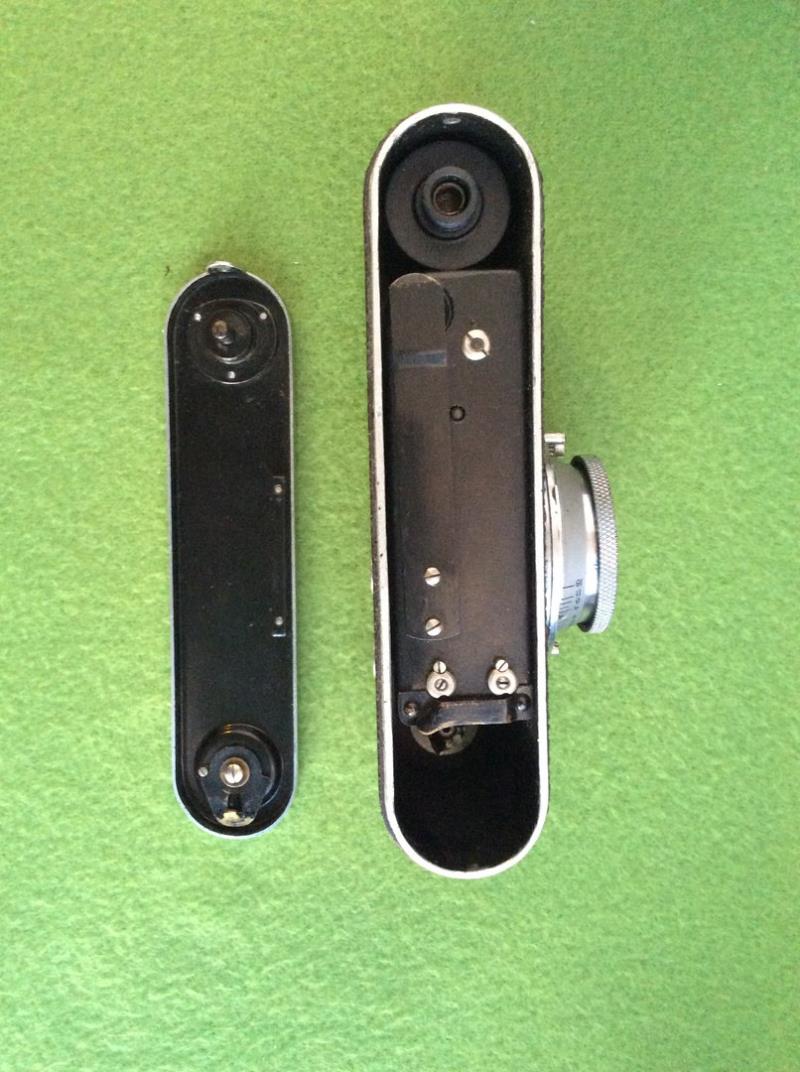

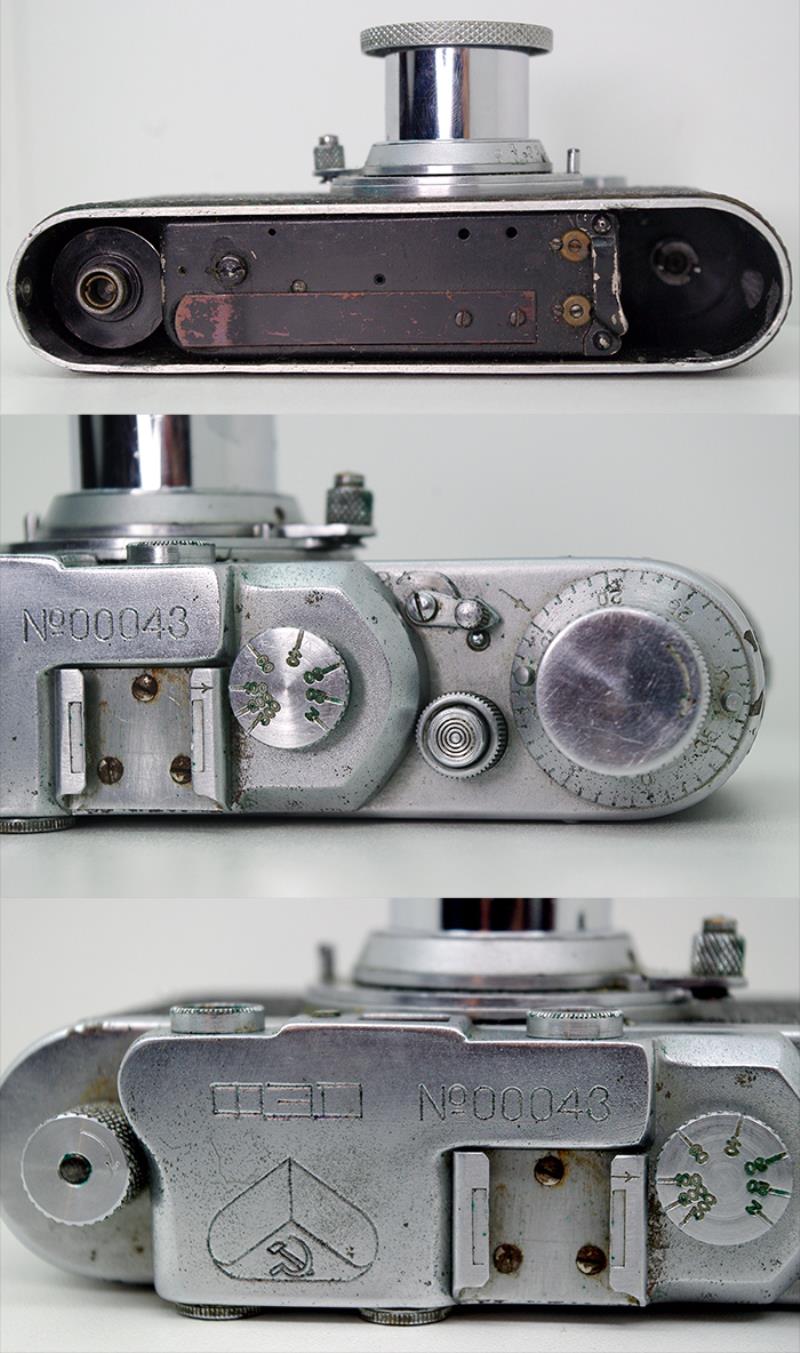

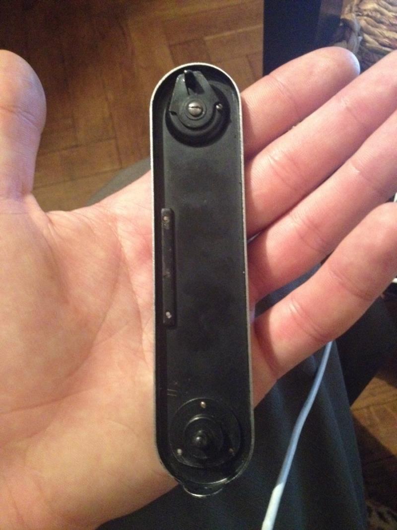

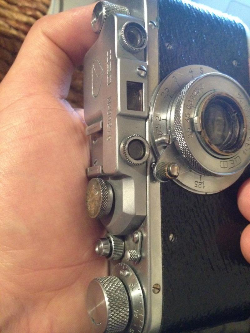

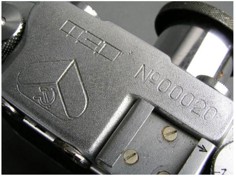

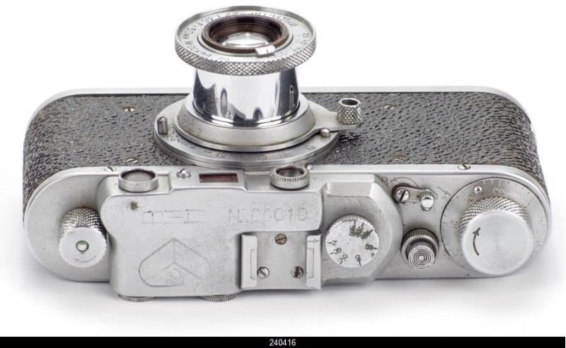

Concerning the second type of the FED Arsenal I put some photos with the agreement of the owner. I know the history of how this particular camera has found the new owner and I have no doubts about its originality (I will not tell you explicitly where this camera were previously but you can easily guess why I am so sure)
http://www.ussrphoto.com/resize/resize_image.aspx?ImgWd=800&IptFl=/UserContent/1372015_2.jpg
http://www.ussrphoto.com/UserContent/1372015_2.jpg
http://www.ussrphoto.com/resize/resize_image.aspx?ImgWd=800&IptFl=/UserContent/1372015_3.jpg
http://www.ussrphoto.com/UserContent/1372015_3.jpg
http://www.ussrphoto.com/resize/resize_image.aspx?ImgWd=800&IptFl=/UserContent/1372015_5.jpg
http://www.ussrphoto.com/UserContent/1372015_5.jpg
http://www.ussrphoto.com/resize/resize_image.aspx?ImgWd=800&IptFl=/UserContent/1372015_7.jpg
http://www.ussrphoto.com/UserContent/1372015_7.jpg
http://www.ussrphoto.com/resize/resize_image.aspx?ImgWd=800&IptFl=/UserContent/1372015_8.jpg
http://www.ussrphoto.com/UserContent/1372015_8.jpg

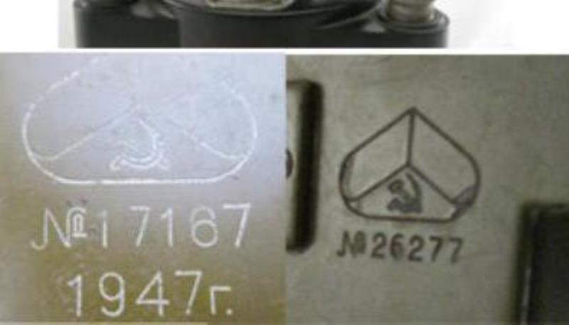

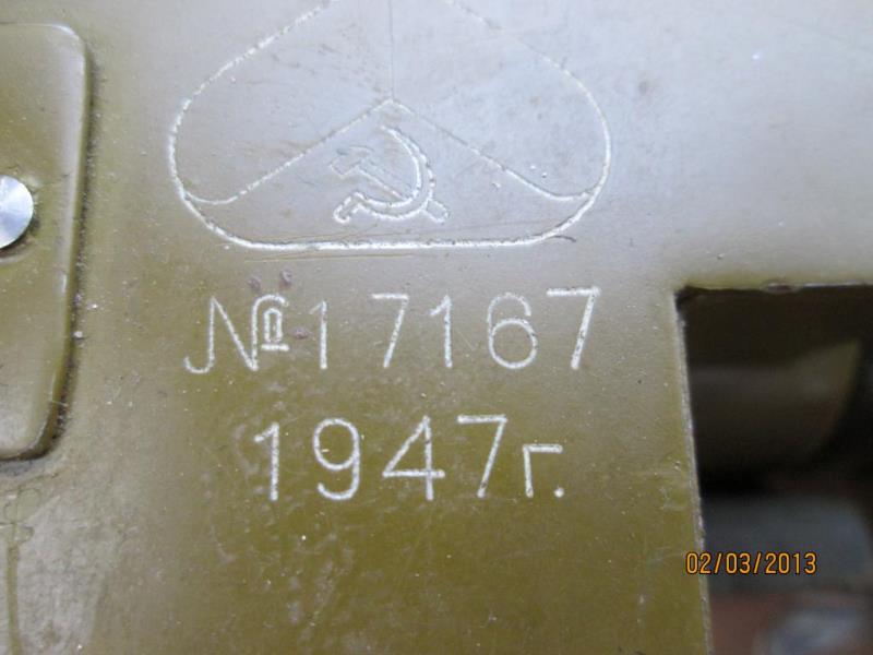

And concerning the Arsenal logo, here is some proof that it existed say in 1947
http://www.ussrphoto.com/resize/resize_image.aspx?ImgWd=800&IptFl=/UserContent/1372015_1a.jpg
http://www.ussrphoto.com/UserContent/1372015_1a.jpg

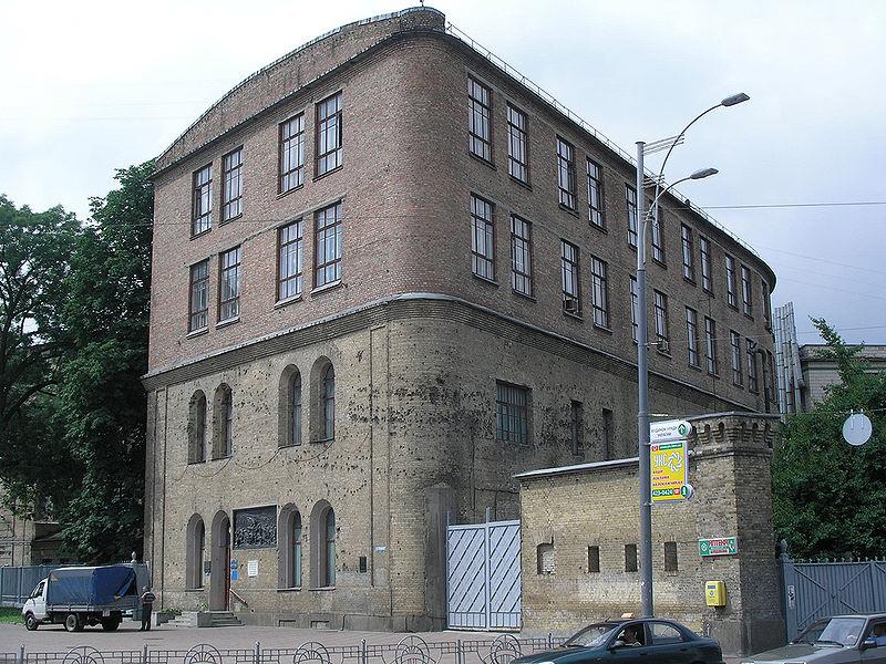

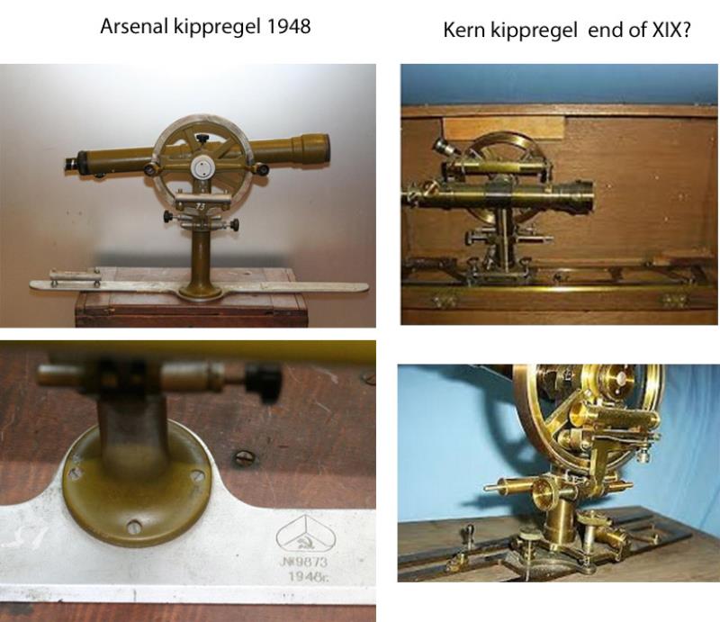

Another little thing. The FED Arsenal was produced in another place as Kiev-Contax cameras. Here is this building
http://www.ussrphoto.com/resize/resize_image.aspx?ImgWd=800&IptFl=/UserContent/1372015_comparison.jpg
http://www.ussrphoto.com/UserContent/1372015_comparison.jpg

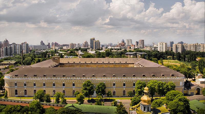

This is an old Arsenal workshop that more or less preserved after the war. So the munition and FED Arsenal was produced there. After the German equipment arrived and was installed in this building:
http://www.ussrphoto.com/resize/resize_image.aspx?ImgWd=800&IptFl=/UserContent/1372015_Arsenal.jpg
http://www.ussrphoto.com/UserContent/1372015_Arsenal.jpg
the production of optical devices were moved to the new workshops. Bill, your photo of the Kiev cameras inspection was done in the latter building (second floor). The third and the fourth floors were build in mid fifties.
Replied on: 20150713162749
Altix, thank for you the information, very fascinating! Regarding my statement of Arsenal logo, my source was this:
https://goo.gl/X3cwLg
Just for the recordkeeping [:)].

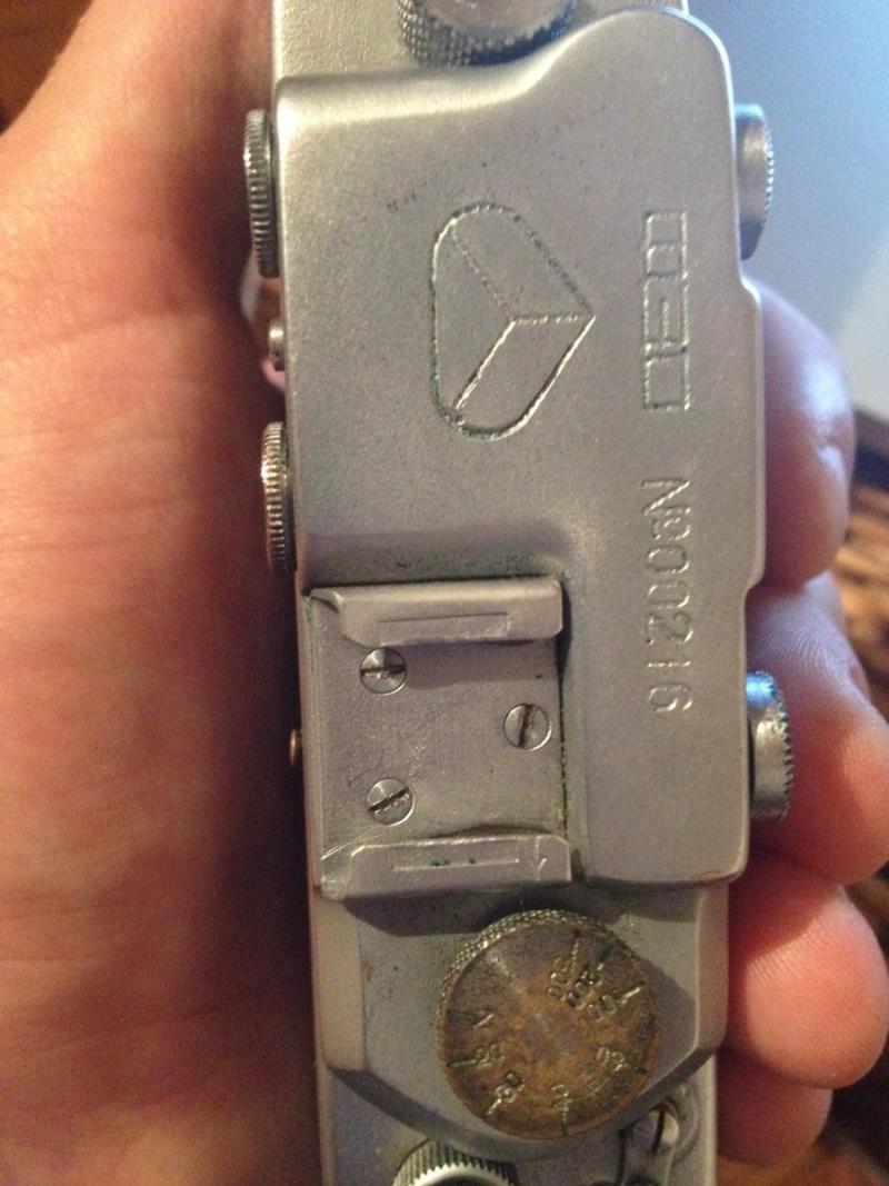

But all that are only guessings. Nevertheless, I must say that after Altix's pictures of Arsenal, I imagine a small team working on the mounting of these cameras...
Now, concerning the original Fed series of the 00216, showed by Altix, it's impossible to say without having it in hand. Is there a hole in the press film? If no, it's a post s/n c. 150000. Are the two plates magnetic? If Altix could put these two questions to his friend? But at first look, I would say that this camera was probably made from wartime Fed parts, exactly like mine. But the vulcanite seems different.
Something else: the frame counter is exactly the same too, on the two cameras, with a position of one pin at "12" (and at "32" on the other side, of course), never seen on a Fed. To compare with Bill's Fed-Arsenal, which has a normal Zorki frame with pins at 5/10 and 25/30. These famous missing parts...
It should be interesting to speak of the lens plate too, and of the choice of the lens: a very early "1 turn" on the s/n 00216. But I stop there![:D]

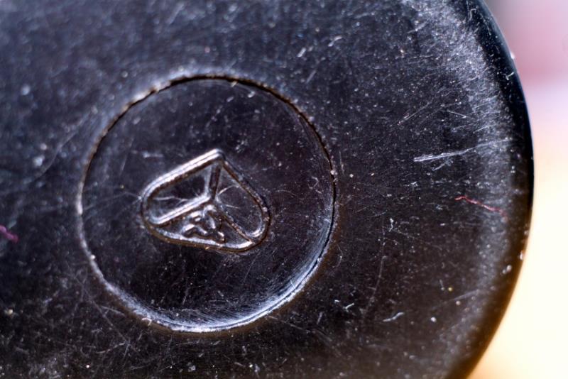

Replied on: 20150715002333
Dear Bill,
I don't believe that military Arsenal logo is a certain proof that the cameras that bears it was initially assembled for military. It is a tendency that every military device from late forties- early fifties has military logo but is not true that every civil product from that time should have the logo without hammer and sickle. For me the proof of military camera or military device is the presence of the inventory number. There are a lot of Arsenal civil products from early fifties that bear the military logo. Just one example
http://www.ussrphoto.com/resize/resize_image.aspx?ImgWd=800&IptFl=/UserContent/1572015_1.jpg
http://www.ussrphoto.com/UserContent/1572015_1.jpg
http://www.ussrphoto.com/resize/resize_image.aspx?ImgWd=800&IptFl=/UserContent/1572015_2.jpg
http://www.ussrphoto.com/UserContent/1572015_2.jpg
But of course I cannot exclude that the first batch was produced by request of military.
regards
altix
Reply author: nightphoto
Replied on: 20150715012017
Alix,
What kind of item is that in the photos? Do you think that one (with hammer and sickle) is for military and the other (without hammer and sickle) is civilian model? On the items I have seen, from all factories, the hammer and sickle always denotes made for the military.
And in any case, unless I find or hear new information, I don't have much more to add about FED-Arsenal. My opinion is, that I am open to authenticity, but I am not convinced at this time from what I have heard and seen. Thanks for the photos and info.
Reply author: altix
Replied on: 20150715022626
I showed the containers for film cassettes that were produced for civil market. The earlier one has logo with hammer and sickle. Just to show that this logotype does not mean that the item was produced for military purposes. I think that time nobody paid much attention which logo to put on the product.
Replied on: 20150715124938
Hi Alix,
Thank you for the photos. Maybe Arsenal was very used to having the hammer and sickle in their logo as they were primarily a military factory before and during WWII.

On the cameras s/n 00067 and 00216,
- there is no hole in the press film,
- the shutter box and the plates are made of magnetic metal.
So, I am sure that they were made between s/n c. 15xxxx and 184xxx, corresponding to the years 1940/41 or 1940/46, depending on where we put the 1e Berdsks: that's another question!
I try to find something about the original parts now: view counter, winding button and speed dial.

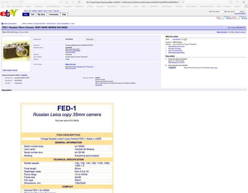

Replied on: 20150716173211
Hello everyone,
Concerning FED-Arsenal No. 00020.
It is possible to tell the difference between the rangefinder housing of a Zorki and the rangefinder housing of a FED by looking at photos. Specifically, if you look, from the top, at the shape outline of each, it can be seen that FED rangefinder housings look to have been hand-filed and are less square towards the rear section (where most of the engraving is). They look hand-shaped or hand-finished. The Zorki rangefinder housing, when looked at from the top seems more squared off, possibly more finished by machine than by hand. The Zorki has an almost strict right angle around the accessory shoe, where the FED has a slightly 'wavey' or bent look to the line, somewhat uneven as though hand finished - filed. Probably this is due to a slightly different and more advanced manufacturing process and technique at KMZ or more advanced machinery used at KMZ since they were a more modern plant. I have always noticed this and have used it to determine if cameras that had mismatched parts (rangefinder housing to body).
From looking and comparing photos, it seems that FED-Arsenal No. 00020 has a Zorki rangefinder housing (more squared in the outlines, seen from the top) that matches it's Zorki body. In other words, the camera is totally a Zorki, not a Zorki with an older FED rangefinder housing. If that is the case, then it would mean the camera was a Zorki when engraved with the FED-Arsenal logo and number. I have no doubts that the No. 00020 camera is the same as the other FED-Arsenal cameras as far the engraved logo and number details, in every way. I can not imagine that No. 00020 is a fake of an authentic FED-Arsenal camera as I bought it nine years ago (in October of 2006) when the others had not yet come to light and there was little or no discussion of this camera. If correct, this would point towards at least one FED-Arsenal "first series" being made from a later Zorki, not matching the time line of the FED-Arsenal story and not something a factory would be likely to do
Below are some comparison photos showing the rangefinder housings.
FED-1c
http://www.ussrphoto.com/resize/resize_image.aspx?ImgWd=800&IptFl=/UserContent/1672015_FED 1.jpg
http://www.ussrphoto.com/UserContent/1672015_FED 1.jpg
Zorki-1b
http://www.ussrphoto.com/resize/resize_image.aspx?ImgWd=800&IptFl=/UserContent/1672015_Zorki 1.jpg
http://www.ussrphoto.com/UserContent/1672015_Zorki 1.jpg
FED-Arsenal No. 00020 (Zorki body)
http://www.ussrphoto.com/resize/resize_image.aspx?ImgWd=800&IptFl=/UserContent/1672015_FED-Arsenal 1.jpg
http://www.ussrphoto.com/UserContent/1672015_FED-Arsenal 1.jpg
Auction of FED-Arsenal No. 00020
http://www.ussrphoto.com/resize/resize_image.aspx?ImgWd=800&IptFl=/UserContent/1672015_No.20 Auction.jpg
http://www.ussrphoto.com/UserContent/1672015_No.20 Auction.jpg
Replied on: 20150717040351
There is another detail which is interesting to consider: the hollow which let the rewind lever move freely, on the cover.
That feature, on my s/n 164433:
http://www.ussrphoto.com/resize/resize_image.aspx?ImgWd=800&IptFl=/UserContent/1772015_DSCF2215.JPG
http://www.ussrphoto.com/UserContent/1772015_DSCF2215.JPG
On Feds, this hollow is more or less square. And it exists on the prewar and wartime series (1c to 1e) without interruption. We find it again on the first postwar 1f, up to c. s/n 220000, then it disappears (my 1f s/n 232140):
http://www.ussrphoto.com/resize/resize_image.aspx?ImgWd=800&IptFl=/UserContent/1772015_DSCF2218.JPG
http://www.ussrphoto.com/UserContent/1772015_DSCF2218.JPG
On Zorkis, it is there on the first series. For example, on my Fed-Zorki s/n 03278:
http://www.ussrphoto.com/resize/resize_image.aspx?ImgWd=800&IptFl=/UserContent/1772015_DSCF2217.JPG
http://www.ussrphoto.com/UserContent/1772015_DSCF2217.JPG
On Zorkis, this hollow exists too on the 1a and a part of the 1b, then it disappears. Note that on Zorkis, it is more rectangular than on Feds.
This hollow is present on the covers of the Fed-Arsenals 00004 and 00067. It is absent on the 00020 and 00216. I don't know for the others. As the engravings have exactly the same characteristics, they were for sure made at the same time, when covers without hollow existed, probably in the very early 1950 years.
So, I share Bill's opinion: certainly these cameras were not made in 1946/47.

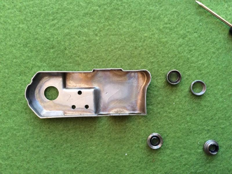

Replied on: 20150717120426
To all,
At present there is lack of documents from Arsenal and no passports or other official documentary evidence has been found, such as mention of this production at Arsenal in one of the magazines like Sovetskoe Foto. If the camera is fake there will never be authentic documents found and so lack of known documents can not be seen as proof that the camera may be authentic. It has been 65 years since the hypothetical production of FED-Arsenal, a long time for some documentary evidence to surface, as it has with many production details of different cameras, including the very secret KGB cameras and documentation of their manufacture. It is not enough, in my opinion, just to say that Arsenal was a secret factory.
Of course the small indentation near the rewind lever, that Jacques has mentioned and shown with close-up photos, can and was in the original stamping of the rangefinder housing, and not hand-stamped later. It will easily lift up from the stamping form by just lifting the piece out from the other side. The hollow is quite shallow and anyone with knowledge of metal stamping and die work will see this instantly.
In any case, it is almost beyond belief that rangefinder housings would be found without this detail as it would have been done at the same time as the initial stamping, even if for some reason they were hand-stamped. I think this theory is over the top and just being offered so as not to give up hope of origin at Arsenal.
All of the photographs of the different known FED-Arsenals appear to have the rangefinder housing of a Zorki, with the squared off-shape, rather than the somewhat uneven shape of the FED housing. This is very clear from photos of all examples that I have listed in the revised WIKI article of this site, with the exception of No. 00070 of which there are no known photos.
If all the examples of FED-Arsenal have Zorki rangefinder housings on either older FED bodies, or in the case of No. 00020, a Zorki body, then it is clear that the rangefinder housings were engraved at a later time and affixed to old cameras to deceive. It is pretty clear.
A comparison of spectral analysis of the metallic alloy content of various housings would be fine, but would have to be done by a well-known accredited - certified laboratory. Not just sent off to a participant of this discussion. But the subject parts be sent directly to the lab and the official results sent back from the lab. In this way the results would not be contested. I think it would be proof that the FED-Arsenal parts are of KMZ origin, but the tests would tell for sure.
And, lastly, concerning documents from Arsenal. Any documents that would suddenly become available in the near future, just after this highly public controversy, would need to be tested for authenticity, compared to other documents from Arsenal, and probably be tested for age.
I have followed and participated in the arguments concerning this camera quite closely, as you all know. I no longer own a FED-Arsenal and have not written a book or made a film that declares it to be authentic or a fake. I have written the initial entry for FED-Arsenal in the USSRPhoto.com WIKI and have recently edited it to reflect the uncertain status discussed by members of this forum. I have no monetary interest in whether it would be authentic or not and I am no longer a collector of Soviet or Russian cameras but I studied all aspects of Soviet, post Soviet, and pre-Soviet cameras for almost 20 years.
Considering the evidence and details that have been talked about and shown in photos, and the lack of any proof to the contrary, I now believe the FED-Arsenal camera is an older fake using re-engraved Zorki rangefinder housings added to old FED bodies and that the FED-Arsenal was never in production at the Arsenal Zavod. The cameras themselves tell the story, as always. Information from non-verified sources and unproven theories with no documentation do not take the place of the evidence and details visible and obvious on the cameras themselves.

Replied on: 20150718103958
Hi Alzo!
On thinking of the possibility of a spectrographic analysis, I wonder if it would really give us the solution of the problem, contrarily to what I have said above. Sorry...
I try to explain.
I suppose that the analysis will be made by comparison with another part, which will be the model. For example, the cover of a Fed 1e "Berdsk" and the one of your 00216. It's perfect if the result is positive. But what do we know exactly about this 1e cover? Is it different by its composition from a 1d or a 1f? Or even from an early Zorki's? I fear that we don't really solve the problem: we only change the question.
And even if it is proved that the 00216 cover is absolutely like a Fed Berdsk's (by it composition or whatever else) and that the series of these cameras is coherent, we won't know where, when and by whom this cover was engraved.
Here is the "hollow" on my Fed-Arsenal's cover. As you can see, it's a Fed type one. The camera is coherent and can be made of Fed Berdsk parts only. But that doesn't tell me if there is a series of Fed-Arsenals...
http://www.ussrphoto.com/resize/resize_image.aspx?ImgWd=800&IptFl=/UserContent/1872015_DSCF2220.JPG
http://www.ussrphoto.com/UserContent/1872015_DSCF2220.JPG
(sorry for the paint -not removed- of a precedent owner!)
Perhaps things would be better on analysing the odd spare parts, specially this very interesting counter frame I had never seen before. But in that case, what will be the model for the comparison?
I fear that you will find much more questions than solutions. To protocol should be hard. But I'm not a scientist![;)]
For me, it would be better to look for original papers of the factory, if it is possible. If not, probably this question will join the non-solved cases...

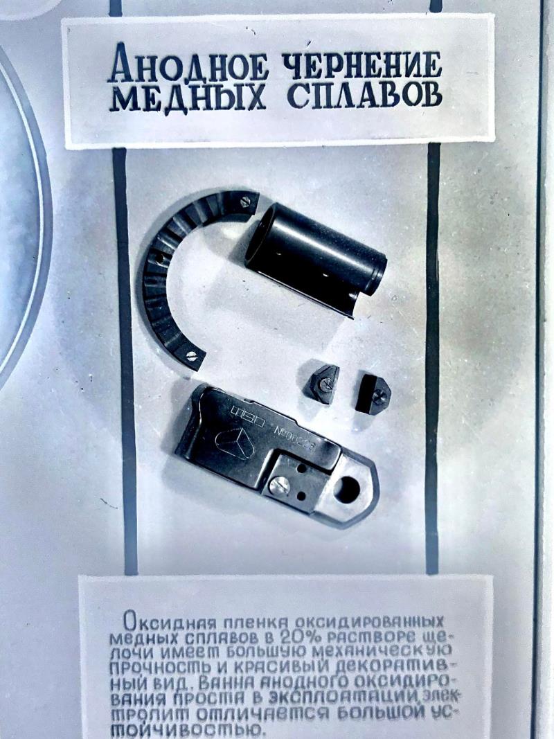

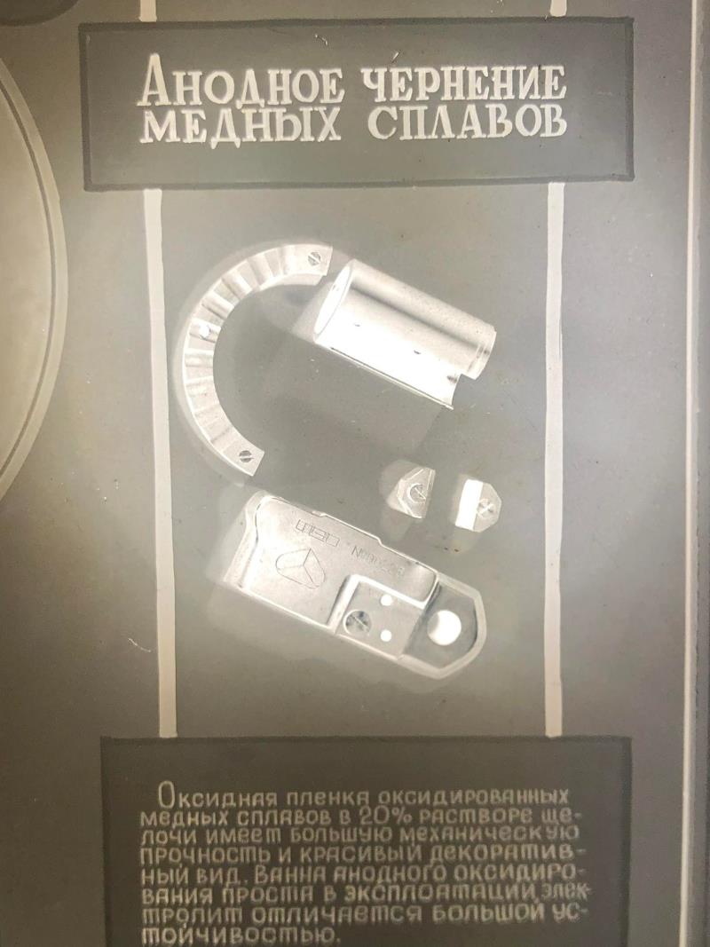

Here it is very interesting information that high-precision instruments like theodolites were produced in dusty draughty workshops with traces of fires left on the walls. The calibration and tests of devices were performed on window-sill in small office of workshop head. These optical devices were assembled by ex-dairymaids. No wonder that chrome plating on FED Arsenal is very poor.
http://www.ussrphoto.com/resize/resize_image.aspx?ImgWd=800&IptFl=/UserContent/1292015_p7.jpg
http://www.ussrphoto.com/UserContent/1292015_p7.jpg
Here is the picture from this newspaper that shows these ex-dairymaids. "Senior controller of assembling workshop of Kiev plant, where the director is com. Smirnov, N. M Koronina and controller O.A. Kozlova accept the new levels".

Here is the part of the article saying about FED Arsenal cameras
http://www.ussrphoto.com/resize/resize_image.aspx?ImgWd=800&IptFl=/UserContent/1292015_p6.jpg
http://www.ussrphoto.com/UserContent/1292015_p6.jpg
Namely here is written "And soon from this factory the country would obtain - in quantities of many dozens of thousands- the first-rate cameras "FED". Up to 120 thousands per year!"

Another interesting creature of Arsenal factory is the Arsenal kippregel. In the newspaper from 1945 was mentioned that Arsenal planed to start its production. This device is also extremely hard to spot and it looks fantastic. Actually its design was very obsolete for 1945 -1948 and comes most probably from the end of XIX century! I have found many similarities of Arsenal kippregel with Kern kippregel.
http://www.ussrphoto.com/resize/resize_image.aspx?ImgWd=800&IptFl=/UserContent/1492015_kippregel.jpg
http://www.ussrphoto.com/UserContent/1492015_kippregel.jpg

The Khrushchev's persistent desire to drag manufacture cameras to Kiev was known. FED, Exakta, Contax cameras... This letter is not the only one. It was still appeal to the GKO (not sure what to Stalin). This history as a whole is clear, just some details are unknown...
P.S. Sorry my English...

this great, Zoom. I think it is easy to understand for people from the territories of former Soviet Union. But I had some private discussions where this quote was not considered as a definite proof (especially taking into account that the book is from 1986). Therefore some additional effort was needed.
It is pity that you joined this discussion late enough.
P.S. the citation of Radianska Ukraina in the book is given with the mistake (wrong datum).

One more detail that I have noticed about the actual engraving on the FED-Arsenal:
The letters "No." before the serial numbers are different than the same "No." before the serial numbers of the Theodolites pictured.
On the theodolites from Arsenal, even as late as 1952, the large "N" curves over the small "o". On the FED-Arsenal cameras the "N" is straight with no curling at either end.
Also the chrome looks pretty good on all of the theodolites shown in the recent posts. The "dairymaids" sure got good at chrome-plating quickly !;.))
http://www.ussrphoto.com/resize/resize_image.aspx?ImgWd=800&IptFl=/UserContent/2492015_resize_image.jpg
http://www.ussrphoto.com/UserContent/2492015_resize_image.jpg
http://www.ussrphoto.com/resize/resize_image.aspx?ImgWd=800&IptFl=/UserContent/2492015_resize_image-1.jpg
http://www.ussrphoto.com/UserContent/2492015_resize_image-1.jpg

Replied on: 20150924162205
Bill,
Yes, the "N°" is different.
But the drawing of "67" seems made by the same pencil-plate on the two photos...
It would be interesting to know if there were different shapes of "N°" at Arsenal's, and when they appeared.
Replied on: 20150924170427
The "6"s are similar, but the end of the "6" on the theodolite almost is touching the body ... on the FED-Arsenal there is some room between the end and the body.
The differences of the "N" are distinct. Maybe means something, maybe not.
Replied on: 20150925030438
Right, Bill, the "7" is similar and the "6" slightly different. The devil is in the details![:D]
Altix will certainly tell us if the specific "N°", on theodolites, existed before 1947...
Always about details: it seems that the 00004 and the 00216 have a specific vulcanite, not far from the Red Flag's. And this vulcanite looks varnished...

Reply author: ilyast
Replied on: 20151111142008
http://www.ussrphoto.com/resize/resize_image.aspx?ImgWd=800&IptFl=/UserContent/11112015_20151111_141703.jpeg
http://www.ussrphoto.com/UserContent/11112015_20151111_141703.jpeg
One more
Replied on: 20151112094622
Nice! And with light traces of brushing on the chrome, like the others, as it seems? Congratulations, Ilyast!
Could you tell which sort of lens you have?
Thanks. Jacques.
Replied on: 20151112165254
FED f=50
Replied on: 20151113055134
It looks like a very early "1 turn" Fed lens, no?
Like on the s/n 00216 that Altix showed above in this thread.

Replied on: 20160510151110
Another one, the s/n 00010:
http://www.ussrphoto.com/resize/resize_image.aspx?ImgWd=800&IptFl=/UserContent/1052016_Fed Arsenal 10 7.jpg
http://www.ussrphoto.com/UserContent/1052016_Fed Arsenal 10 7.jpg
Reply author: Alfa2
Replied on: 20160511045840
Yes, and this "lovely" price - 8000 $

Replied on: 20160517131410
Hi guys! Help to identificate. Fake or not?
http://www.ussrphoto.com/resize/resize_image.aspx?ImgWd=800&IptFl=/UserContent/1752016_image.jpeg
http://www.ussrphoto.com/UserContent/1752016_image.jpeg

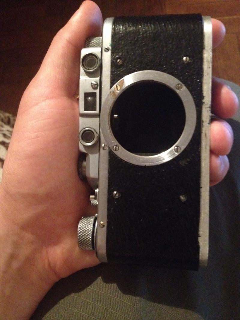

http://www.ussrphoto.com/UserContent/1752016_zJ7wZt68jZw.jpg
Reply author: Lenny
Replied on: 20160518064843
<blockquote id="quote"><font size="1" face="MS Trebuchet, Arial, Helvetica" id="quote">quote:<hr height="1" noshade id="quote"><i>Originally posted by elnur</i>
<br />Hi guys! Help to identificate. Fake or not?
Hi Elnur,
this is very easy, 3 screws under the rewind knob.
Reply author: elnur
Replied on: 20160518143805
Thx a lot Lenny )) its really so easy ))

Some interesting information could be found in those recente done pages.
http://photolubitel.com/index.php?route=module/kbm/article&kbm_article_id=3
http://photolubitel.com/index.php?route=module/kbm/article&kbm_article_id=5
two intersting articles on FED Arsenal
http://photolubitel.com/index.php?route=module/kbm/article&kbm_article_id=2
and this one about VTSVS.
Lots of interesting information. Use Translator
http://photolubitel.com/index.php?route=module/kbm/article&kbm_article_id=6
http://photolubitel.com/index.php?route=module/kbm/article&kbm_article_id=7
Fotokor with variations and the TEMP Shutter (Compur type)

About this s/n 00020, it's evident that it was not made with 1d or 1e parts: the 3 screws under the rewind button and the central screw, half hidden under the lensplate, denote a 1b or early 1c body. The absence of hole for the slow speeds in the upper plate is a confirmation.
That said, we don't know which materials were available for these cameras. Certainly, the Arsenal guys used what they had. So, to declare this camera is a fake would be a bit short. For the moment, we just have to compile...
Replied on: 20160603164550
from the article that Luiz posted in part one I am confused about this camera, it may be a bit offtopic for this thread as it's more for Berdsk thread but this Berdsk shield/logo FED-B with serial # in 180xxx range.. it goes against everything established so far... it only proves that you can't expect consistency or logic in Soviet production [:)]
http://www.ussrphoto.com/resize/resize_image.aspx?ImgWd=800&IptFl=/UserContent/362016_ris_6all.jpg
http://www.ussrphoto.com/UserContent/362016_ris_6all.jpg
Replied on: 20160603214722
Probably just a late FED-1e 'Berdsk'. The plate is probably just put on to personalize the camera (owners initials). The plaque may even have been cut from some other object with the monogram, such as a cigarette lighter or damaged piece of silver - vase, cigarette case, etc. Maybe was put in place to cover a hole by someone trying to add a slow speed dial, but unsuccessful. Probably not very relevant to the 'Berdsk' story or history. Can you read the monogram? "NIIS"?

Sorry for a delayed reply. Regarding the picture of the FED that I posted earlier with a initials cover, here's what the caption says and I'm not sure how accurate that is but it's a very interesting statement:
FED-Arsenal" with an "Berdsk" [1e] engraving "FED &#8470;183569."
The camera body was designed for model "B". [note the covered slow dial hole]
Hole exists for 1\1000 in speed dial disk.
All of the features characteristic of the species of Kiev's FED Arsenal except panel and lens are available.
Here, the cover assembly is not sandblasted chrome and just grinded - noticeable on the surface of the cover.
It seems that they just did not have sandblaster.
Another feature - the shutter spring - pink color&#1073; unpainted.
Chromed panel - without nickel substrate.
The description of this camera looked peculiar to me that it may have a been a leftover parts camera that was partially assembled in Berdsk as FED-B with leftover 1e cover.. and later Arsenal got same kind of camera body leftovers to do FED-Arsenal? This story has too many confusing unknowns that is why FED-Arsenal is going to sit in "contested" category until there is a undisputable passport or documentation for a specific camera.

The photo of the Fed-Arsenal s/n 00043 is much interesting. It shows extra holes for the screws of the slow speed spring and the connection towards the selector. It corresponds to those which can be observed on the Fed "B".
http://www.ussrphoto.com/resize/resize_image.aspx?ImgWd=800&IptFl=/UserContent/762016_fed arsenal s-n 43.png
http://www.ussrphoto.com/UserContent/762016_fed arsenal s-n 43.png
This Fed-Arsenal s/n 00043 could have been a Fed "B" in a better life... Note that these extra holes don't exist on any of my own Fed 1-s, nor my Fed-Arsenal s/n 00067.

By this article, there is an inscription inside the Fed bodies, which represents the date of making.
In my Fed Arsenal, I have a "III" on the body, behind the film plate (photo already posted).
http://www.ussrphoto.com/resize/resize_image.aspx?ImgWd=800&IptFl=/UserContent/1922017_DSCF2178.JPG
http://www.ussrphoto.com/UserContent/1922017_DSCF2178.JPG
Could it be for march?
Reply author: Alfa2
Replied on: 20170220053842
I saw similar sign in a FED. But it was long time ago. I don't remember in which FED it was and what was the sign.

After a long search and intense digging through the archives, I almost despaired of finding illustrative material in my search. It so happened that this year, on May 9, after a long illness, Serov Nikolai Fedorovich, the chief engineer and head of the head of photography production, died. His memory is fresh, but it was he who, during his lifetime, directed me into the mainstream of the subject and direction of searches. At one time, he suggested where there could be an illustration of what is so necessary for documentary confirmation, for which I am especially grateful to him. And so here is an image that confirms the products of the Plant, the production of fed at the arsenal. This is a frame from a formatted glass photo plate, among other reporting elements produced by the coating shop.
The report was compiled by the end of the 4th five-year plan of the USSR
Retaken by me through the light due to the lack of scanning equipment in this archive photo taken on a mobile phone plate in the light

Replied on: 20221225111723
Many thanks for this lucky find, Alzo!
Could you be more precise and tell more about it (if it is possible...)
And could somebody translate the Russian text?
Thanks!
Reply author: Alex_Rus
Replied on: 20230103075822
Top: "Anodic blackening of copper alloys"
Bottom: "The oxidized film of oxidized copper alloys in a 20% alkali solution has great mechanical strength and a beautiful decorative appearance. The anode oxidation bath is easy to operate, the electrolyte is highly stable."
(Google translation)
Replied on: 20230103084738
Thanks, Alex.
Of course, it would have been indisputable if it had spoken of the Fed-Arsenal production. But as it is, it's a very interesting indirect confirmation. And it shows a serial number we don't have in our listing (00226?).
Thanks again, Alzo!
Replied on: 20230104155249
Hi Jacques, I think you've misunderstood the meaning of this photo that Alzo posted. This is a film negative from Arsenal factory archives from around the time this camera was made demonstrating a anodation process and has the top of FED-Arsenal as an example in it. For me this is an indisputable evidence of validity of such camera existence and manufacture by Arsenal plant, being this part of an official factory report for the 4 year plan. And I know for a fact that Alzo has access to Arsenal factory archive materials. Personally this puts all of the doubt about this camera to rest and I will move it to an Arsenal section in the catalog.
Replied on: 20230105040522
I had not understand...
So, that document puts a final point to our discussion about the place where these cameras were made... I must say I am a bit moved!
Thanks again, Alzo!
You have put the camera in the Kiev section, Vlad. It is logical. But personally, I would have seen it among the Feds?
Replied on: 20230105092804
Jacques, it is 100% made on Arsenal factory based on FED drawings so it belongs under Arsenal since it's made there. Just as Zorki belongs under KMZ.. It's under "Kiev Arsenal - Other." Kiev being the city not the camera.
Replied on: 20230105110325
Right. And I had said that the "Kiev Arsenal" section was logical. For me, it's certainly more an affective question... And my Fed-Arsenal is amongst other exotic Fed 1, not with its fellows from Kiev!
We can compare with the Fed-KMZ cameras, but those ones had an illustrious lineage...
A question: does the serial number (00226) has a special signification for the Plant? It's the last found until now: could it be the last produced?
Replied on: 20231007101242
A "new" Fed Arsenal has just appeared: the s/n 143, proposed by Wetzlar camera auction.
It belongs to the second series (without hammer and sickle). The lesns is an Industar 22 "Moskow", very early type with a Fed plate s/n 110390/109-7.
A photo from the seller:
/UserContent2/7102023_158015920_1_x.webp
http://www.ussrphoto.com/UserContent2/7102023_158015920_1_x.webp
By our wiki, it's only the 12th (the 13th if we count the plate found by Alzo).
Replied on: 20231007111625
Just sold for 13000€...
