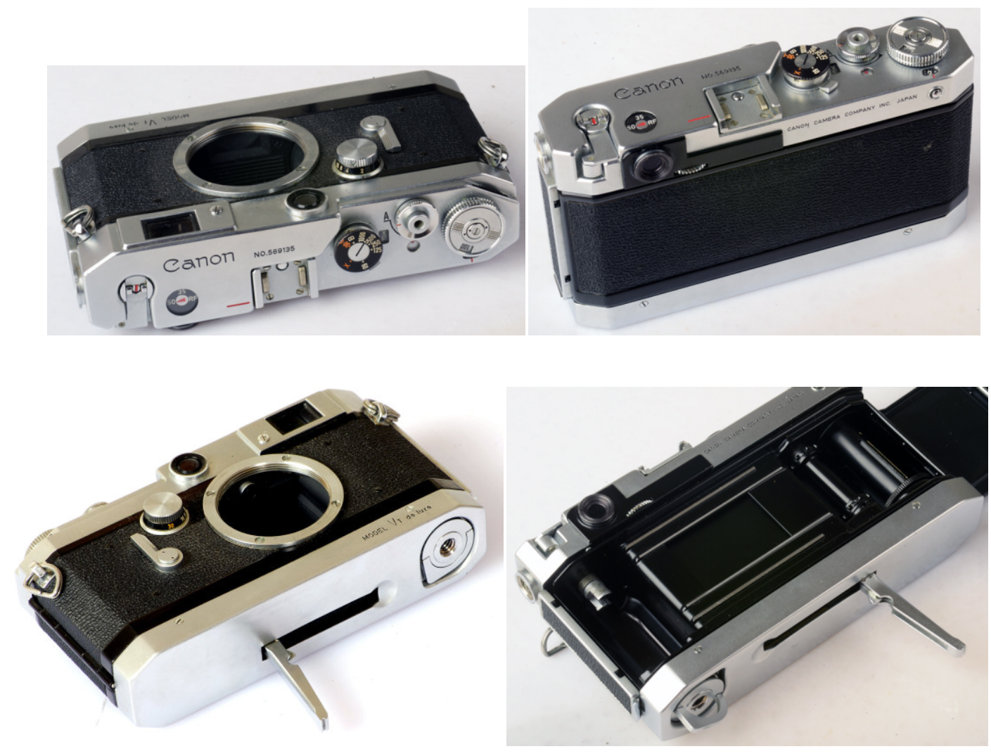

See the basis Canon Vt - pictures from Cameraquest.
Yes Luiz, this the Canon Jacques referred to- I think. I never owned one, but I suppose it's like Jacgues says- triggers share a common "issue"- stiffness.

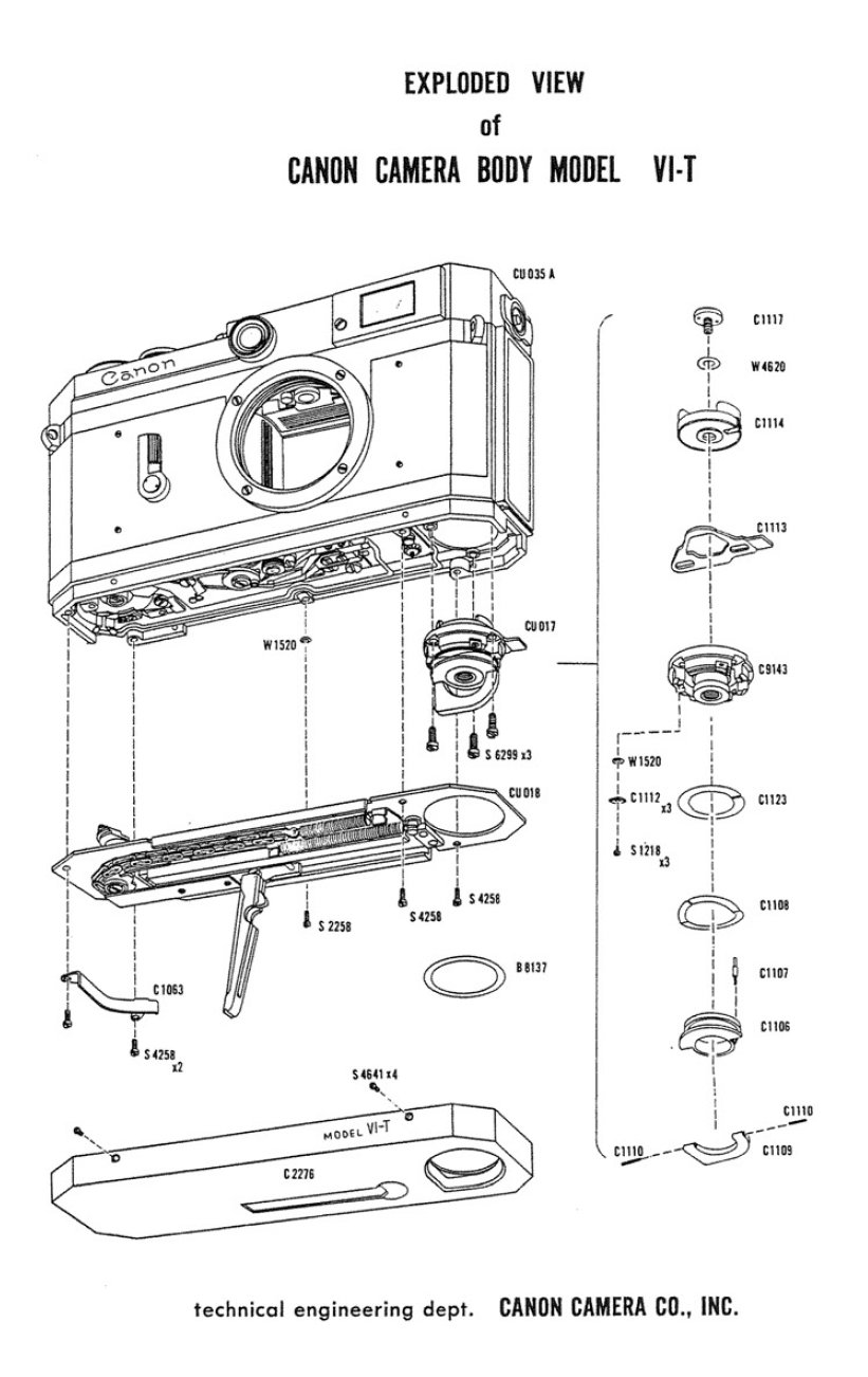

Here the winding mechanim od Canon VI-T (also V-T)
extremely similar to Droug

Thank you Luiz,
similar but very different. The Canon has only one chain wheel and the trigger pulls to the other direction. That's much better because the additional chain wheel of the Droug is even smaller and takes much energy. The Canon should work much better.
