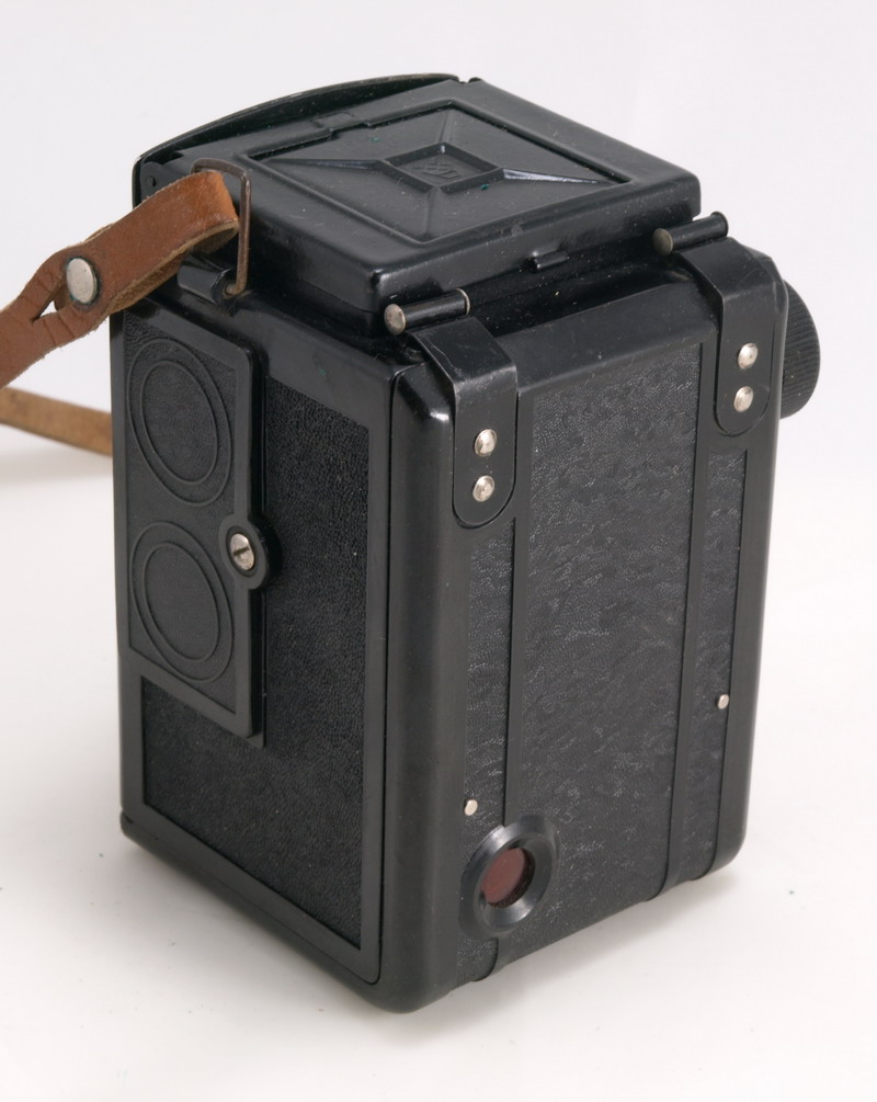

http://www.fedka.com/Pics/Komsomol'tsy/koms4713334.jpg
http://www.fedka.com/Pics/Komsomol'tsy/koms4713334b.jpg
Notice that this one has a window on a side, which is different from the 476444, which ahs window in the middle.
I have no explanation for this. If we agree that 476444 is a lower number than 4713334, then GOMS first made middle window, later for some reason changed it to a side window, and then, at some point again switched to the middle window.
And why the side window at all?? 6x6 frames have number in the center, correct?

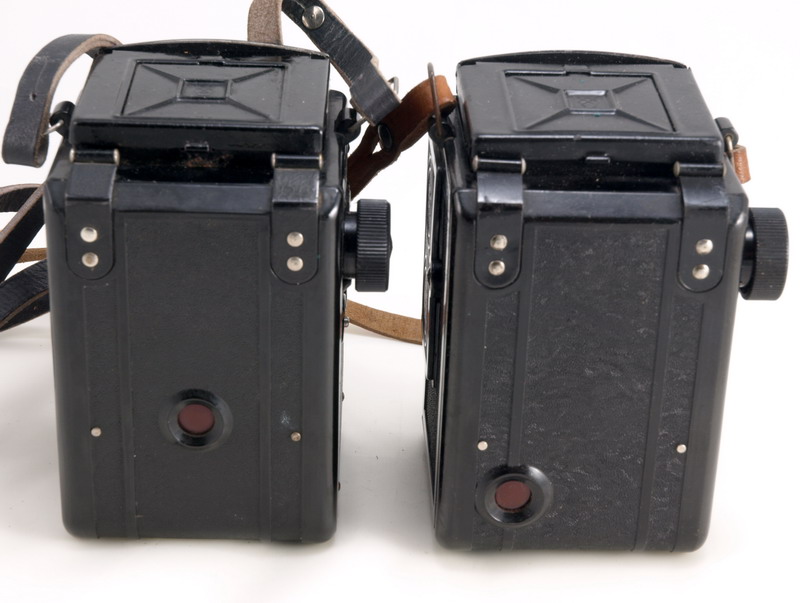

Here is a picture of the backs 476444 and 4713334

check the one with the window on the left.. are you sure is it still 6x6? Usually 6x9 are on the side.. how odd...
and by the way I hate you guys! lol Wink.. Now I have to get 7 more Komsomolets cameras... Big smile
Vlad,
No, it is still 6x6. If you open the back door, both cameras look identical inside.

Thanks for your missing links ...! I have only one assumption for your Komsomolets #476444 with centered window - the rear door is replaced from the later batch. I have checked all known early "counter" Komsomolets and all of them are left-sided ... So, good news for Vlad indeed Big smile, while 1st version has only two types, not the three ones ...
I need some more time, to make my initial conclusions. Now I have at least 5 versions with 8-9 types ...

Swapped back on my "counter-center window" Komsomolets is one of the ideas. I am not sure how valuable this camera was, and if was worth the trouble.
Another theory - we've seen just about any transitional combinations of parts on the Komsomolets. So this may be just one more transition - - from counter to no counter. maybe they moved the window to the center and checked if it was usable for 120 film, and later removed the counter (covering it with a blank side wall).
Why this transition would have a lower number that other 'side window"cameras - I do not know. We need more Komsomol'tsev to get to the truth.

I shall remember you that 120 films also called BII-8 in Germany and simply 60mm in Russia, had only 6x9 markings up to 1950!. That way, all 4,5x6 cameras without automatic counters manufactured up to 1950 had two red windows for the half format and all 6x6 cameras had a left side red window used for the counter start. Exception done to Rolleiflex that invented and patented the device of measuring thickness of film and start the counter (1937). In 1950 also was standartized the placing of the arrows in the paper back four 6x6 pictures before the seensitive film beginings, that way avoiding the red window that should fog certain films of the era.
On departure of those premises, one can say - The 476444 Komsomolets had its back door replaced by a newer one.-
In no way this should affect the counter device of the camera nor its usability as a repaired camera.
