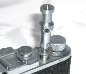

The one pictured above looks like the exact one that Fedka has listed at $39.
It must be operated with a shutter release cable. Possibly quite useable on a tripod but hand holding use has to be tough. Calibration on a particular camera must be done and difficult to find an exact setting that works consistantly..
I have a flexible adaptation that works simlarly but it too is difficult to calibrate with any degree of dependability.
