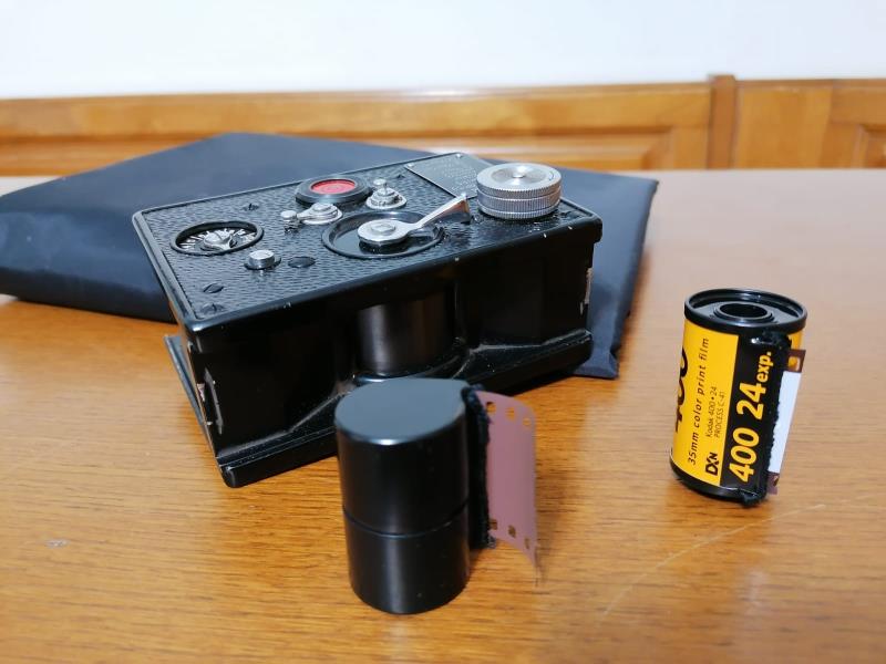

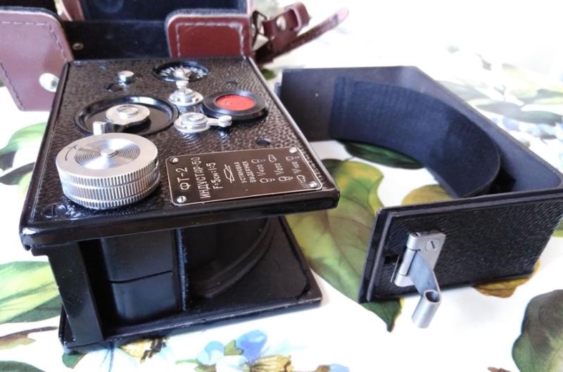

the camera has arrived and it is beautiful.
I loaded the spool and inserted everything without problems.
I turned the knob 3 and a half turns and placed the indicator on frame 1.
I'm ready for the first shot.
Now ... after I take the shot, how far do I have to turn the knob to position the film for the second frame ???
Many thanks to all !!!
Michael Perkins
perkinsmg
United Kingdom
32 Posts
Posted - Feb 03 2021 :  12:00:27 PM  Show Profile  Reply with Quote
Hi!
Glad you're happy with the camera!
It's three complete revolutions per shot.
If you want to count the frames taken then do three complete revolutions plus enough to take you to the next number - e.g. wind from 1 to 1 to 1 to 2.
Michael.
luigi gesi
schyter
Italy
94 Posts
Posted - Feb 03 2021 :  12:44:57 PM  Show Profile  Visit schyter's Homepage  Reply with Quote
great information Michael !!! Thanks a lot !!
so if I understood correctly,I have to do three full laps every time I want to advance the frame and the counter will position itself on the correct number.
Michael Perkins
perkinsmg
United Kingdom
32 Posts
Posted - Feb 03 2021 :  12:50:21 PM  Show Profile  Reply with Quote
Yes, three full revolutions of the counter. And advance to the next number if you want (there's nothing automatic about the counter increment. I also don't get frame overlap even if I don't move to the next number).

luigi gesi
schyter
Italy
94 Posts
Posted - Feb 03 2021 :  12:59:30 PM  Show Profile  Visit schyter's Homepage  Reply with Quote
perfect !!!
I have attached a piece of old film so as not to waste a shot.
I loaded a 24 exposure film ... will I get 8 frames?
Michael Perkins
perkinsmg
United Kingdom
32 Posts
Posted - Feb 03 2021 :  1:05:21 PM  Show Profile  Reply with Quote
You should do. I think I got 12 from a 36exp. These days I usually load bulk film.
