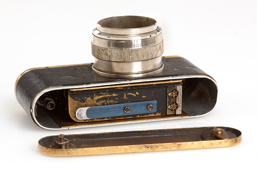

bonjour Jacques,
you have this Neuca gem for nearly 2 weeks now. Could you clean it and make it work again? How does it sound?

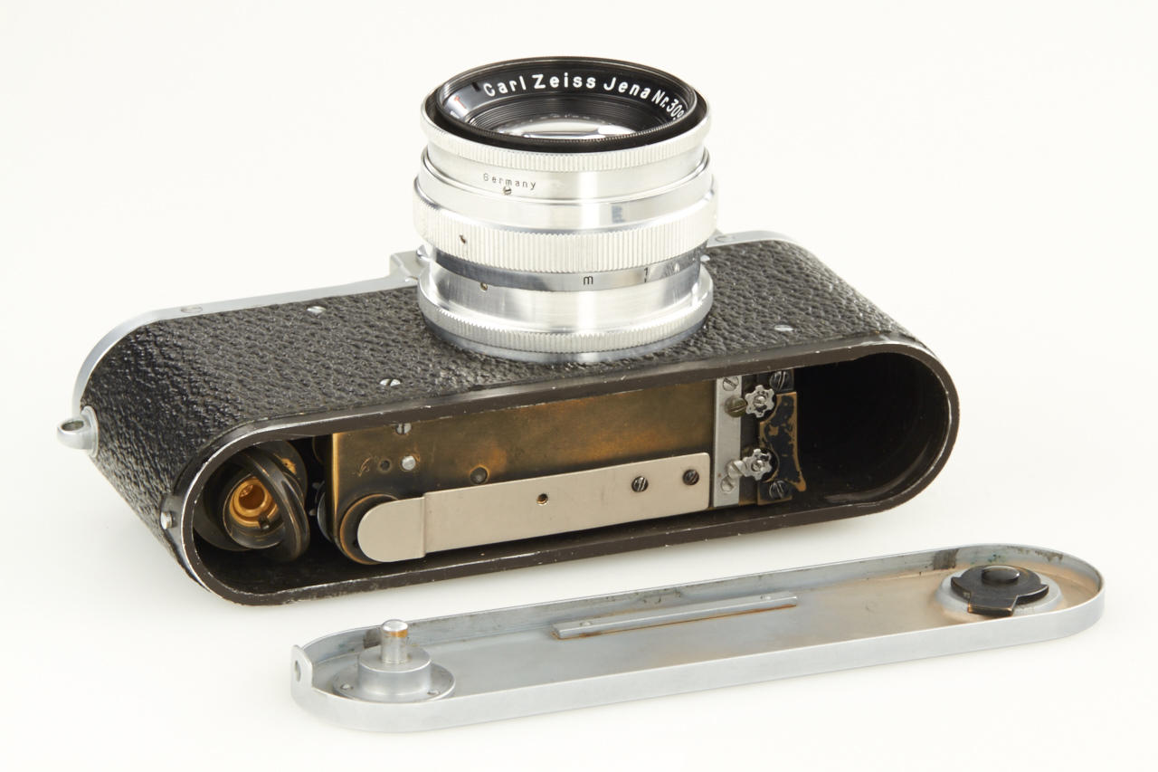

Did you change the tension setting screws? The 4-sided nut is on the closing curtain which is not necessary because it doesn't need so much tension as the opening curtain. The 4-sided nut would be much better on the opening curtain to adjust it better. I think they were changed by mistake. Too bad there is no inside photo of the Neuca from 1948 for comparisons. Interesting is that the black Neuca from 1946 has two 6-sided nuts like on Leicas and then Neuca went away from that and changed to 2-sided and 4-sided nuts.
To Lenny: I don't want to modify anything on this camera. The curtains are just partially jammed, and it would be easy to restore them. But I prefer to keep it in its actual condition.
To Stephan: good question! The lens flange is standard (28,8/28,9mm by my caliper).
I can understand that and of course this Neuca is very very special, but isn't it tempting to see how this gem works.
When I get an old camera, first I check if the shutter works. Sometimes the gears are dry and instead to clean and lube it the previous owner only increased the tension to keep it working. I lower the tension then first to give the camera some rest and sometimes I keep it cocked for some days to give the opening curtain some rest too. I'm sure these old cameras are in good hands when we have them.

There is this black Neuca which might be from 1946
Then there is the Neuca which was just sold at westlich, could be from 1948
They both have six-sided nuts with an additional plate under it and the long shutter-spring. Your Neuca has 2/4-sided nuts without a plate under it and a short spring. I guess your Neuca is a younger evolution. Why start with a shorter spring when Feds had long springs. But still I like your Neuca most, very special.

if you have a Ucaflex it must be from 1953 or later, right. Above I posted 2 pictures of Neuca-Prototypes from 1946 and 1948. Both have 6-sided tension setting nuts. Jacques' Neuca has a 4-sided nut for the opening curtain and a 2-sided nut for the closing curtain. I wonder what kind of nuts your Ucaflex has. Maybe you have also 2/4-sided nuts, but just for the opposite curtains. I think the nuts on Jacques' Neuca were changed in postion after the shutter-box was painted some time ago.
