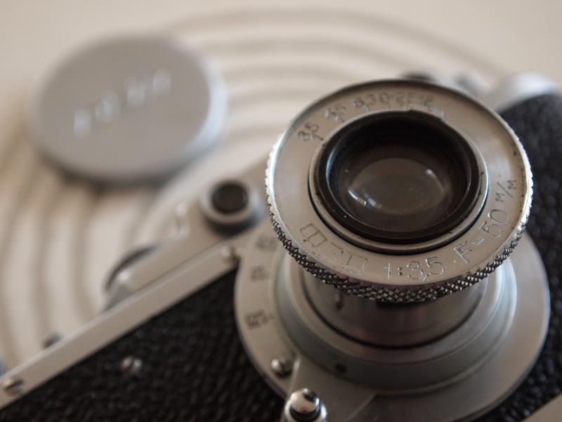

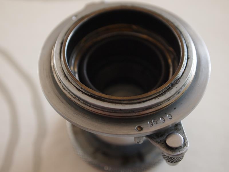

Hi lenny
Please find below pictures of the lens..
Thanks Fred,
is there no number at the lock?
#6696 is a nice number because it can be read 9699 too.

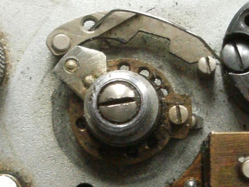

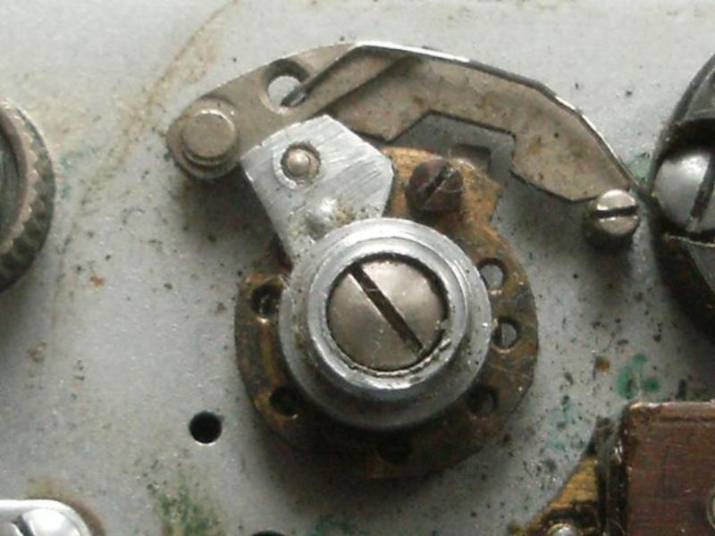

There is no mystery.
About the speeds, the main difference between a Fed S and a regular NKVD is the presence -or not- of a screw on the speed wheel.
Here, the "announced" speed is the 1/60th. Around, you have the different holes for the speeds from Z to 1/1000th. 9 in total, if I include the 1/60th.
The screw on the speed wheel prevents from reaching the 1/1000th. Here, the foreseen speed is 1/500th:
The NKVD which have a 1/1000th position simply lack this famous screw. Intentional or not, I don't know.
About having two notches for the same speed (the 1/500th, here), it is mechanically impossible.

We must be more cautious.
My two photos are from 1d-s. Here is an other of my S-s, in fact my earliest (an early 1c).
As you can see, it has an other system...
Last thing. I won't post any more about that question. If we are not wise enough, we will have soon heaps of S-s for sale on the net.
