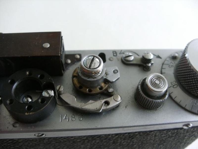

This is "regular" Zorki camera.
I cannot write more about the camer bacause I din't have it for few years. Only photos left.
Number is also here. What could it be the number ? Maybe this is not part number bacause it should be the same number on the same element.
Number of worker who assembled the camera using any code (e.g 1 at the beginning means first shift)?

Yes, this is not a part number, because it was engraved. But there are part numbers and they can change, even when the part seems to be the same.
For example the vulcanite housing. There is a number between the left screw hole and the middle screw hole on the front side.
Zorki-C #560xxxxx has number 008
Zorki-C #570xxxxx has number 004
Zorki-C #572xxxxx has number 007
Zorki-C #580xxxxx has number 007
Zorki-1 #5xxxxx has number 004
These 3-digit part numbers seems to be in the mold form when the housing was made.
There are signs of workers on Zorkis, but these signs are not engraved like these 4-digits "1486" and "1207". Not every worker had an engraving machine at hand, but they could easily stamp signs, only a stamp and a hammer was needed. Also signs could be scratched with a needle.
