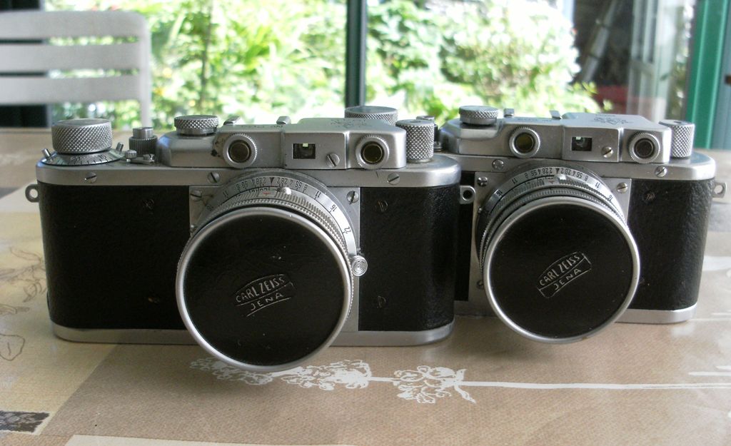

Hello Juhani,
At your request: 2 pictures of the camera's. Above the chromed version. It's difficult to make a picture of the chromed version: strange reflections all over.

Thanks for the new photos, Ad.
Looking at them, it seems that:
On the above version, the strap lugs are lower than on ordinary TSVVS-s,
On the other one (below), it's the middle screw which is not on its common place. And the rectangular finder ir not exactly centered.
This last remark is important, as most fakes have a wrong rectangular window, too large, because of a cover borrowed to Fed 1 (I have not said that your camera is a fake!).
Now, concerning the classification adopted by sovietcams, I don't see why these non engraved TSVVS should necessarily be pre serie cameras. But the shape of the cover, they should rather be intermediate prototypes or post series. I ask Aidas about it. Certainly he will answer!
Alexander: I cannot see if you have screws or rivets to fix the lock of the bottom on your camera? It seems there are inside numbers stamped?

Hello Jacques,
About the place of the 2 screws: I noticed that. (And mentioned it in my "P.S." of my first post.
The rectangle of the viewfinder: the finder of the metal version is somewhat better. Perhaps because of the chroming process, the other is not so straight...?
Ad
No, Ad, it's a question of position: the rectangle does not seem well centered: probably too low.
To compare with the windows on my two TSVVS which seem correctly centered:
That said, I may be wrong: it's perhaps the photo...
Hello Jacques,
No, you are not wrong. The rectangle viewfinder is vertical not well centered. Something lower. And that makes the difference! (On the internet I can't see any TSVVS which has a "lower" viewfinder. So this is OR interesting (and need research) OR a clue that they are fakes...?
Anyway, they look somewhat clumsy...
Ads
Hello Jacques,
The viewfinders. The chromed first.
Fake would be easy to make perfect with better tools than back then. And in a fake something this visible would not be left this raw.
