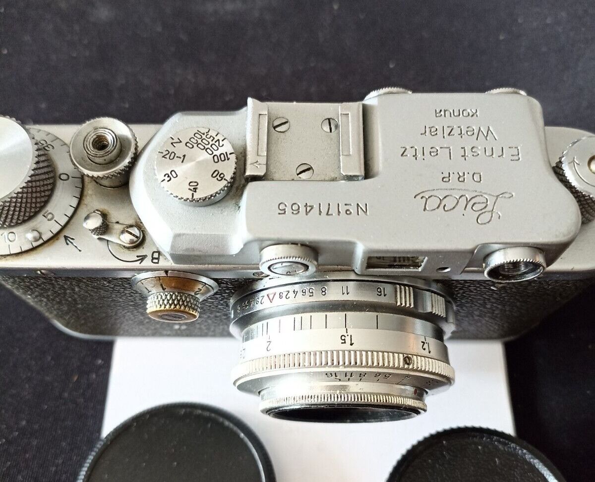

For the moment, the camera is not yet here. I suspect it was originally a Zorki 1b completed with some Leica parts...
http://www.ussrphoto.com/UserContent2/2252023_zorki slow speeds 2.jpg
This camera was certainly a very early Zorki 1b in a previous life.
All the speeds run correctly, perhaps the slow ones are a bit too fast. The only point is that there is no 1/1000th possible, as there are only 8 holes on the speed wheel. So, I will have to find a correct speed dial, from Z to 1/500th, and with the 20--1.

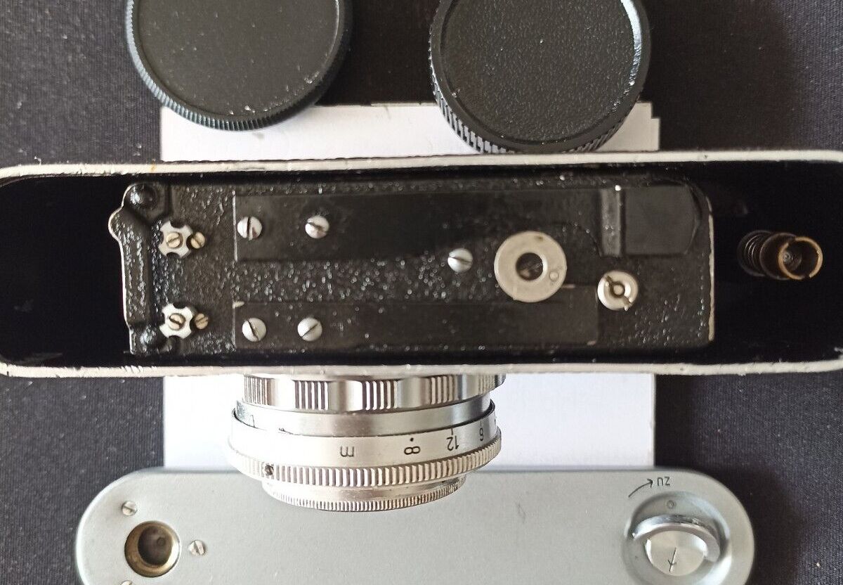

On this Zorki base, a slow speed mechanism was adapted from Leica III parts. A very neat work, certainly professionally made. The cover comes from a Fed NKVD, with a square depression for the rewind lever. All that works normally.
Comments and questions are welcome!
What a nice work the craftman has done. Yes, seems to be an early Zorki 1b, as you can see on the rangefinder coupling piece. The slow speed mechanism on the top looks like one from a Zorki 3. The last picture is nice, the release spring must come from a Leica or somebody has cut it out. Btw. what lens have you got with the camera?

About the extra hole in the speed wheel, it's a good idea. But I wonder is there will be enough space for the leg. Unless I adapt a slimmer leg borrowed to a Fed? Not impossible...
As it is, I noticed that the arrow on the clip is in perfect position for Z and 1/20th. But things are not "square" after: for 1/40th on the dial, it's between 30 and 40, and so on . Differences of regulation between Zorki and Leica?

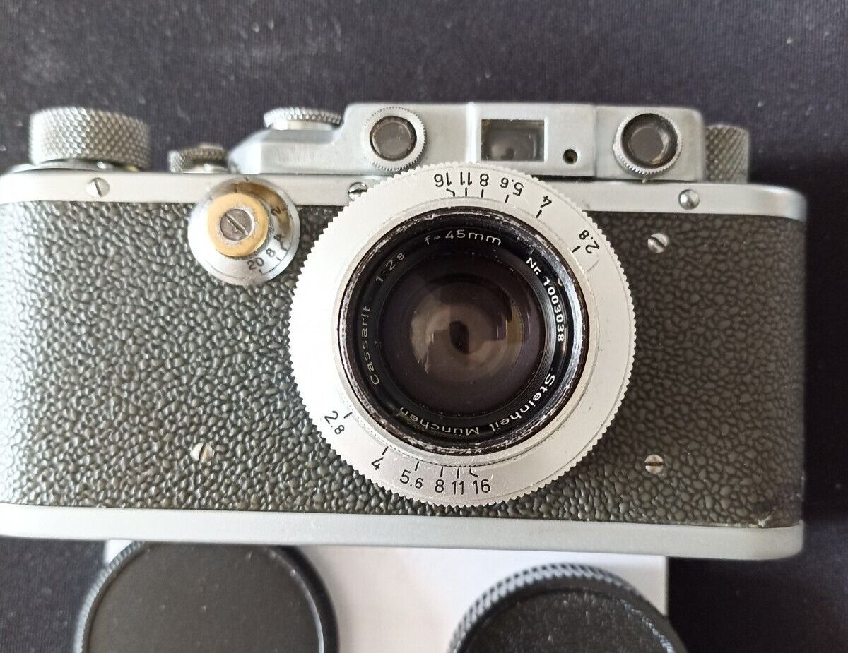

About the lens, that's another chapter! I bought the camera with a Steinlein Cassarit made for the Braun Paxette: M39 too, but with a register of 44mm... Big smile
So, things are open. A genuine Industar 22 or Elmar? A fake Elmar, to keep the original idea? For the moment, I don't know. If you have other ideas...

An early fake Industar would be best IMO...
Congrats for this beautiful find. Did they adapt the Paxette lens to the Leica register and if yes, how did they do it? Or does this lens just not focus ?

With such a lens, it would be necessary to put a bag of 44 - 28,8 = 15,2mm to have an image through the entire range. I tried with 14,7mm (I cannot do better) on my Sony, and it works, at least at middle distances.
Impossible to try with an early M39 Zenit: the lens is protruding and the mirror could hurt it...
