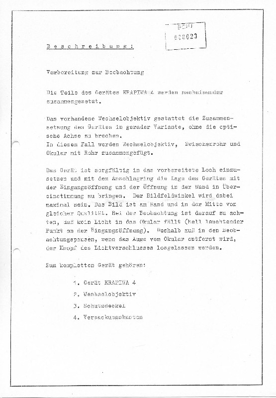

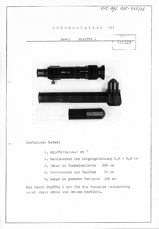

this device is called "KRAPIWA 4" and it is for looking through thin walls and ceilings.
Detlev

Many thanks for your reply and documentation. The metal label on the box reads C-215 plus the serial number, so would this device have been manufactured in Germany or the Soviet Union? I am sorry to say that I cannot read German. Does the documentation say what the two devices in my last photos are for?

Hi David,
C-215 is manufactured in the Soviet Union but also used in the GDR. The documentation says that you should use the stop ring to adjust the aperture of the lens to the hole in the wall.
As far as I can remember later C-215 haven't got these strange items anymore.
I asked a friend in Moscow to explain these parts.
Detlev
