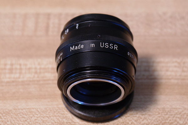

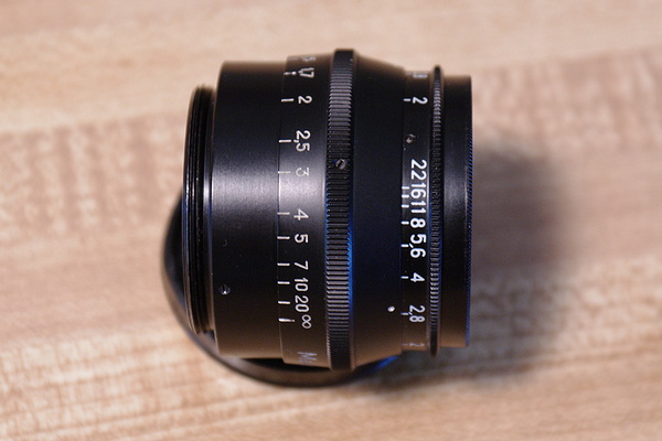

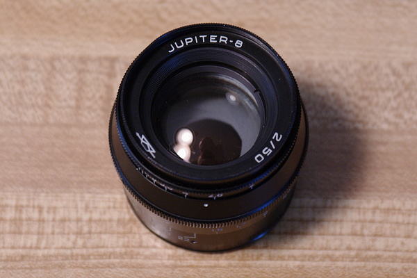

Actually, I doubt that this lens is from early production of the Jupiter-8. The body is black and is in excellent cosmetic condition. The focusing scale is engraved into the barrel, but the aperture scale appears to be painted or perhaps printed onto plastic. The wording is all in English rather than Cyrillic. I believe that these are characteristic of later production, but I would be interested in what others think.

There are theories (do a search here or google it) that serial numbers beginning with "0", "00" and "000" are pre-series production numbers. In addition to that, some believe that these lenes are of a higher quality. I'm no expert on Jupiters but the black lens at the vey least represents a cosmetic redesign of the barrel components and therefore would likey have had a pre-production "test" run. I am only guessing but the lens could be pretty close to the body age. I know that you said Zorki 4 but I think that the 4K was releaed in 1972 and that probably got the newly redesigned J8, black J12 and black Industar lenses. The Zorki 4 probably got these as well but anyway the 4K marks the timeline. I bought a new 4K with black J8 and J12 in 1975 or 1976.
Thanks, Paul, that makes sense to me. The serial number of my Zorki-4 is 72009926, so it was probably made in 1972, near the end of Zorki-4 production. It's likely that the lens would be contemporaneous, although I don't know the history of my camera before it came to the US - it's always possible that the lens was acquired later. Anyway, unless I receive information to the contrary, I'll assume that the lens was made in 1972 at the beginning of production of the black version. In any event, it's a nicely made lens with good optics.
