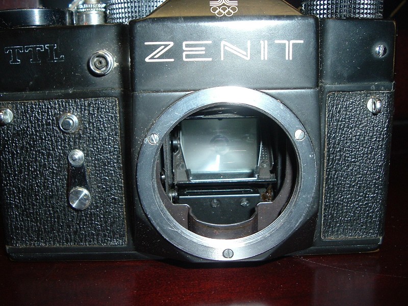

Zenit with 3 screws

Hi Okynek,
Three screws are quite normal for early Zenit-TTLs. I think they changed to four screws around 1979/80.
David.
David.
12/13/2011 21:25
These 3 screw series correspond to the first series of TTL cameras Because photoelectric cell is positioned just above the space os the two top screws. In the next series the assemby was changed again to four screws. because the photocell was redesigned and the cameras with three screws often became with its mount loose.

Thank you David. I did not know this.
But now reading Zenit TTL pages on Aidas Web side I start understand his notes about 3 screws .

Thank you Luiz! Wealth of information!!!
I was thinking that KMZ was trying to cut costs of production
Now I know!
