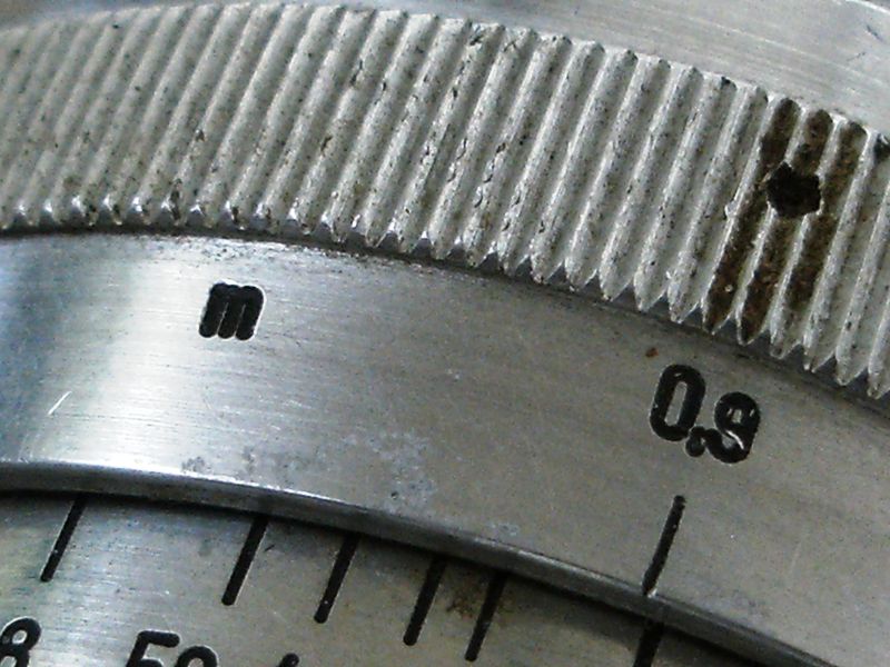

To be more clear, here are the two symbols for "meter" on Zeiss lenses.
First, the m (used for lenses regulated for Leica bodies). The lens is a 1,5 Sonnar (LTM, of course!).
http://www.ussrphoto.com/UserContent/342012_meter scale 001.jpg

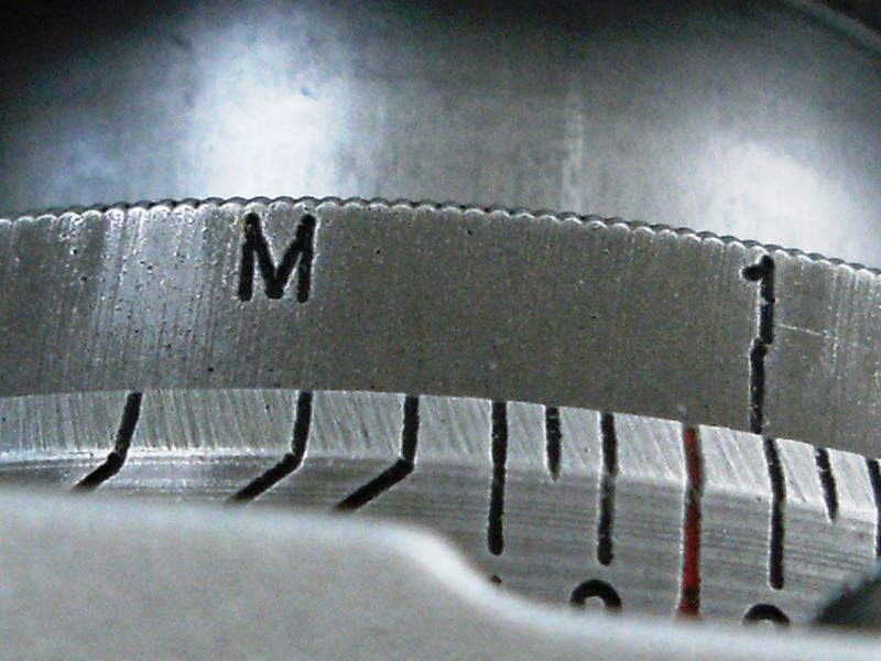

Then, the M used for the Russian production. The lens is the collapsible 2 Sonnar which looks like the 1948 ZK.
http://www.ussrphoto.com/UserContent/342012_meter scale 002.jpg

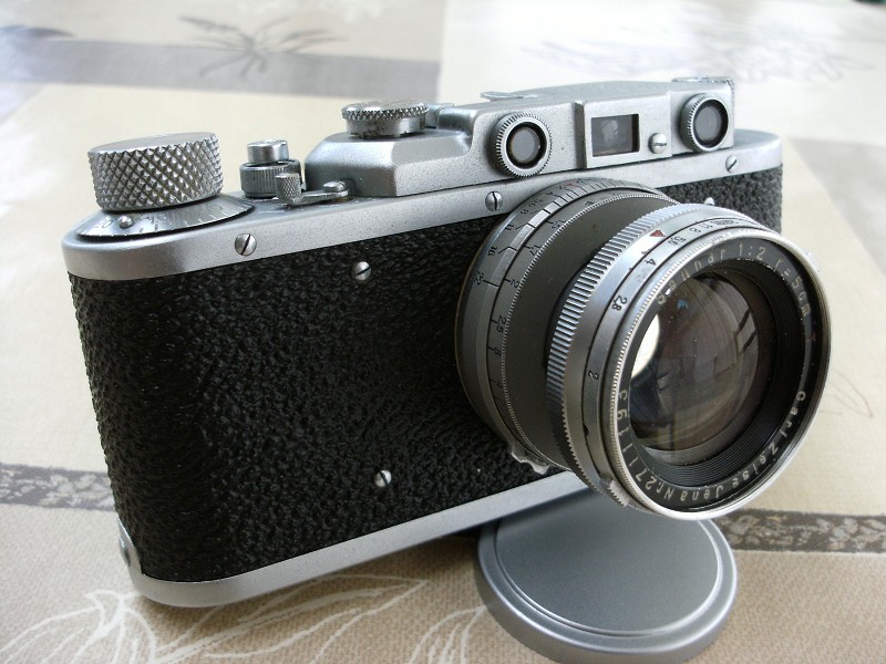

Finally, I have put this last lens on a late Fed S d type. The lens ring (fixed to the body by four screws) was already turned of 90° clockwise. So, it's perfect!
http://www.ussrphoto.com/UserContent/342012_meter scale 003.jpg
