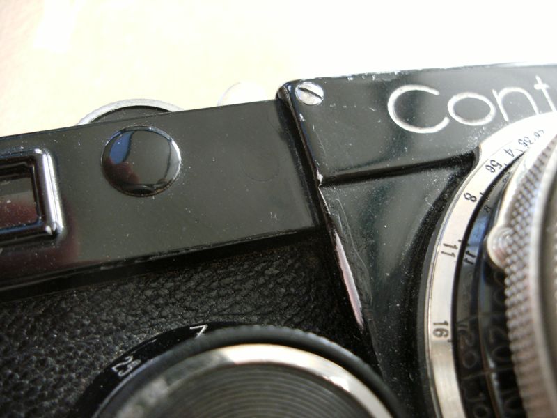

Some pictures from mine, thanks to Vlad's permission!Smile
First, my AU 7xxxx PP, which is a non modified 1a version, as it seems to me. Even if it was probably repaired.

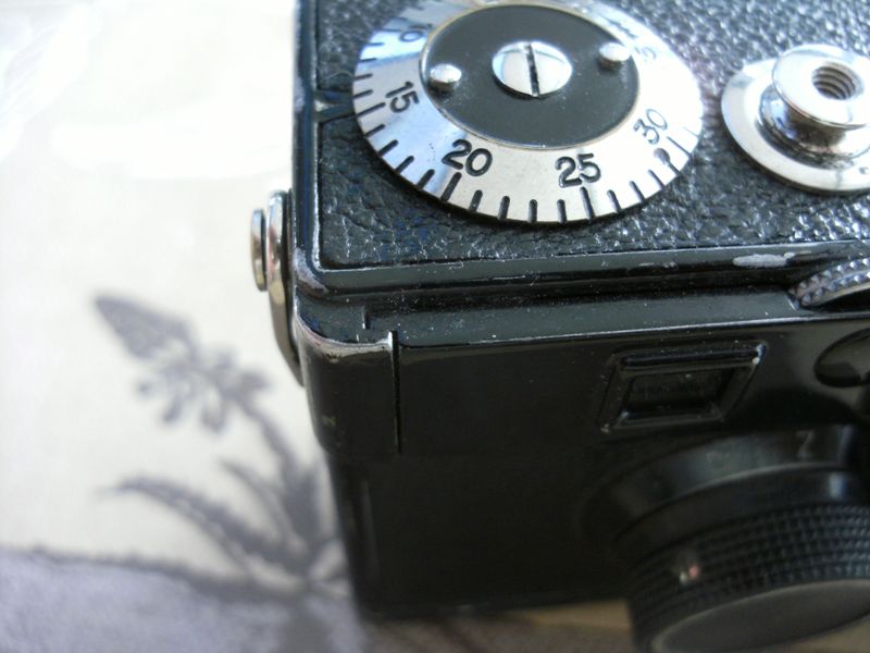

Note the aluminium under the black paint, the pimple and the absence of screw on the corner (third picture).

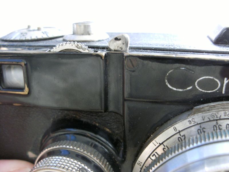

The same pictures of my U 2400.
This one should be one of the first of all Contax 1, but it was strongly modified: the 3 parts of the front plate in aluminium were replaced by a one part front plate in brass. And slow speeds were added.
Perhaps even Zeiss engraved the old serial number on a new body rather than repairing it, like Leica and Fed did.
Note brass under black paint, the screw on the corner (3rd picture) and the absence of pimple.

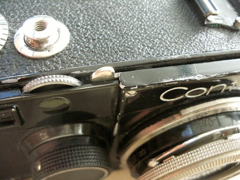

And now, a detail on my # Z 25727 (the last series): not the same as on the precedent pictures.

Here it is! (Dont have a digital camera, so I had to borrow).
No doubt, it's a beautiful 1a version. With a pimple!
And a very early Tessar 3,5/5cm by the serial number.
