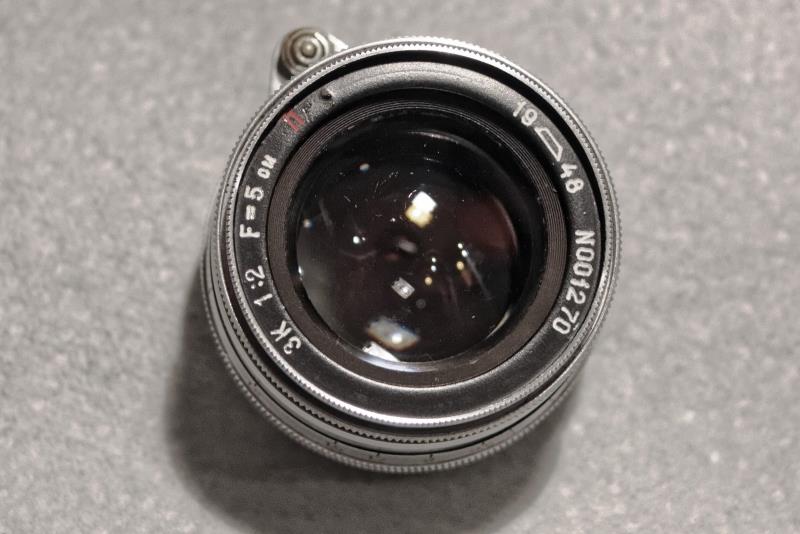

Hi all

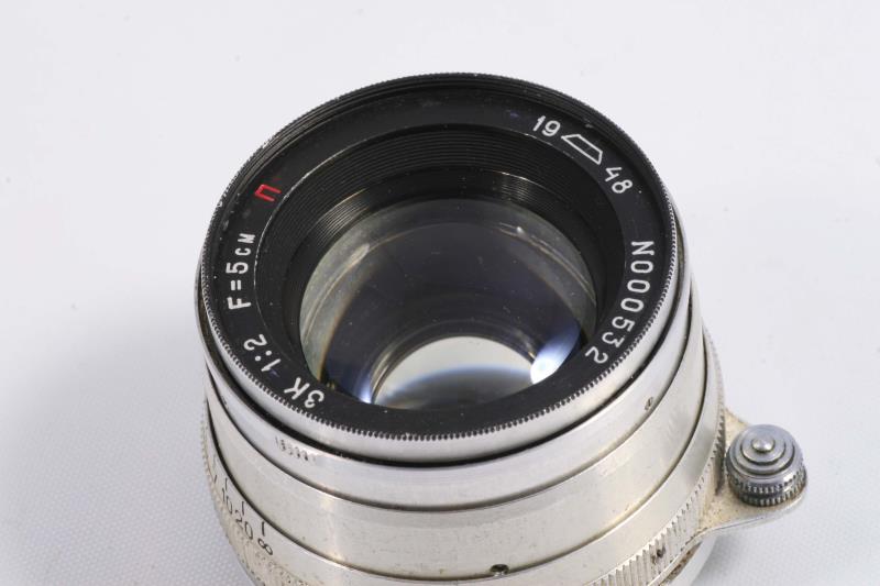

I got this lens. I have some doubts about it. Do you think it is a genuine one? It is in really nice shape.....
Tnak you very much
Hi Fred!
I doubt too.
A 1948 ZK should be collapsible, I think. And it should have rings at the diaphragm ring.
But it's only my opinon...
The best should be to dismount it to see if there is a Zeiss number or not. In 1948, they always had it...

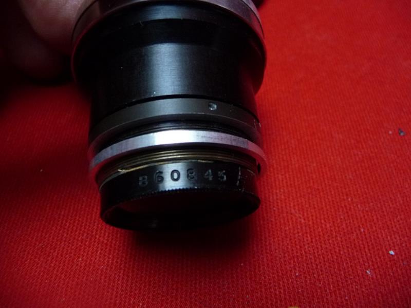

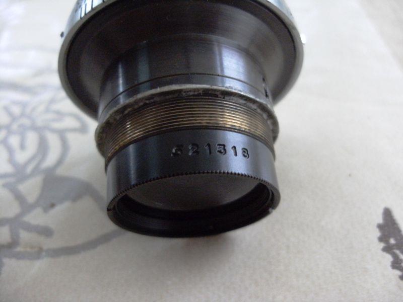

I will open it, buet where I will find the zeiss number inside?
There, on the rear part of the lens barrel:
(it is on a 1,5/5cm, but it's the same on a 2/5cm).
You have to remove the back screw first, then to unscrew the lens barrel by the front part.
It should come, but don't force!
Hello Fred,
that is my lens and I am also not sure if it is genuine. Let's try together.
Jacques, there were both lenses in 1948, "normal" and collapsible.
Could you please show more detailed, how to disassemble the lens to find the number?

nice clean zeiss number on the first one

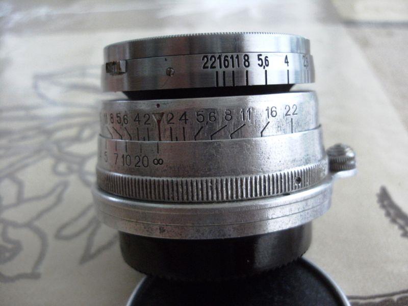

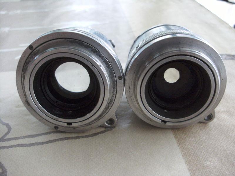

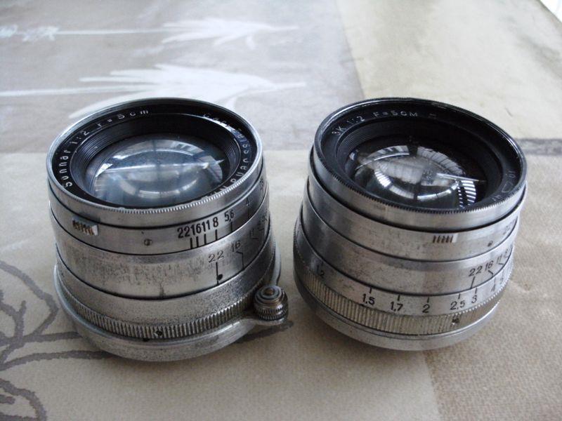

Well, two of my 2/5cm LTM lenses.
Right: a fake 1947 ZK.
Left: a true Sonnar, but non original (baionnet optical part put in a Jupiter 8 body).
The optical block of the Sonnar is half unscrewed (I could have taken the fake ZK: it's just the same):

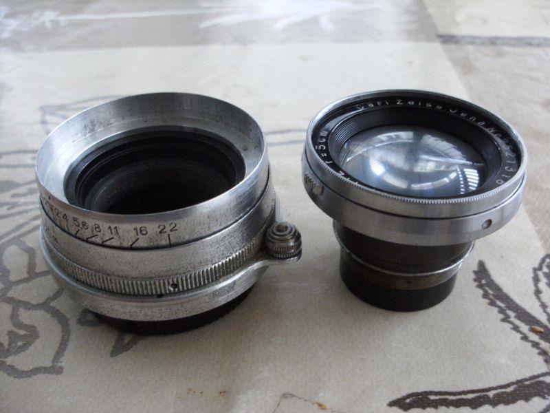

Now, the two parts are side by side:
And here is the Zeiss serial number:
On some series, there is a screw which tights the different parts of the lens, specially on collapsible ones. But not to force if that does not come! I have several lenses with a "cemented" block...

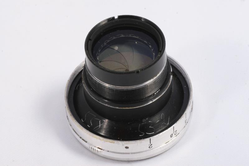

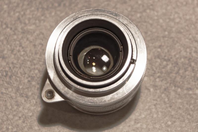

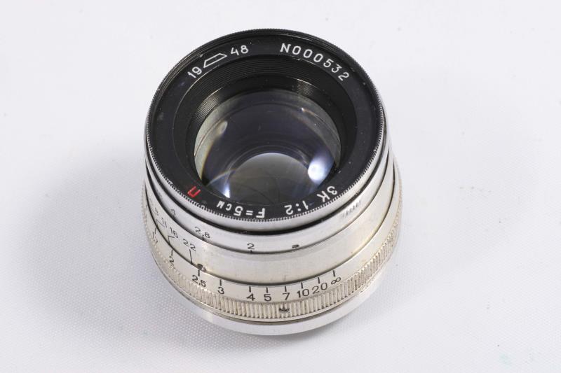

I have unscrewed my ZK '48 and that is, what I have found inside:
...of course without any Zeiss serial number.
Hi Alexander...
Same for me...Big smileBig smile No Zeiss number too.....
Thank you very much Jacques...
