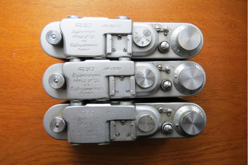

The comparison between these three Fed 1b cameras shows that this s/n 4580 belongs to the same variety as the s/n 25617:
- it has a broad engraving,
- the shape of the cover, on the left, is more curved and angular than on the 21225.
With the cameras I have, I cannot be more precise about the limits. But you can have a look at Alexey's site he has too several intereting 1b-s : http://ussrcameras.ru/?rp=1&action=tovar&tovar_category=385

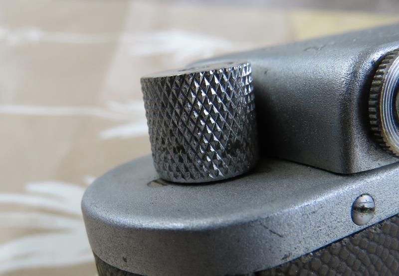

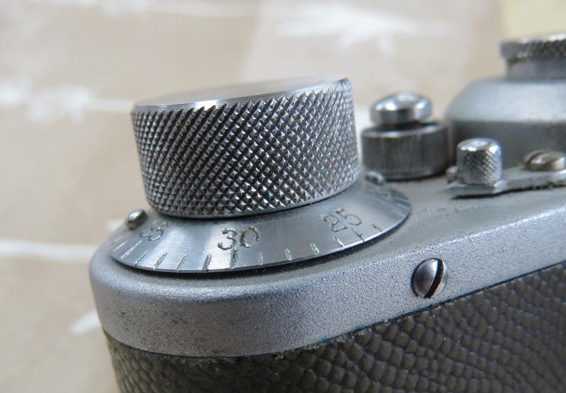

The winding and rewind button are interesting too.
To be short, we have two different millings for these buttons:
- the "fine" on 1a-s and early 1b-s.
- the "coarse" ones.
This s/n 4580 has a "fine" milling for the winding button, and a "coarse" for the rewind one.
http://www.ussrphoto.com/UserContent/422016_IMG_2277.JPG
http://www.ussrphoto.com/UserContent/422016_IMG_2278.JPG
In my collection, the s/n 29840 is the first to have the two buttons with the same "coarse" milling.

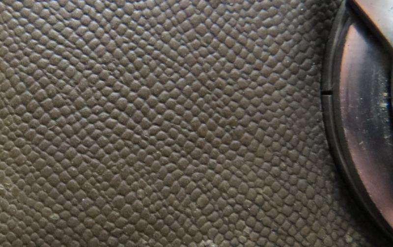

Now about the vulcanite.
This one is brown and patterned. We find it on the regular 13/14xxx to 16xxx 1b series, then on some c 25xxx 1b.
This vulcanite is not very common: a lack of "regular" vulcanite these years?
This doesn't look like vulcanite. To me, vulcanite is a kind of plasticine which dries more and more with the years. If an empty body is pushed, vulcanite can break into pieces. Often missing vulcanite parts can be seen.
The cover on this #4580 seems to be like an one piece leaf. But I could be wrong.
Love the wind knob. Why did they change to a coarser type later and then came back to it for a short time on early Fed-2.
I used the word "vulcanite" because it's the only general one I know and which can be understand by everybody.
Of course, it doesn't look like "leatherette".
And this "skin" doesn't seem vulcanized, though rubberized. It peels off too when drying, but much less than vulcanite. And it is made in one leaf sticked on the body, the joining point being the lens ring.
During these 1933/37 years, the Fed factory changed the vulcanite several times. The 1b served as a laboratory for this question, as for many others. Exciting.
