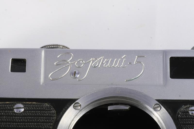

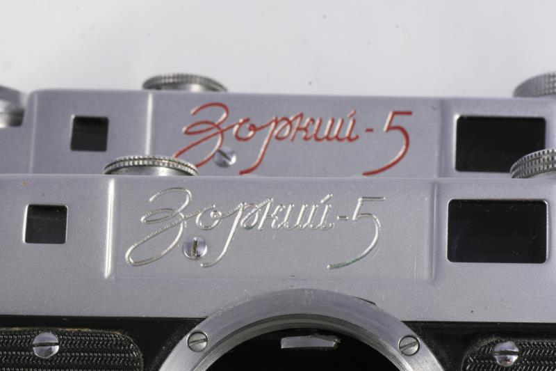

Alexander,
I have the same position for the engraving, the screw is in the middle of the letters, just painted. Also 4 rows.
To disassemble the vulcanite housing the top plate needs to be disassembled first, right?
Lenny,
I think all "red" Zorki-5 have the same rewind button with 4 rows.
