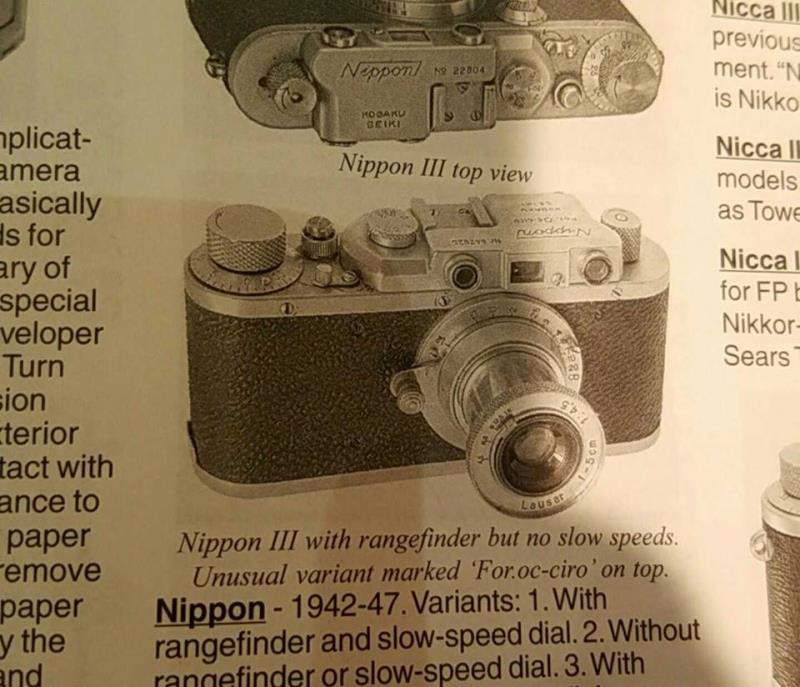

A good fake from FED
Teh lens is the Industar 22 by judging the meter scale the front is redone with a new ring, reengraved andhas a reducer for the neyw aperture.
That is my veredict.

What's even more interesting this exact camera (seems like it) is in the McKeown's 12th edition.
... and I think exact this fact is the reason for this fantastic auction price.

Yes, this is FED 1c, the vulcanite is from postwar Leica. I don't see rewind knob it seems to be from Leica too.
What is the lever (you have to set it at "R" in Leica when you want re rewind a film) from ?
Yes, a late 1c or a 1d (position of the central screw, no pin on the accessory shoe and probably no screw under the rewind button).
The rewind lever comes from a Fed too (with B under it, instead of R on Leicas).
No certitude concerning the mechanism. Probably a Fed's...

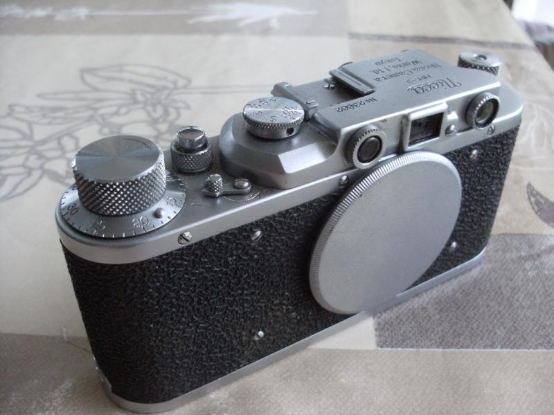

you can offer your camera to Breker's Big smile
Sure I will!Cool But it won't be "covered" by the McKeown...
To be serious, I think that the upper Nicca, on the McKeown page, is certainly genuine: correct cover, good finder window shape, and plausible serial number. By what I know!
On the lower one (which was just bought), a Fed shape for the window, a serial number which is unknown. Above all, a "B" mark under the rewind lever which denotes a Russian product. And other details.
Sorry for the owner, even if I am not a Nicca specialist. Of course, there can be original Nicca parts, in this camera. The lens, for example, cannot be a Fed's. My Nicca-Fed contains original Nicca parts too: cover, rangefinder and baseplate. But I paid 50 times less for it...
