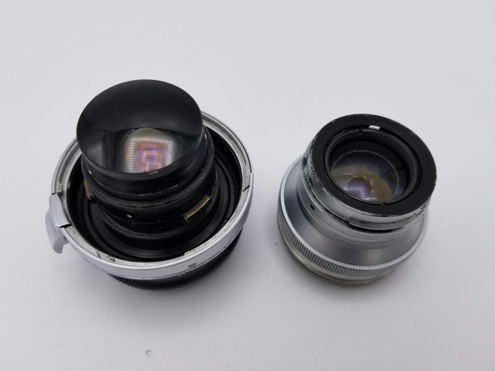

how do we recognize the external and non-external bayonets?
Originally posted by Vlad
Luigi,
Left - external, right - internal.
