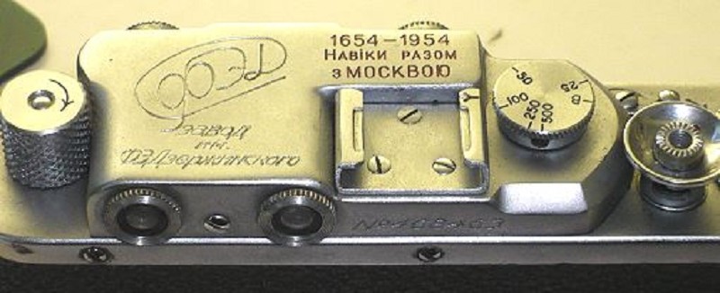

hi friends...
here is a picture from mine...
i am not sure it is an original ...(too much differences in engraved grooves between "fed zavod etc..." and " 1654-1954...etc"
serial number is : 468463
Hello Alain,
Thanks for the picture.
As for me, I don't see anything wrong with your camera.
The grooves are not the same, for sure, between the coloured and the non coloured lines. But it's the case for all the "anniversaries".
And the serial number is two unities from the DVD collection one...
You don't want to put it in the Wiki?
Hi Alain,
Looks authentic to me. All of them (fake or real) have the big difference between these engravings. I think the commemorative engraving was done with a different tool (wider, so the red enamel would look good)or maybe because it is in block letters it looks wider.
In the fakes I have seen, I am pretty sure that the first letter on the bottom line (looks like a "3") was placed further apart from the "M" in Moscow.
