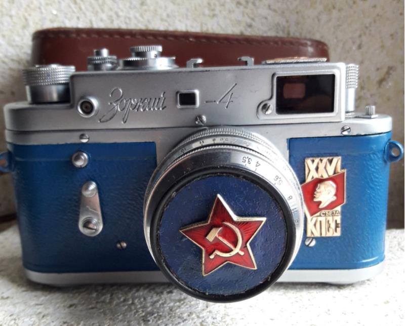

Hi there. I'm not a professional photograph, so my knowledge is quite basic. I am looking to purchase (what I guess is a modified) Zorki S or 4...images attached. I want to use this for taking photos. The site that is selling them seems to be selling them more for "cool" factor than function. They are coming from the USSR. I have asked the owners if they work and they say they are functional but have not tested recently because film is expensive and or hard to get.
So I am not sure about purchasing from this site, even though they cameras are 50-60USD. I am wondering if anyone could give advice as to where I could find these types of cameras, that are funcional, at around the same price. Thank you!

Personally I would steer clear of these modified cameras. It's not impossible you'll get one that's fine, but they look like they're made more for display and likely to be made from cameras that would otherwise not be saleable.

For the proposed Mickey Mouse camera my advice would be to look on eBay for a newly CLAed Zorki-6 or Zorki-4K. (CLA stands for cleaned, lubricated and adjusted AFAIK).
