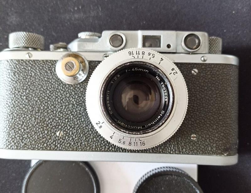

About the lens, that's another chapter! I bought the camera with a Steinlein Cassarit made for the Braun Paxette: M39 too, but with a register of 44mm...
So, things are open. A genuine Industar 22 or Elmar? A fake Elmar, to keep the original idea? For the moment, I don't know. If you have other ideas...

An early fake Industar would be best IMO...
Congrats for this beautiful find. Did they adapt the Paxette lens to the Leica register and if yes, how did they do it? Or does this lens just not focus ?

With such a lens, it would be necessary to put a bag of 44 - 28,8 = 15,2mm to have an image through the entire range. I tried with 14,7mm (I cannot do better) on my Sony, and it works, at least at middle distances.
Impossible to try with an early M39 Zenit: the lens is protruding and the mirror could hurt it...

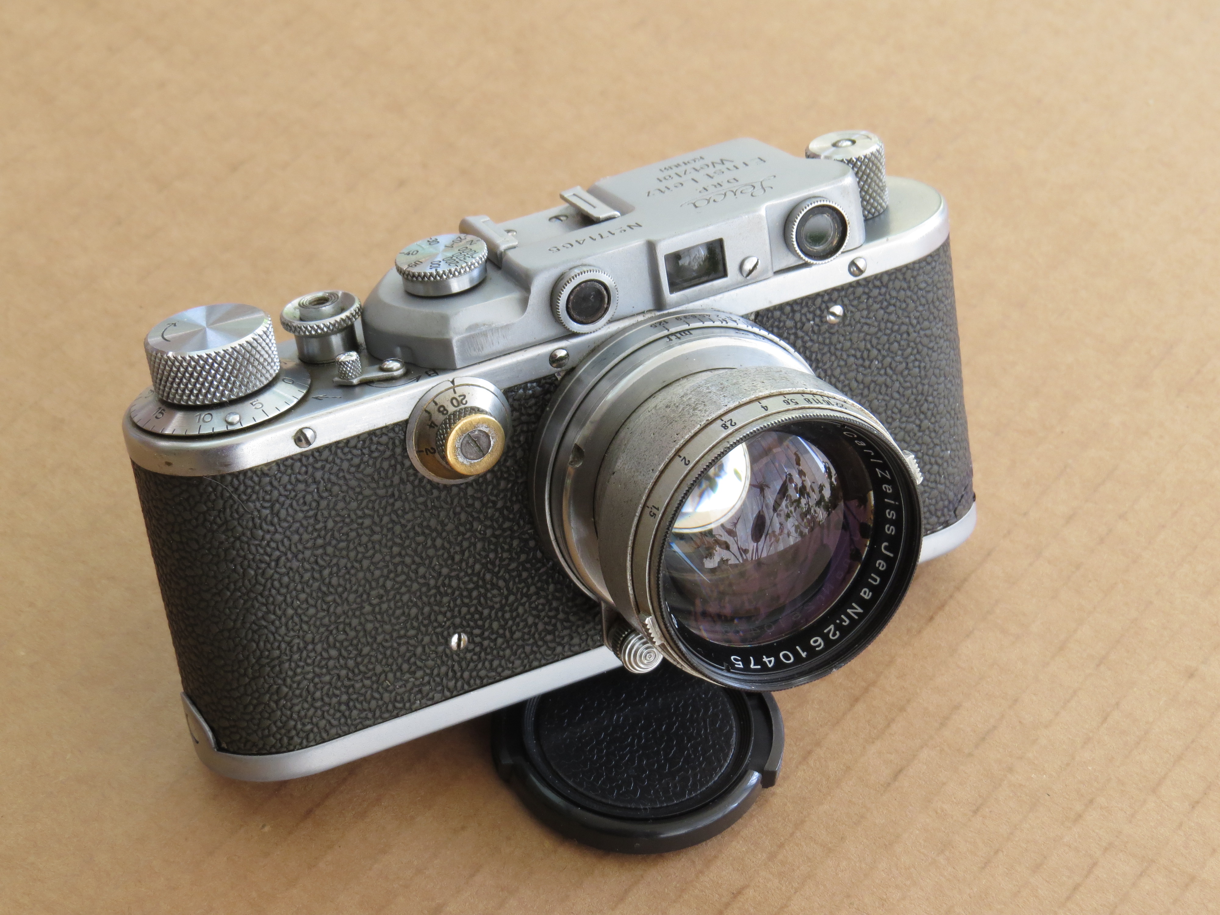

2673 Posts
Posted - May 27 2023 :  07:48:10 AM  Show Profile  Reply with Quote
Finally, after changing the lensplate, that will be a 1939 Sonnar 1,5/5cm, in a mount of prewar Summar and adapted by a craftsman, once more!
http://www.ussrphoto.com/UserContent2/2752023_IMG_1152.JPG
All that looks good (to my taste...)
