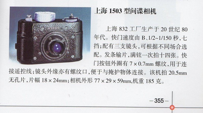

Dear friends
Some informations about a copy of the russian F-21 spy camera from China are to be found on the internet [1]. The identification of this camera seems to be "1503".
It looks on the first view like a modified copy with an other time setting mechanism and also other speeds (1/2, 1/5, 1/30, 1/60 and 1/150 on the copy and 1/10, 1/30 and 1/100 on the original F-21 from Russia). Also the window for the picture counter is not round like on the original F-21, but rectangular. The front plate has no roundet corners and the overall form of the body looks a little other than the body of the original spy camera F-21. Even the dimentions are similar, but the chinese variant is a little higher.
It's a very interesting variant of the russian F-21 I think. But according to an other documentation [2] there also exist other spy cameras from China with the identification "1501", "1502" and "1504". I have absolutly no idea what kind of cameras this could be.
Do anyone of you have any further informations on this cameras (1501 to 1504)? I'm also looking for a picture of one of these cameras for publication in my documentation on the F-21 (sorry, still in german only ...) [3].
By the way: Now a original russian user manual [4] and a translation in german [5] is available on my site.
Any advice on this topic would be very welcome! Thank you in advance.
Picture:
http://www.g-st.ch/temp/f21china.jpg

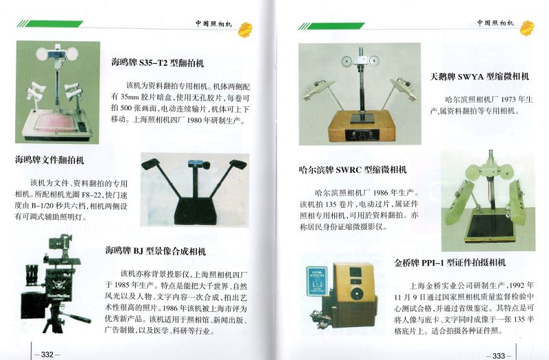

just for info :
Chineses "yolocka" copy devices...
it seemed that on the middle left page very close to soviet ylochka...
Hello Alain
You own a very interesting book as I can see ... ;-) - Only the camera looks a little different than the one used on the russian variant.
Thank you very much for showing this picture!
it is a rare "private" edition book (blue cover)...300 pages about Chinese cameras ...many models are unknown currently (something like Viktor 's bible about Soviets !)
It is a pity I do not read Chineses characters DisapproveDisapproveDisapprove

Thanks to Detlev who knows someone that talks chinese I could make a translation of the page of special cameras that you showed us two days ago:
"Shanghai type 1501
Produced in factory 832, this camera is used for research and observation. It can be used under particular circumstances.
Seagull type 120 variant
Member of the type 1502 special camera group. Produced in factory 2, this special camera is used for taking portrait pictures.
Shanghei type 1503
This spy camera was produced in the 1980s in factory 832. Form 1/2 to 1/150 seconds there are 7 exposure times available. There are three lenses available for changing at different situations. The camera use a clockwork motor for film transportation and can take 14 pictures at the time. It uses a 7x0.7mm screw thread on the shutter release buttom for adapting a cable release. An unperforated film of 20.5mm width is used, the picture size is 18x24mm. The camera size is 77x29x59mm, the weight is 185g."
The 1502 seems to be a modified Seagull 4, a copy of the german Rolleiflex made in China from the 1970s on.
