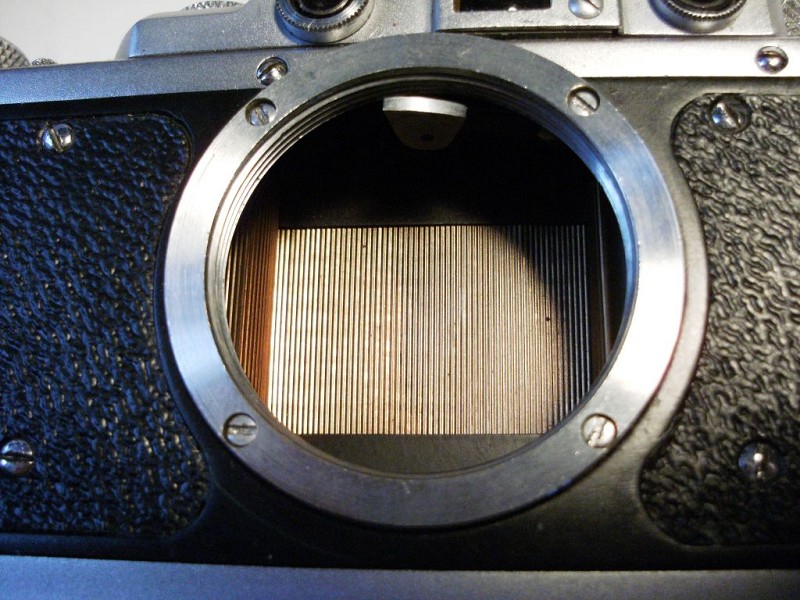

I have just bought a Zorki 1.
Certainly some of you saw it on eBay: a curious one, as it has metallic shutters (like the Kiev 80, but horizontal translation) and strap lugs: all that is unknown on these cameras.
A 1d, as it seems: the stripes are around the lens too. Serial number: 376696. Certainly a very early 1d.
If you have any idea... It looks like the Zorki 1S in Nathan's site; but that one doesn't have metallic shutters!
Pictures as soon as it arrives. Eager to receive it and to try to take photos with it!

In fact , I have a DIY metal shutter curtain Zorki-1. I did the job with metal curtains I saved from a broken Kiev 88.

Yes, it works, and seems reliable. :) But the accuracy of speed is questionable. I feel that the metal curtains can't reach 1/1000s or even 1/500s speed.I did it for fun.so that I did not test it seriously.
Zhang
I guess the question begs - the metal curtains are usually much thicker - is there enough space on the curtain spool to accommodate for those? Also they do not get stuck on the curtain rails? ...and pictures please, anyone if you have those!
I think too that metallic curtains are heavier, so the speeds are certainly slower. Did you already take photos with your special Zorki 1, Zhang?
I agree with Vlad: it's certainly a real job to change the curtains and to accommodate the entire mechanism.

Sorry, I thought Vlad asked for your cameras photos. I can take an image of mine for sure. The metal curtains don't look like thicker, heavyier maybe.

Some weeks ago, I had promised to post a picture of my "curiuos" Zorki 1.
In fact, it is no more curious as Zhang's one: the shutters seem to be exactly the same. As for me, it's the first time I see such shutters. Congrats once more to Zhang who made it by himself...
It seems to work without problem, with a noise possibly a bit louder for the slow speeds. I didn't check the accuracy of speeds, but it seems there is no real difference between this one and a plain one.

Many thanks for your image of the curious Zorki. It is quite possible that the owner leant the trick from me as I made mine many years ago. Big smileI also tried to oversome the shortcomings of a Zorki-1 with a Z-2C's body case with strap lugs, and a bigger winding nob, etc...and the Seagull is actually a Zorki-6 with a Seagull name-plate.Wink Lens shade of a Seagull-4 TLR rest well on a I-50 or I-22.It is much fun to mod a Soviet camera to my satisfaction.Cool
