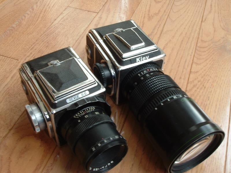

I need your help and comments to identify this unusual variation of Salut.
I believe I read about it some time ago, but can not find any info now.
I have seen this camera sold at Bievres last summer by our friend Oleksandr Braslavsky. I believe Alain bought it? Smile. It's a made for Germany export from what I understand.
Vlad does that camera also had that crazy ring on the front and can use only Kiev 6 lenses?
No honestly I don't remember seeing that ring.. Aidas was playing with it too maybe he remembers.. I'm fairly sure Alain bought it so maybe he can comment. It seems like that ring is a modification.. very interesting.

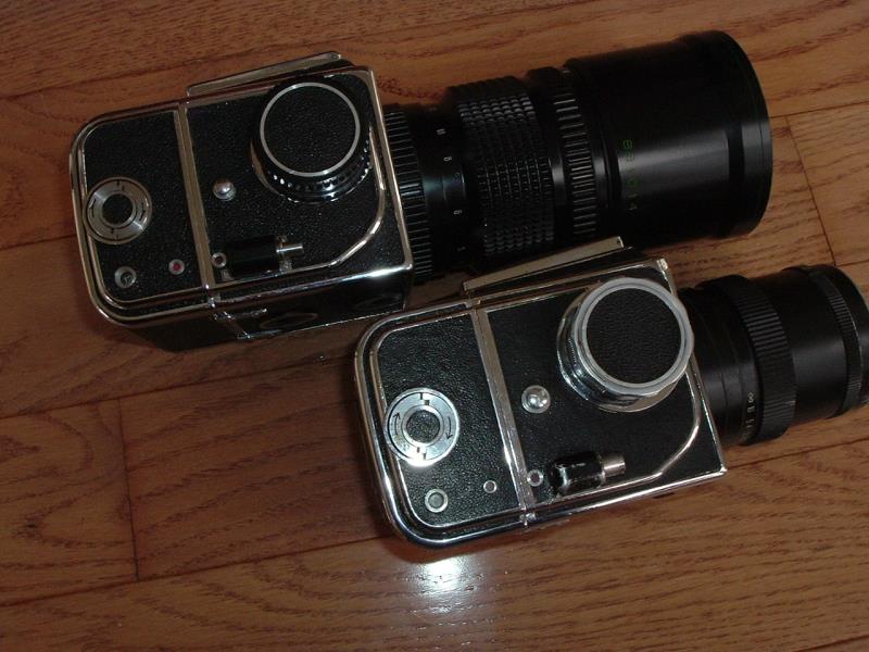

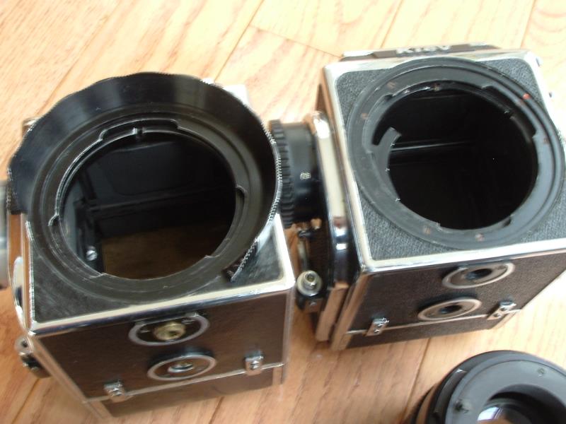

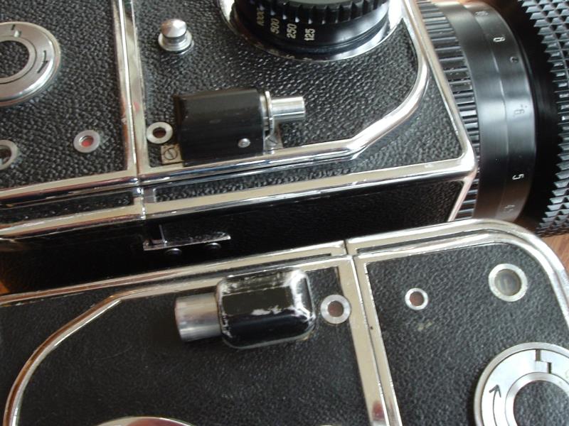

This ring is part of the camera. It is a lock for the lens. You put lens in and turn ring to lock it. Camera used Kiev 6 lenses. It can not use Salut lenses. Shatter button (picture 3) on the side, not on the front. The automatic aperture mechanics is totally different then on Salut:

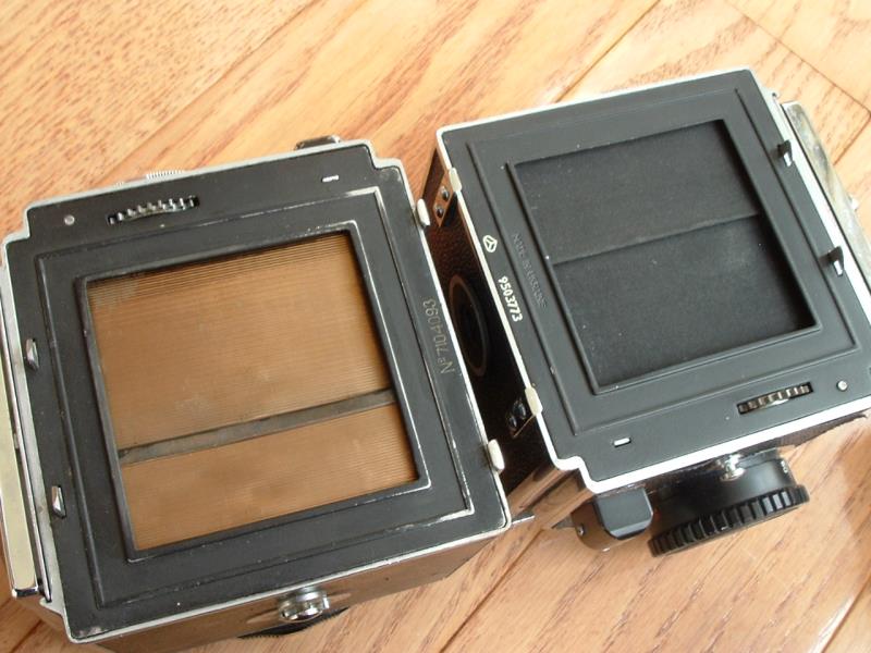

s/n of the camera 7104093
I'm returning to my old post because I just got another camera of this kind, now it seems to be Kiev 88 with same kind of modifications:

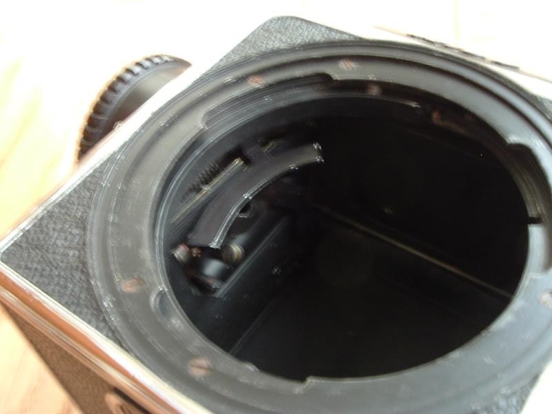

The lens mount is for Pentacon-6/ Kiev-6 lenses, camera new aperture control to accommodate these lenses, different shatter button, and probably more modification inside. There are some pictures of both cameras:
By serial numbers first cameras made in 1971, and second in 1995, so this modified cameras was produced for at list 24 years. First camera came from FSU strangely with Revie name, second from US seller. IMHO this is not "kitchen table" modification, the craftsmanship and material show professional work, and factory equipment involved. I could not find any references about such modifications in the books or on the Web. May be I missed something. I wonder is someone else has cameras like this, or know anything about them.

If you compare these 2 cameras with original Saluts or Kievs you can see that mechanical modifications IMHO significant enough. The lens mount rebuilt, the aperture control is redesigned, the shatter button moved from the front of the cameras to the side, which may tell about changes in chatter design. None of the cameras in the catalogs what accessible to me have any references to such modifications. And yet hard to believe that I found the only 2 cameras like this in existence. Something telling me that more cameras with such modification should exist. I do not think that these cameras are prototypes, nothing IMHO pointing to the prototypes. So who can made such changes, why they was made, where they was made. If we can find one more camera like this it would more definitely tell about some production run, until then we can only stated that exist 2 cameras with similar modifications made most likely by some factory( not necessary by Arsenal) .
