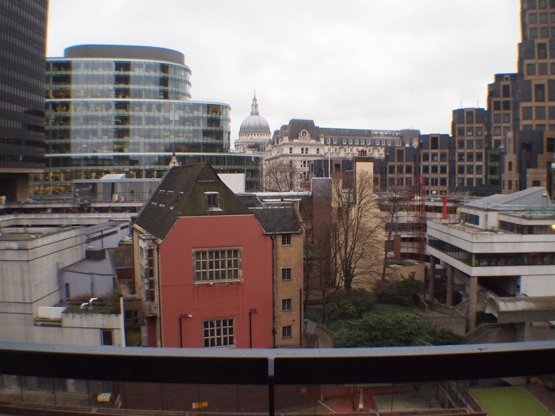

I've constructed the Micro 4/3 adapter for the Opalar. Here's the first picture using it, taken wide open at f3.5:
As you can see the image has some faults: resolution falls off pretty noticeably towards the edge, there's obvious chromatic aberration and there's distortion. Nonetheless, it seems to portray colours pretty well even though the really light was as poor as it looks - after all, this was London on a January afternoon. Things would probably look better stopped down and with the shims slightly adjusted, but I don't think the faults will completely go away.
The lens lacks a focussing ring, but (at least on this example) the barrel can be rotated slightly to move the elements away from the sensor. About 1/4 of a turn is all that is needed between sharpness at infinity and at 1 metre.
Of course this is misusing the lens: it was designed for underwater photography so none of these faults might be so obvious in that context. But it's a shame to have a lens and not use it.
