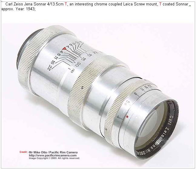

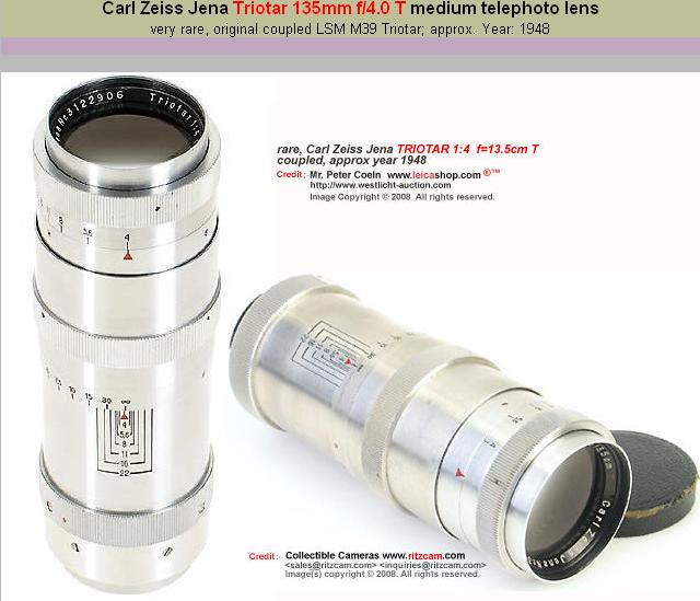

For those who does not know: Zeiss 135mm
Triotar M39:
Sonnar M39 (any similarities?)
