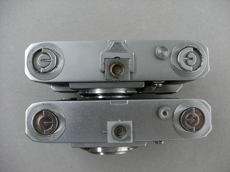

First, a general view of the tops of the two cameras.
Two light differences:
- the meter scale is not exactly the same,
- there is a reinforced stamped spot round the counter on the Contax.
The other interesting details are the same: arrow with feather, moulding of the lightmeter window, buttons, groove on the distance wheel...

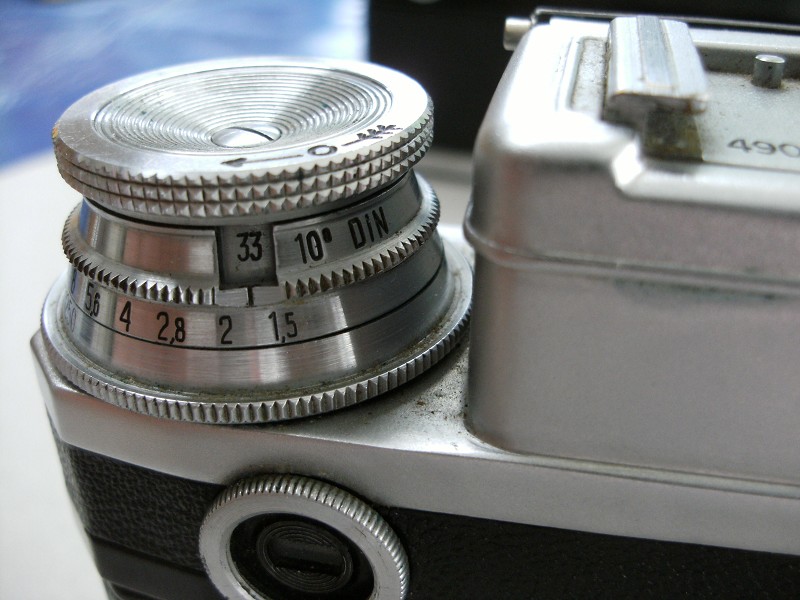

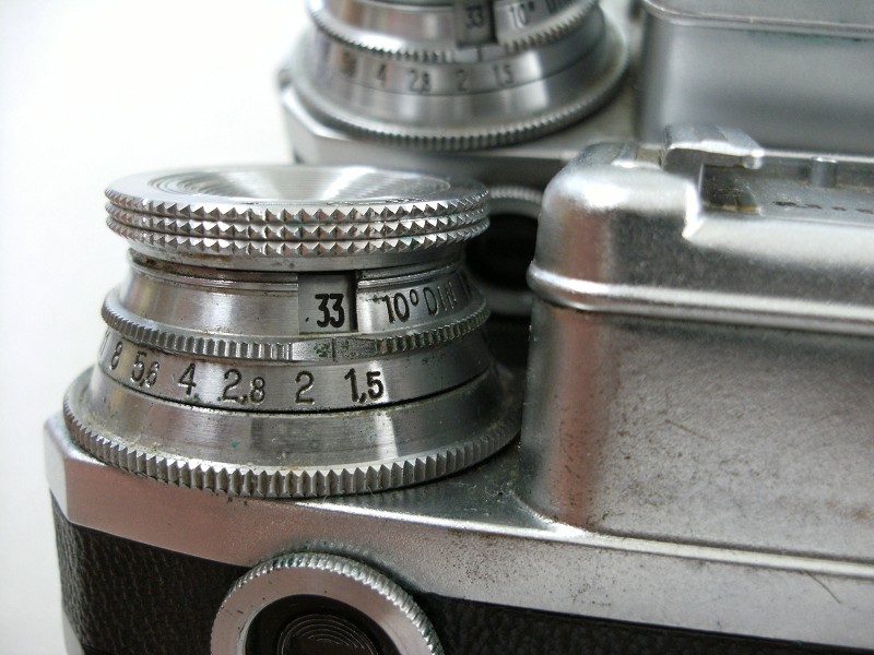

Then two others pictures of the "tower" like button, which includes the rewinding, the sensibility of the film and the regulation of the couple speed/diaphragm. So, three in one!
The Contax is the first (= higher).
Absolutely no difference.
It is interesting to know that this sensibility (9-33 10° DIN) was used only from the last M series Contax, so 1942. So, the lightmeter of the 1949 Kiev certainly comes from Dresden parts. Anyway, it was not made at Kiev!
As for the "3" with flat top, it comes from Dresden too. My 1958 KuďB III has round 3s on that button.

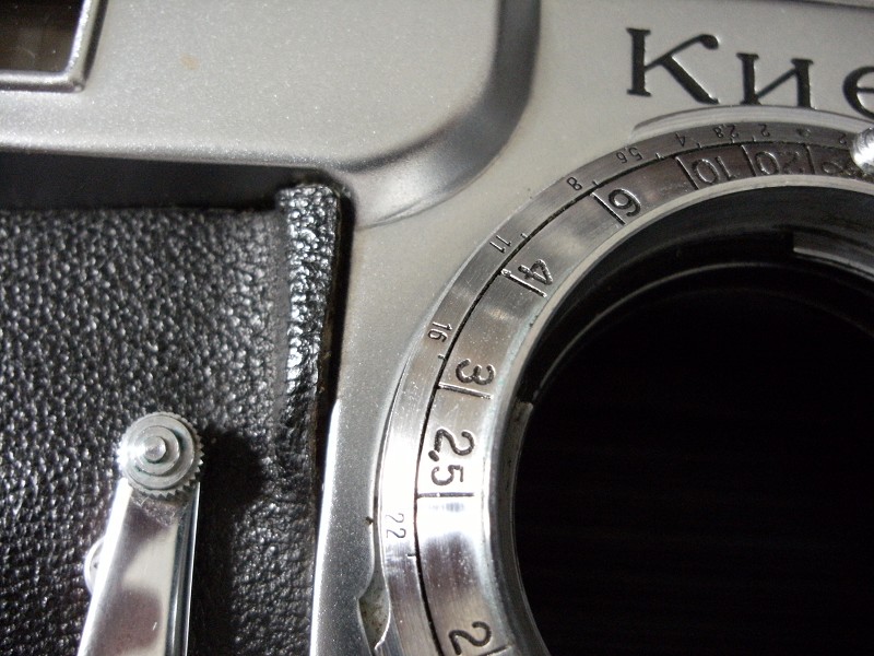

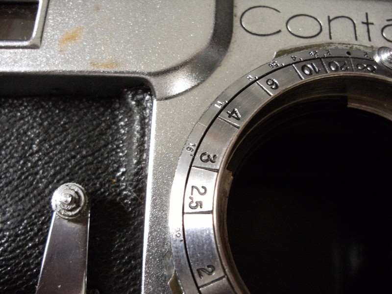

Round top 3s for the Kiev on the counter and distance lens plate (pictures below).

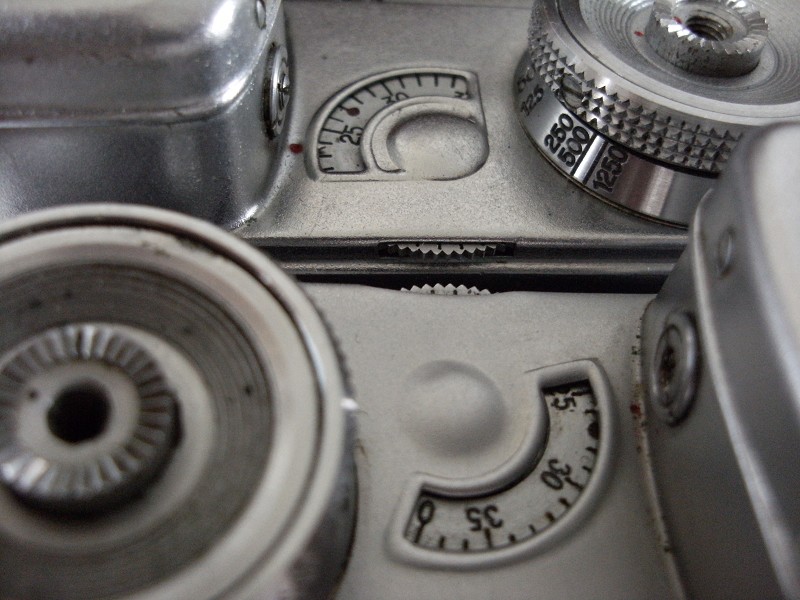

Very last thing: the stamped spot round the counter (on the Contax 3).
A very interesting question, as this reinforcement exists on Contax III only. Not on Contax II, Jena Contaxes, Kievs...
That means that the top plate of this 1949 Kiev III cannot have been made at Dresden.
So, the meter and the tower like button only seem coming from Dresden. All the rest of the camera can have been made at Jena, or perhaps at Kiev. Impossible to be more precise, as the two "pure" Jena details (black circle under selftimer, number of circles on the square part of the shoe) are absent here. And we don't have any Jena Contax III to compare...Sad
