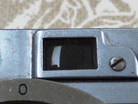

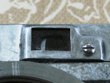

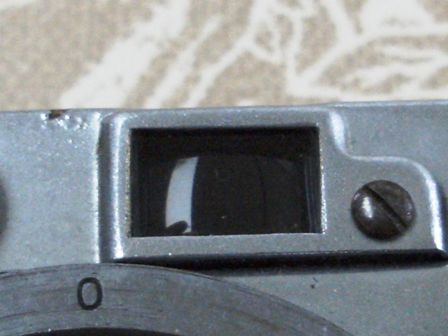

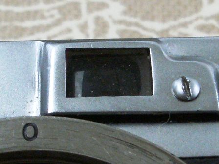

First, the rectangular window, the "scale" window.
From the top: 1933 Leica F (IIIa), 1932 Leica D (II), 1935 Fed 1a # 5330, 1935 Fed 1a # 4642 (the one in question).
We can see that the metallurgy of the Leicas is different: the corners are neater and more square.
As for the measurements, in millimeters (glass only):
- 10x6,5 (Leica IIIa),
- 9,5x6 (Leica II),
- 9x6 (the two 1a-s).
By the metallurgy and these measurements, I think that the cover of this 1a # 4642 is really a Fed one.

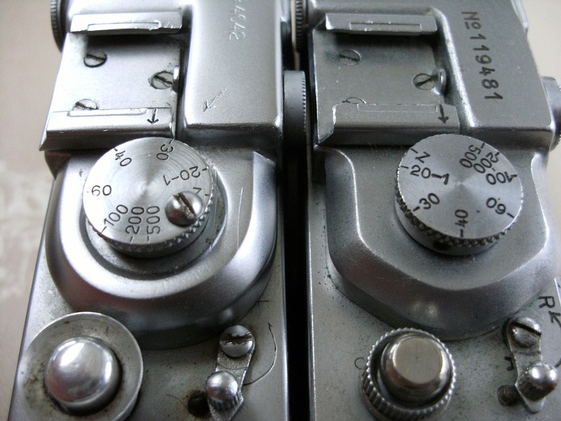

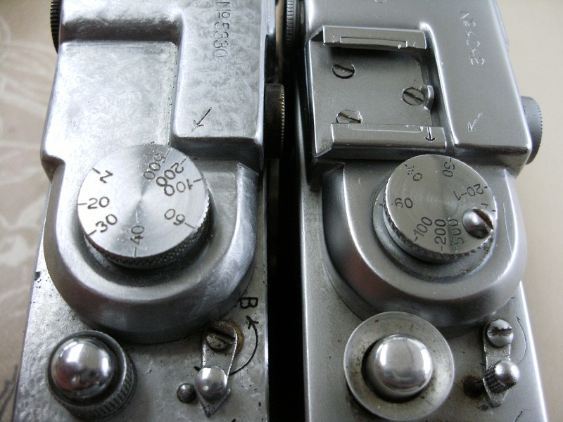

Now, about that famous speed dial.
On this first picture, the dials of the IIIa and of the Fed 1a (#4642) with its screw. The diameters are exactly the same (13mm).
Here, you have the dials of the 1a # 5330 with the 1a # 4642. That time, the diameters are different: 15mm for the 1a (like any original 1932 Leica II). But later Leicas II will have a 13mm dial too, because of standardization of the production with the IIIa.
So, I think that the speed dial comes from a Leica model F (or IIIa), or a later Leica II (from 1934, if I remember).
