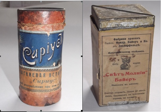

In 1887 Adolf Myth and Johan Gedik used a mixture of magnesium with õëîðàòîì potassium. So was invented «flash powder» (or «flash powder» or «blitzlicht») and entered the lexicon of magnesium flash, which we believe companion format camera.
(picture 1)
Ðóññêèå ìàãíèåâûå ïîðîøêè «Ñèðèóñ» è «Ñâåò Ìîëíèè» («Ôàáðèêà êðàñîê Ôðèäðèõ Áàéåð è Êî»)
Russian magnesium powders «Sirius» and «the Light of the Lightning» («Factory of paints Friedrich Bayer & Co»)
