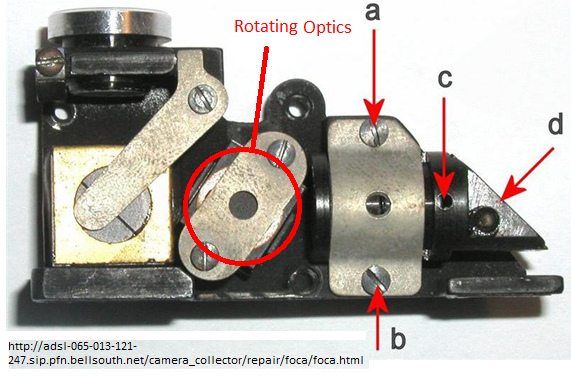

The Foca was pioneer in another type of rangefinder developed for the Marine Nationelle where the internal optics pivoted vertially in the second axis.
The foca rangefinder
