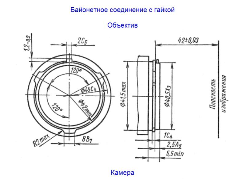

The register of the Start is 42mm, if I read correctly your scheme, Luiz.
The Praktina's is 50mm. Not the same, hence my error.
Of course, it is impossible to mount a 39mm SLR lens (45,46mm register) on a Praktina (or at least to focus at infinity). No impossibility on a Start with the proper adapter. Fedka's one, for example...

I have made my share of mistakes, so I wanted to make sure this time and arranged to meet my fellow forum member Ziga. He offered to lend his Praktina lens to mount them to Start, to make sure. Now we don't even need to do that since Luiz made a brilliant clear case.

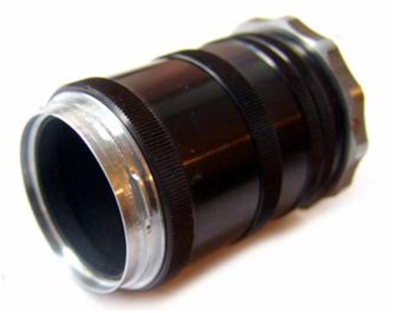

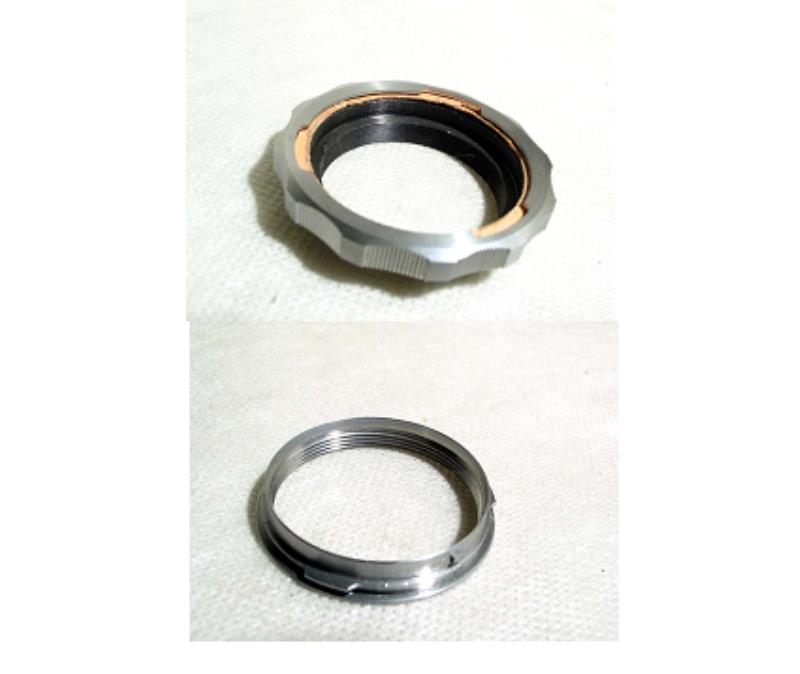

I have some accessories for the Start- a waist level finder and macro extension tubes, but I don't have the adapter. The one on Yuriy's (Fedka) site looks like a short macro extension, not an adapter. The thin ring on the second link Luiz provided is obviously what I need. I have never seen it before, even on a photo.
So I should be on the lookout for it. Maybe write an e-mail to Rafael at rafcamera...
