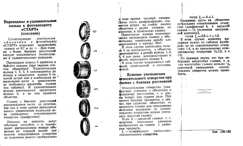

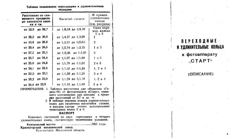

Here is a copy of the instruction leaflet:-
David.
Ok people read "Perehodnye i Udlinitel'nyie Koltsa"
or "Transference and Extension Rings" for Start Photocameras
of course Transference +to accept M39 thread.
the ring 5 makes Start câmera accept Zenit M39 lenses
